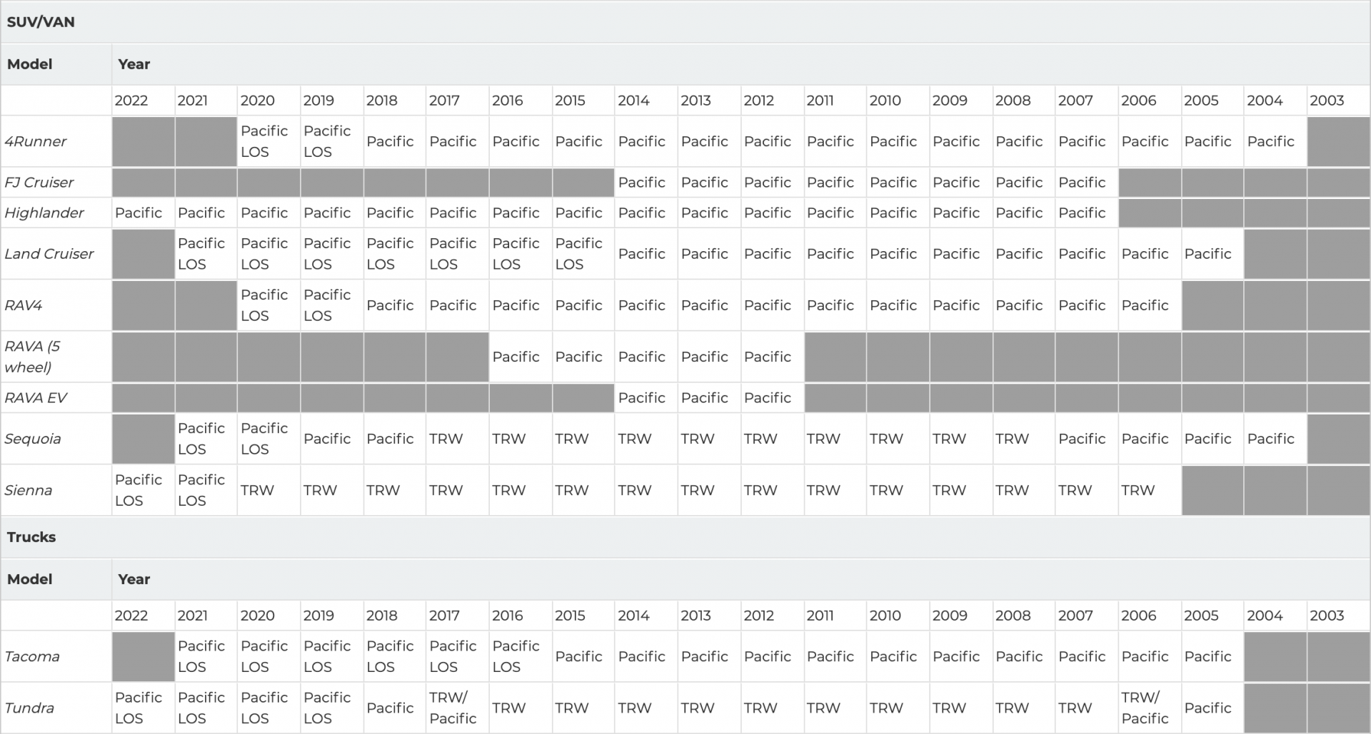

According to this Toyota TPMS | Toyota TPMS Tools | Tire Pressure Monitoring Systems | Bartec USA LLC - https://www.toyotatpms.com/, 2021 tundra use similar TPMS as 2015 LC.
If you have a TPMS scanner handy and techstream, you might be able to reprogram the TPMS.
Note : I do have problem programming TRW sensor on my 2013 LC (use pacific TPMS). Also have 2010 sequoia which use TRW sensor. Bought a set RW wheel off tundra owner which also use (TRW sensor).

There are multiple models of pacific TPMS transmitters, even in the 200-series production run. I’d compare toyota part numbers to the tundra before going to the effort of programming anything.

The Autel can read and store all sensor read. Then, use the learned TPMS ID and reprogram back via OBD2. Pretty handy tool. It’s best to use Autel universal TPMS sensor, so it can clone the sensor ID to the universal TPMS.
I have had them both in hand, and they aren’t even made by the same manufacturer. I have a set of four from a 2017 Tundra cheap if anyone needs them.
