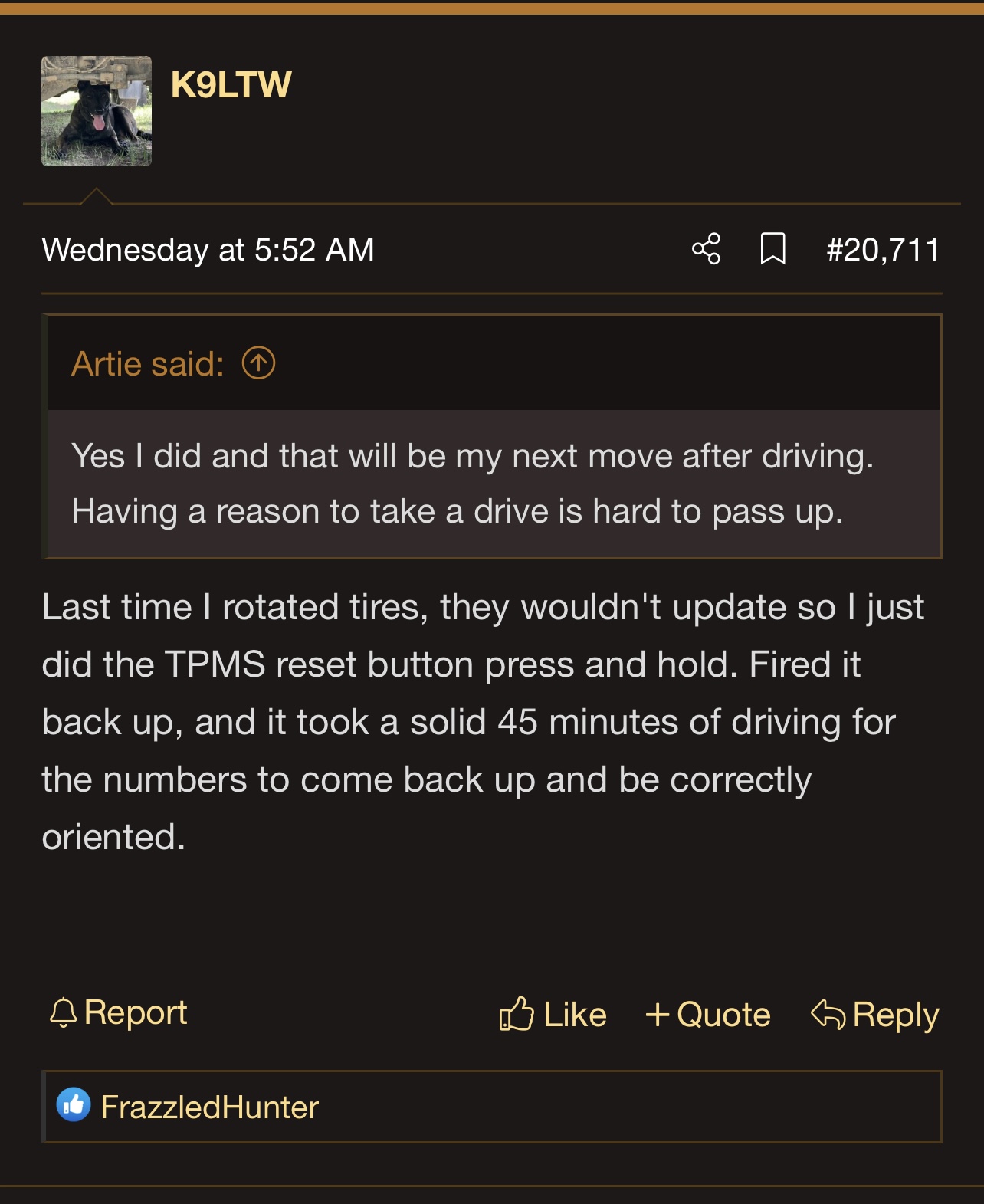

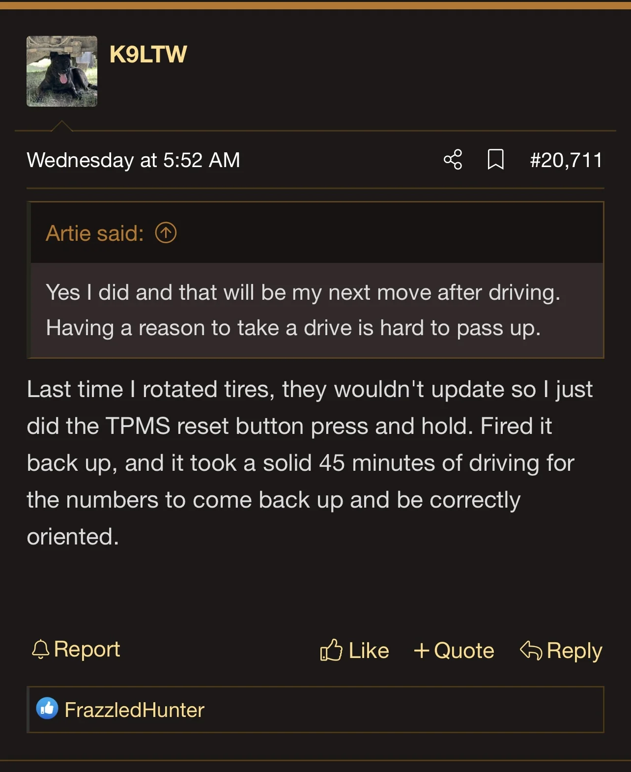

Yeah, that’s strange. This is quite timely as this behavior was just discussed the other day on the “what did you do” pinned thread when I was asking about mine not orienting correctly. See this post and a different thread on the referenced TPMS button.
