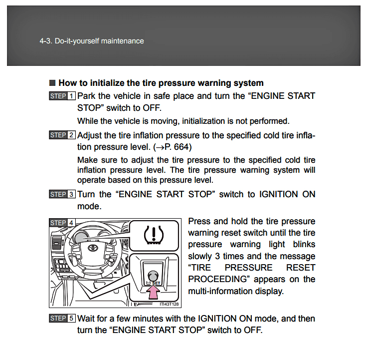

You did something wrong ... hey, happens to all of us.
If you want your system to alarm @18psi, set all your tire pressures to 24psi - for this purpose this will be your "specified cold tire inflation pressure level" - and then follow this procedure to reset (initialize) your TPMS:
After you have successfully performed the initialization, be sure to set your tires to the correct recommended cold tire inflation pressure. No matter what you set your tires to after doing the initialization, as long as it is greater than 18psi, the system will not alarm alarm until the pressure reaches 18psi.
HTH

If your LC200 has stock tires (P285/60R18), then you should set all to 33psi, not 32psi - but that probably won't affect your ability to reset the TPMS.
Did you follow this procedure exactly?
Note that Ignition ON mode is NOT the same as Ignition ACC mode. To turn ignition on, you must keep your foot off the brake pedal with the transmission in Park and press the ignition button twice - once to enter ACC mode and then a second time to turn ignition ON.
HTH
HTH
Thanks, yes I did.
