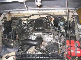

Hello,
I'm getting all the parts and pieces together to install a Toyota V-8 in my 1962 FJ40 I have everything I need, BUT not sure on which way to go as far as Trannys.... Has anybody used Castlemains (Rod Shop) or Dellows adapters or bellhousings ?? I have a T-400 trans I could use but it would make for a long drivetrain in a 40 :eek: Anyway whats your thoughts guys.
