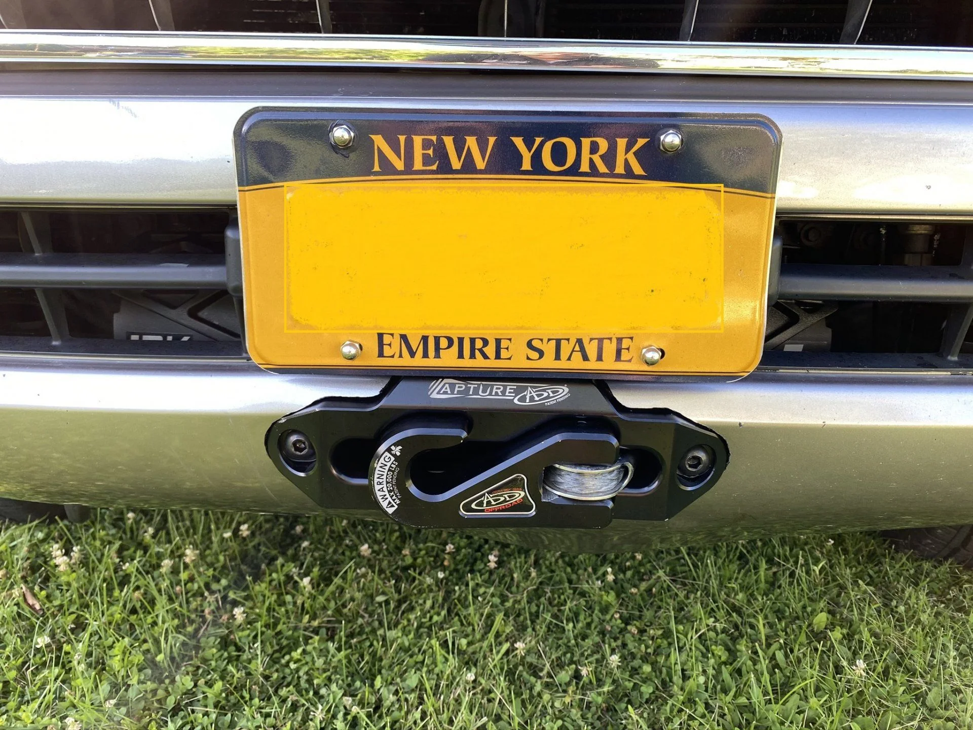

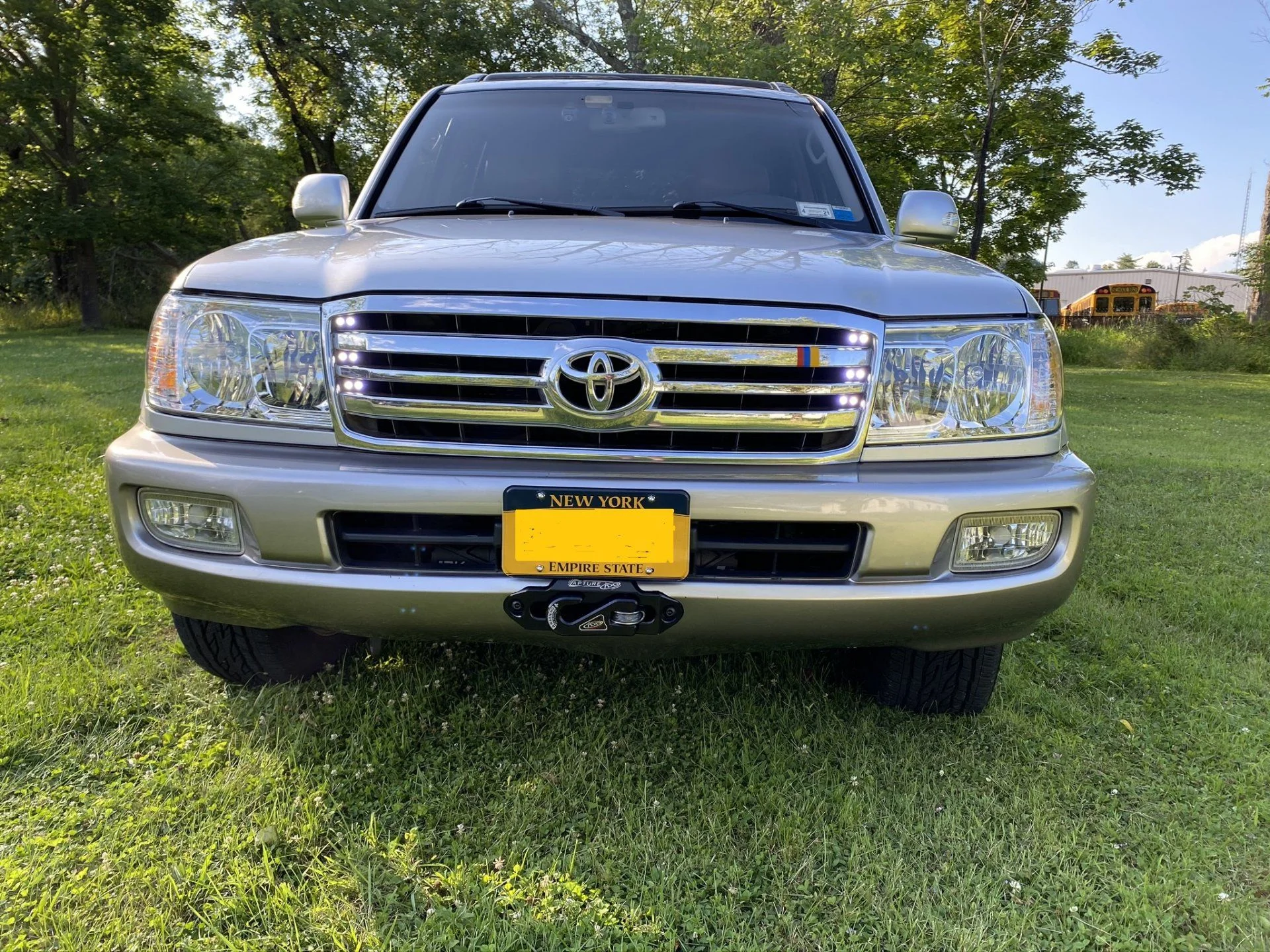

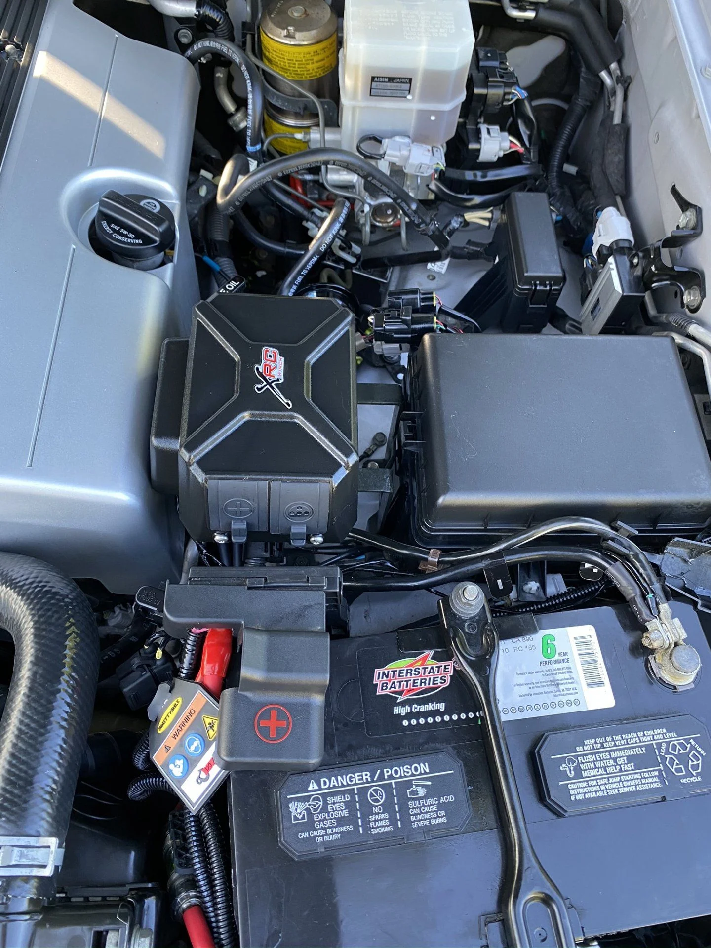

This is a 12000 Winch SMITTYBILT XRC GEN3 12K COMP SERIES install on a 2007 Toyota Land cruiser 100
Very clean!
A+++ for the wiring!

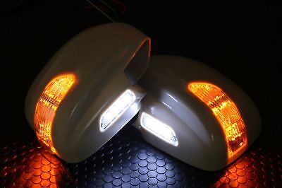

That's a stealthy install. Tell us more about this car! Looks slightly different than a normal US market 07. Chrome grill, blinkers in the mirrors... Some custom work or foreign market parts?
The Chrome grill its OEM I just added DRL on the grill this is what I've used
and for the mirrors, I bought this ones on ebay and got them painted

Is that fairlead actually attached to the winch frame or is it just bolted into the bumper fascia?
Nevermind. Your cutout is so clean I had a hard time telling that it was actually recessed. Nice Job.
FYI, that winch mount is only rated to 9500#.
Good catch. While there will be a 'safety factor' built in.....I wouldn't ever 'double line' the winch and make a heavy pull.

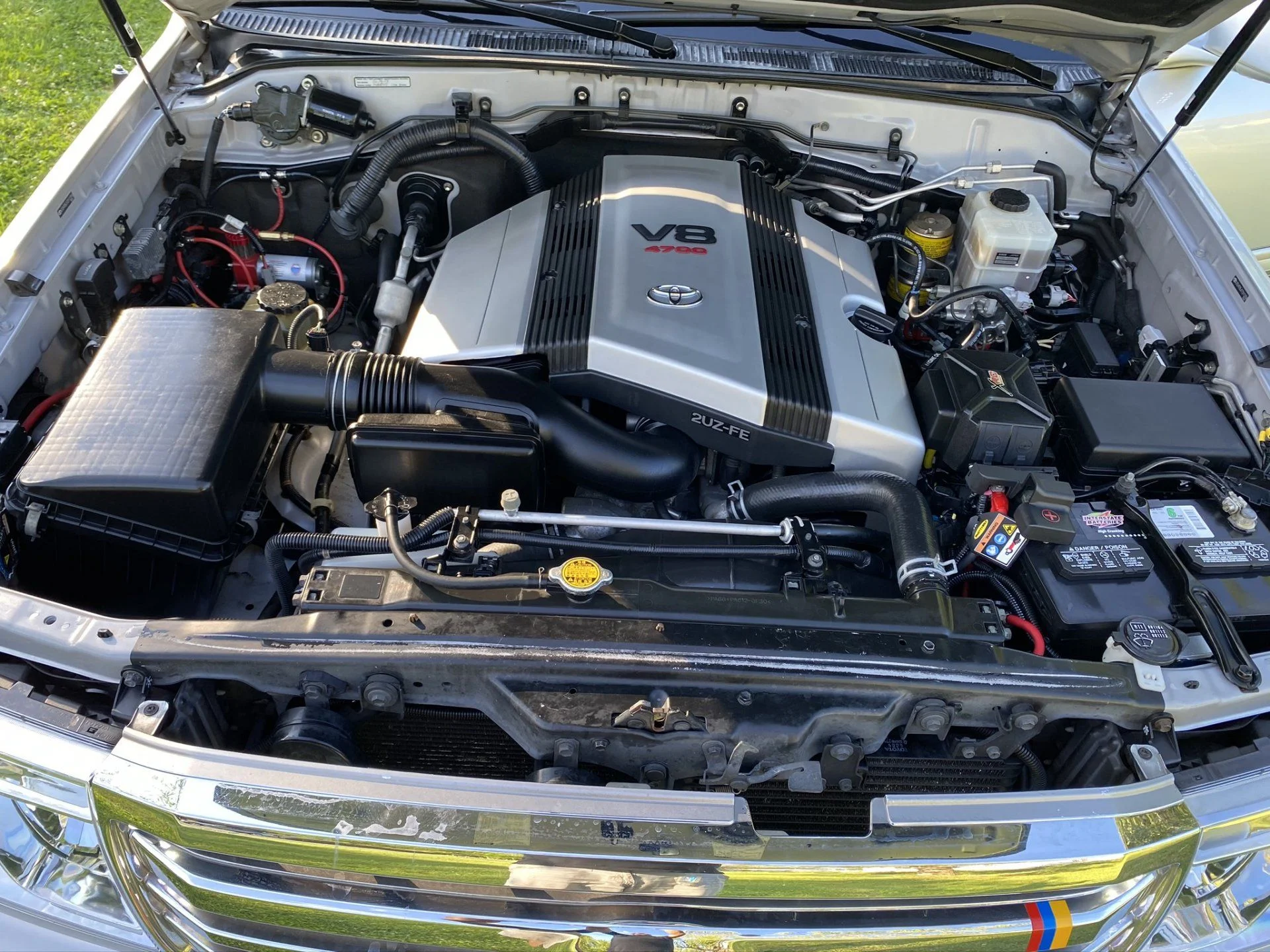

Exactly. But damn the install is clean. Plus the engine bay and everything in there.
I'd love to know what you do to get the engine that clean. I have residual (I hope) oil from a leak that I'm burning off slowing and would love to be able to get to that level of clean to know for sure it's stopped.
