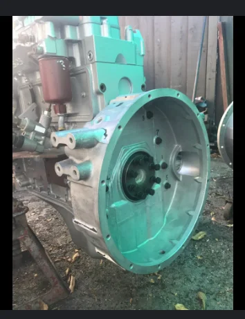

I’m currently working on a DIY project where I plan to build a 30kW natural gas generator using a Toyota 2F engine. To achieve this, I need to couple the engine with a Stamford-type alternator. Could anyone with experience rebuilding or modifying these engines guide me on which SAE-size bell housing will fit the 2F engine exactly?

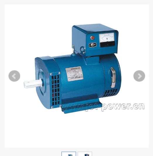

The alternator I have is a 3-phase unit, but I plan to reconfigure it to single-phase. However, I'm currently stuck with the bell housing issue.
I’ve attached a picture of the double-bearing alternator—I’ll need to be very precise with its alignment, especially because of the added load. Any suggestions for aligning it properly with the engine and ensuring it’s stable would be greatly appreciated!

I would think you could get some sort of keyed rubber isolated power coupling to fit between your generator and a gutted transmission (hi gear in 3 and 4 sp is straight threw 1-1 I think). These units easily can accommodate 1 degree alignment error.

Regarding the rubber-isolated coupling, I came across the Lovejoy coupling, which has a rubber insert between the teeth of the coupling—one side connects to the alternator, and the other to the engine. But that's not exactly what I’m looking for. I’d like a coupling setup similar to how Cummins original gensets are coupled, which is why I was asking earlier about the SAE flywheel housing fitting.

The closest thing you will find that will
bolt to a 2F is a 3-speed bellhousing. They have the same transmission pattern as GM.
The 3-speed/1F flywheel is substantially heavier as well and will bolt to 2F.

I need to determine the correct bell housing pattern to match it with an available SAE flange size (#2, #3, #4, or #5). From my research, SAE #3 or #4 seem to be the most common for medium-sized industrial engines, but I’m unsure which one would be the best fit.
Has anyone here worked with a similar setup or knows the exact SAE flange size that would match the Toyota 2F? Any guidance or recommendations would be greatly appreciated!
