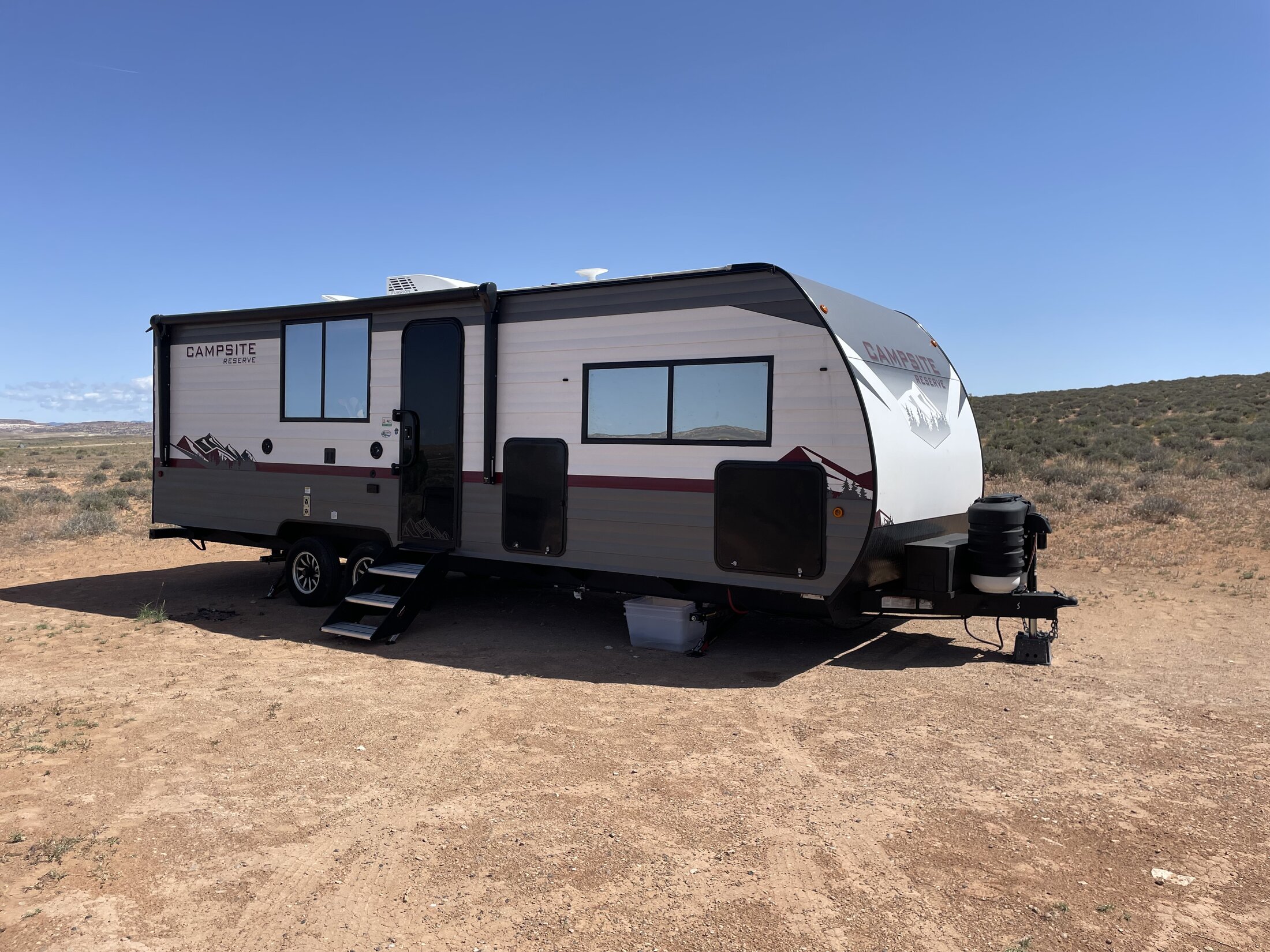

I am wanting to tow this:
2024 Forest River Campsite Reserve
24' long
Dry weight around #6500----aka heavy for an LX

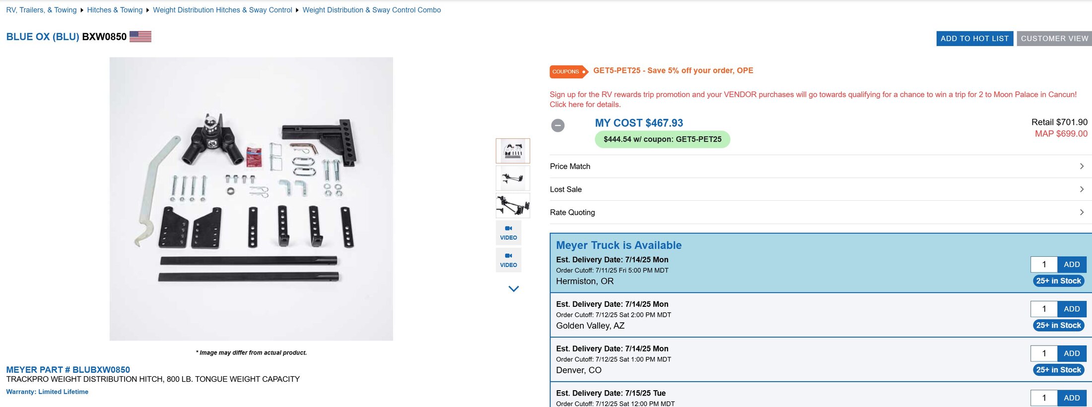

I am looking to get this WD hitch:
View attachment 3946916With the #800 tongue weight

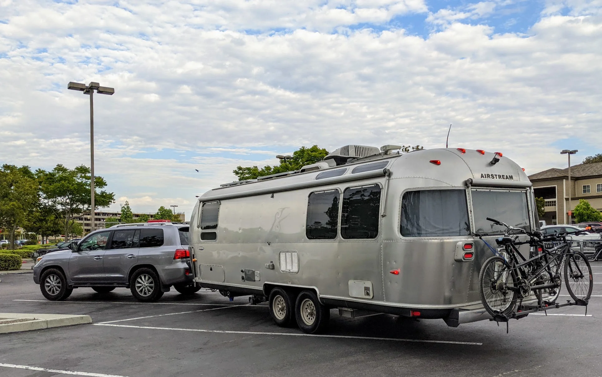

This whole time I thought you were really brave to tow this setup but as soon as I noticed your tandem bike I realized it’s more than just courage…you truly chase the impossible and must have one heck of a spouse.

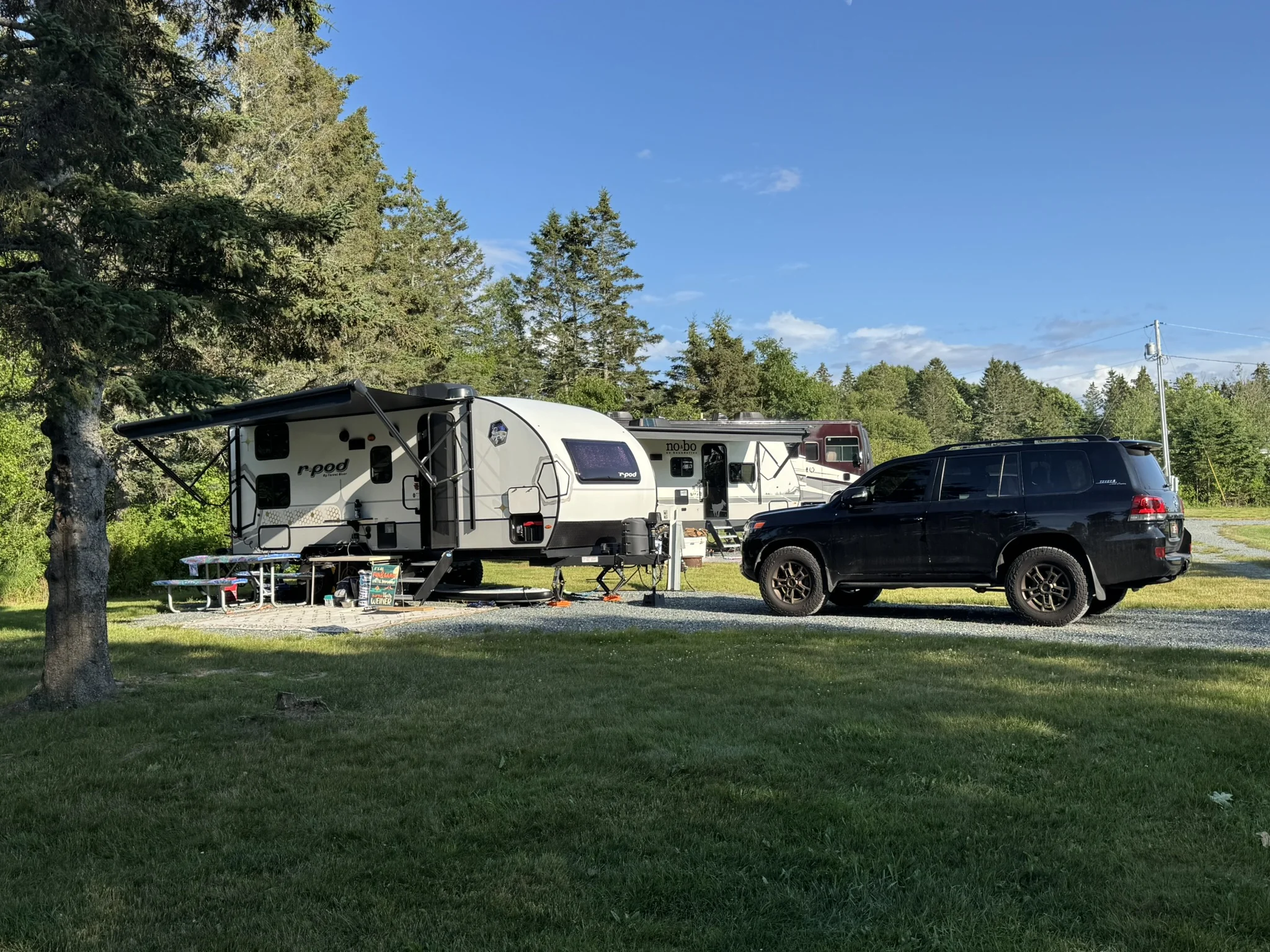

Just got back from a 16 day 3500 mile east coast run. Starting in NE FL up through SC, WV, PA, Niagra, VT, ME, MA, MD/DC, NC and back.
Our 2020 LC HE performed phenomenally through all of it. IMO it did show it's weaknesses in range and mountainous terrain. Traveled with a Chevy 2500HD towing a similar camper and a Class A and the LC impressively held it's own. Drafting is your friend...makes a HUGE difference in mpgs.
2020 LC HE
- 275/70/18 Falken Wildpeak AT4
- OME 2720s (rear)
- Firestone Coil-Rite air bags
- Blue Ox SwayPro WD hitch
2024 FR r-pod 202
- 25' length
- 4,868 lbs dry weight
- Curt independent Suspension
