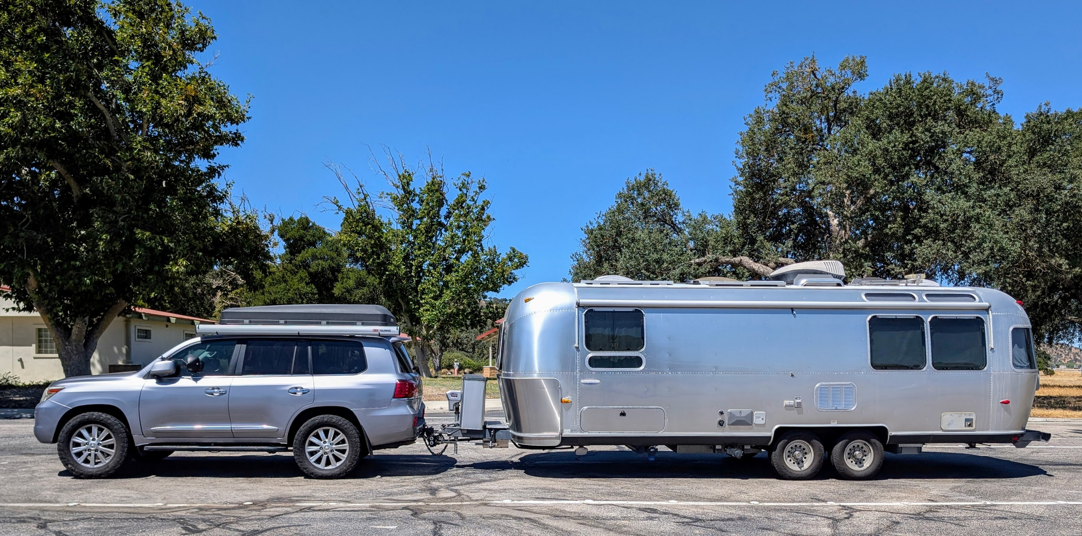

Got back from a 2k mile California glamping adventure. Big Sur and Monterey are such a great reprieve from the summer heat. Had family and friends along to enjoy the most indulgent campsite.
I knew I was going to be heavy enough that it would be worthwhile swapping over to 35s for better gearing, especially the safety of stronger engine braking. While it does great on 37s, it does run better overall on 35x12.5R20s.
Did see high ambient temps of 103°F in central CA. On one extended climb, saw engine coolant temps peak a 208°F. I've never seen over 203°F prior. I guess 5,600rpm for 10 minutes at a time will do that. Tranny temps with aux tranny cooler holding and doing well.
Your fat ass (rear axle) even exceeds mine. And here I thought 1200 over was pushing it 🤣
Fat ass is right. This was a 7-day trip RVing with 6 people aboard. Gas and fresh water tanks full. Complement of full travel trailer/gear along with RTT and awning gear on vehicle. So about 2500lbs payload between passengers, gear, and 1200lb tongue. I don't even have airbags in anymore so this is all AHC with some augmentation with spacers handling the load.
Surprised to see so much weight on the rear axle of the LX570 (front 3220 and rear 5820lbs). I would have expected your WDH together with around 1200 lbs tongue weight to have values more in the order of 3220 and around 4500lbs. Must be those gold bars you are carrying with you in the boot... Or the WDH being useless... ;)

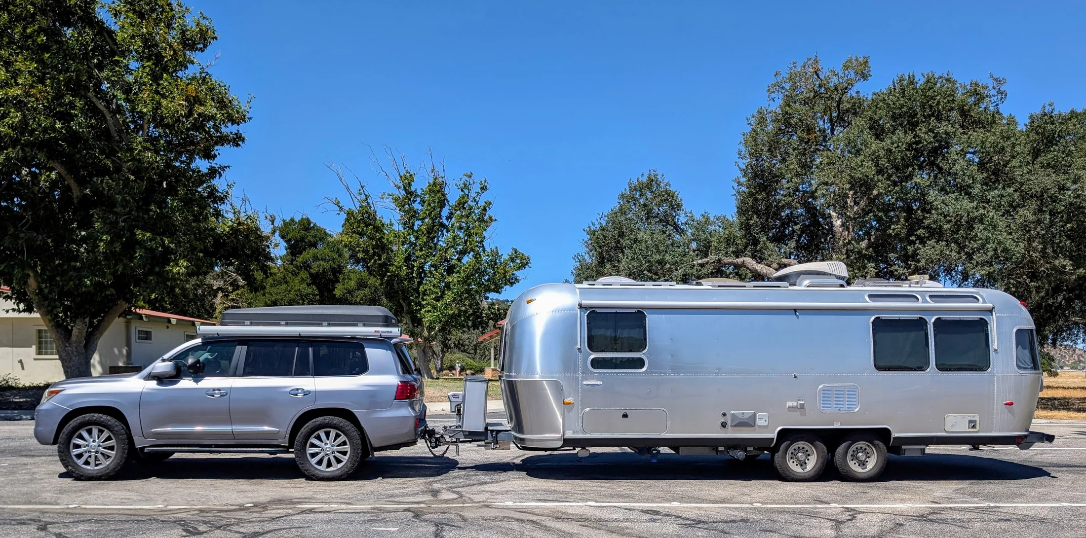

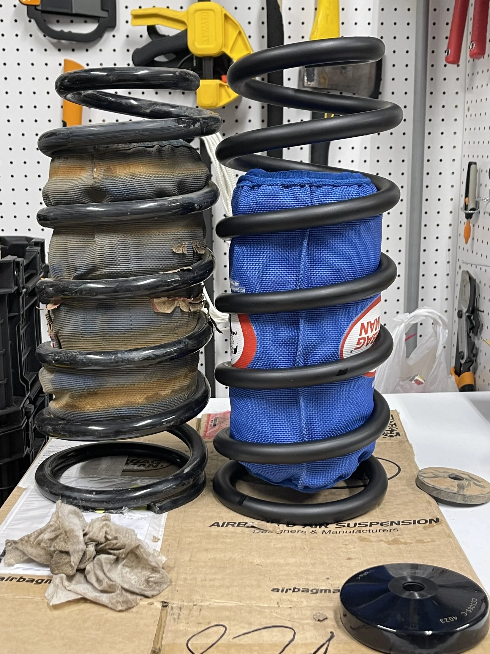

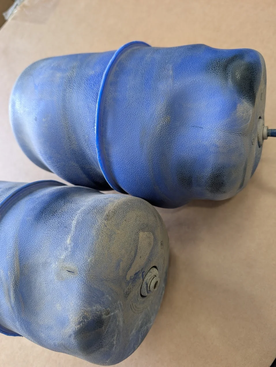

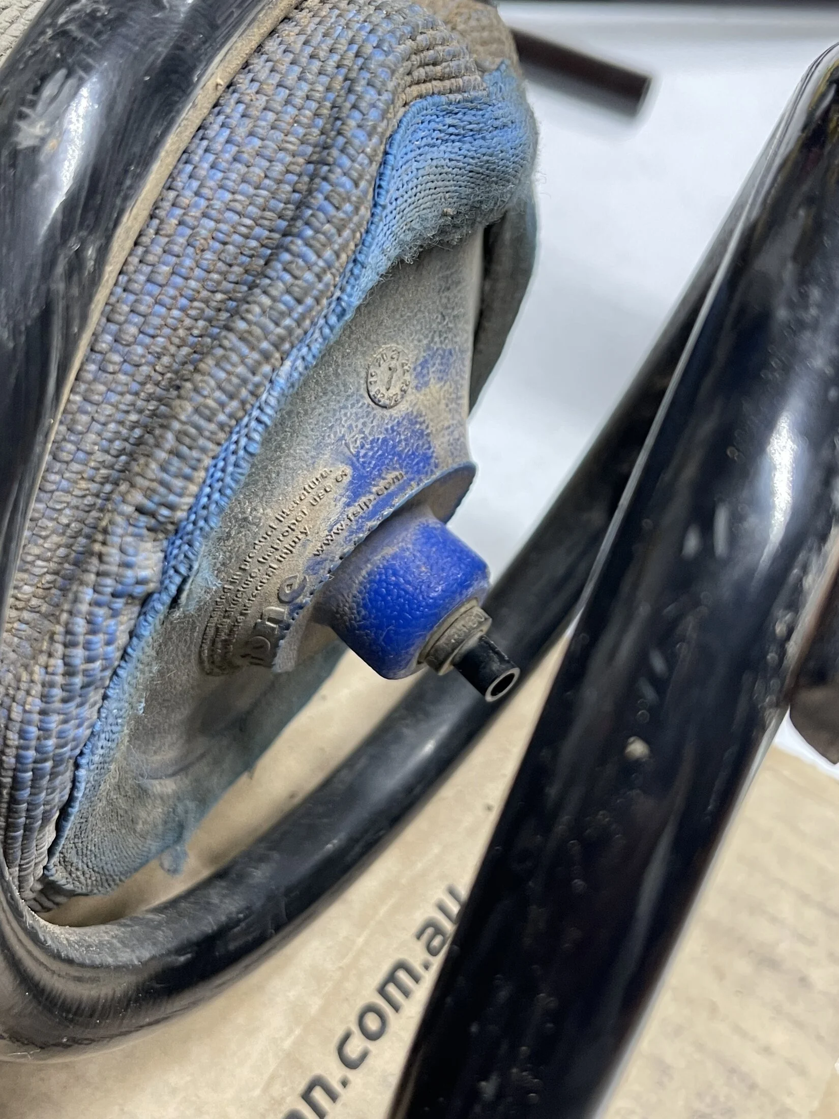

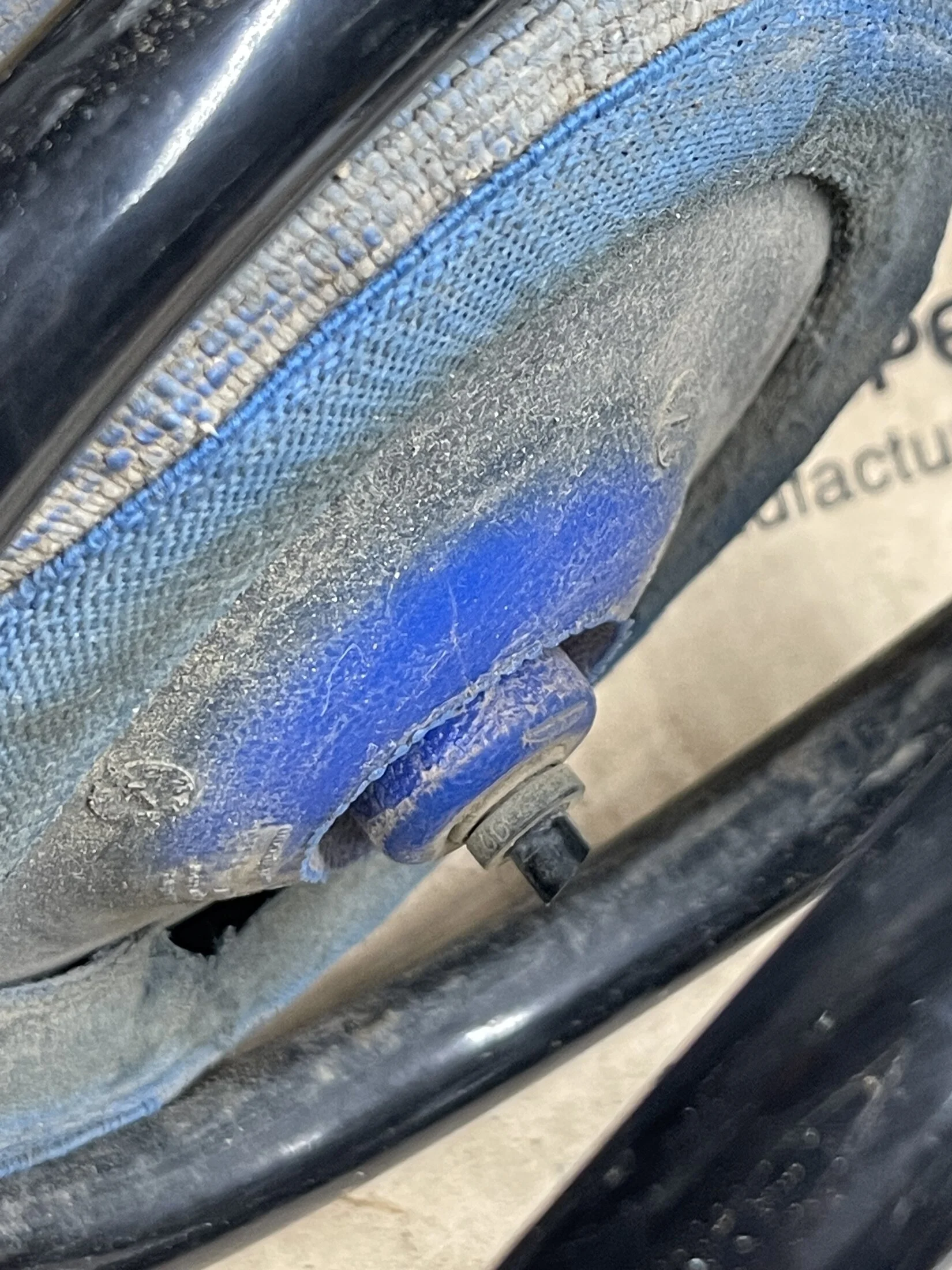

I pulled my Firestone airbags as they were damaged. They both developed stress riser cracks and would no longer hold air. It's possibly due to how I use my vehicle on long baja type runs and the rubber/plasticky material just doesn't put up with that kind of dynamic use and heat. Or how the jounce stops interface with the bags. Or both.
As I had to tow without the bags, it also showed me that AHC was up to task with minimal (20mm) augmentation. So I took it further and ordered a fresh set of rear AHC springs and 40mm spring spacers. I'm sensor lifted in the rear about 1", so it's really a net augmentation of about 15mm. It's handling 2500lbs payload just fine. Caveat is that it won't go into AHC high with 2500lbs. It'll go into high with about 2000lbs payload. I don't need the clearance of AHC high when towing so I'm not really motivated to get bags in again.
If I did get bags again, I might try Airbagman. Or Airlifts. I had Airlifts for many years and they worked great until I needed taller bags with AHC long travel and is when I switched to Firestones. The Airlifts felt like they were a high quality rubber versus the plasticky Firestones.

My bags died a similar death as well.
Thanks for the update and explanation. Makes sense to go for fresh AHC shocks.
While my airbagmans (= firestone bags + Kevlar sleeve) are doing good for now, I do very little off-road and flexing of the suspension so the real experience is probably with the folks down under. Be interesting to hear from our Aussie friends.
I’ve ran the airbag man long bags since the beginning, they work as advertised. Before I went to the correct spring rate, the hose inlet started to expand a little. I was way under spring and was running 15psi just driving around and 60-65 while towing. These things took abuse for 30k miles and seemed to hold up fine.
New vs old in new springs, big difference prior to use. OME 2722 upgraded to 2723.

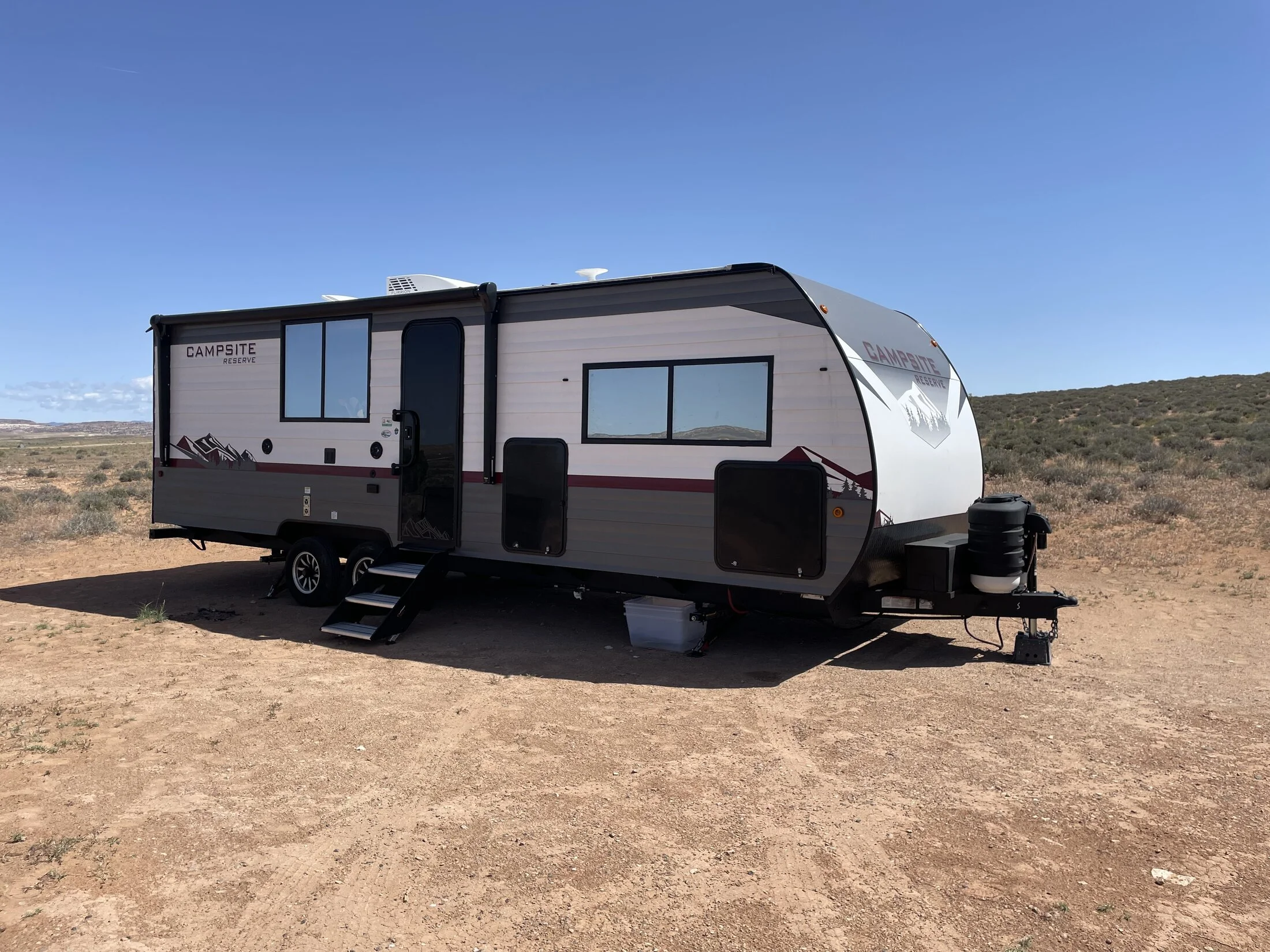

I am wanting to tow this:
2024 Forest River Campsite Reserve
24' long
Dry weight around #6500----aka heavy for an LX

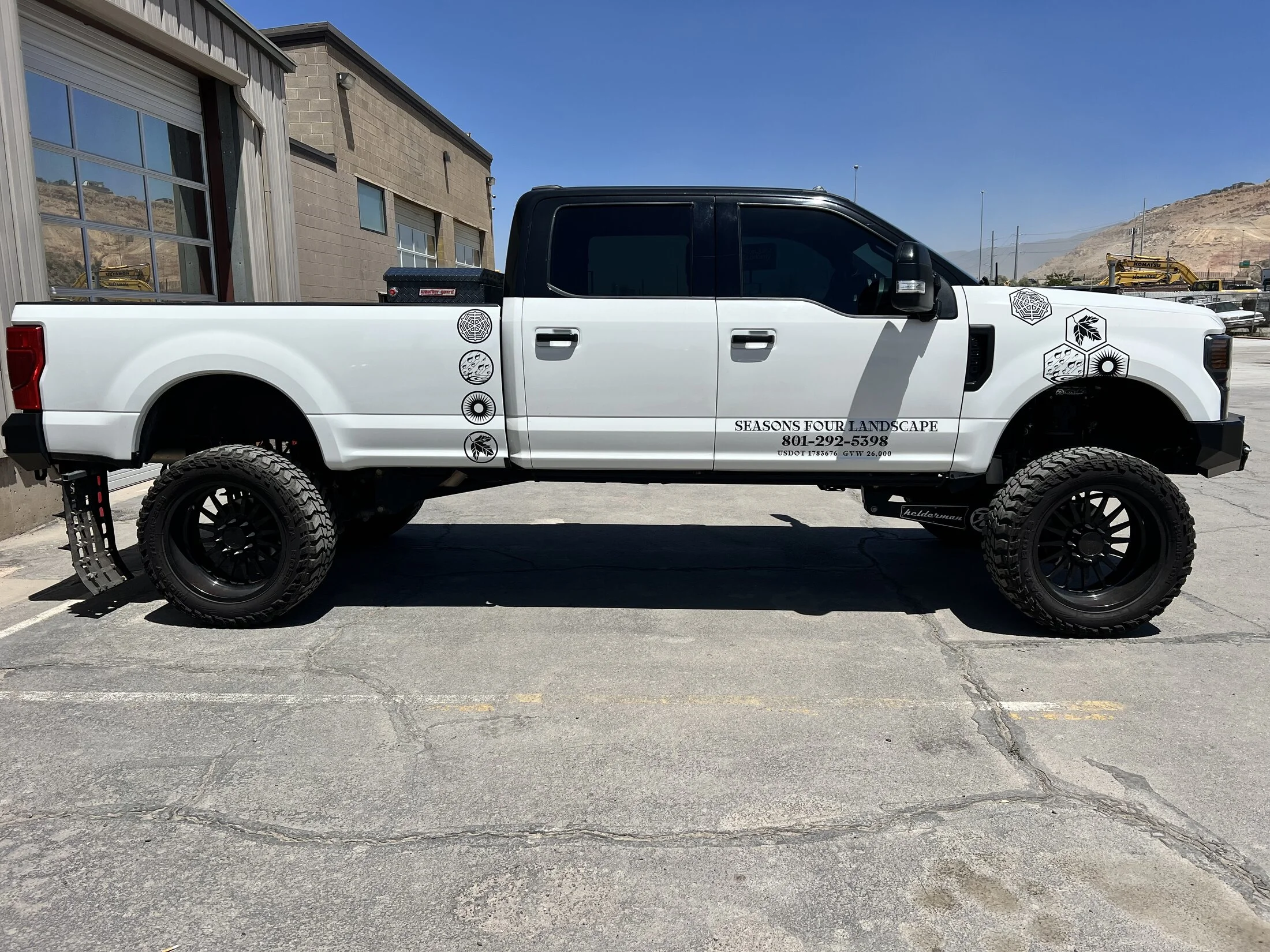

Which I know can tow a house. I don't even feel the trailer behind this. And I know I am in no way going to replicate that with the LX.

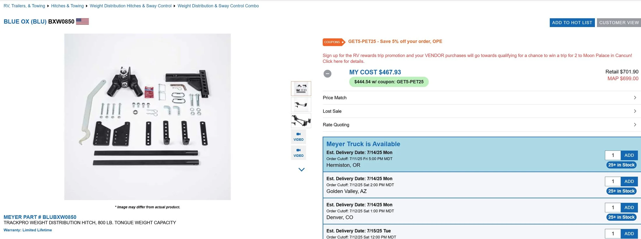

I am looking to get this WD hitch:
With the #800 tongue weight

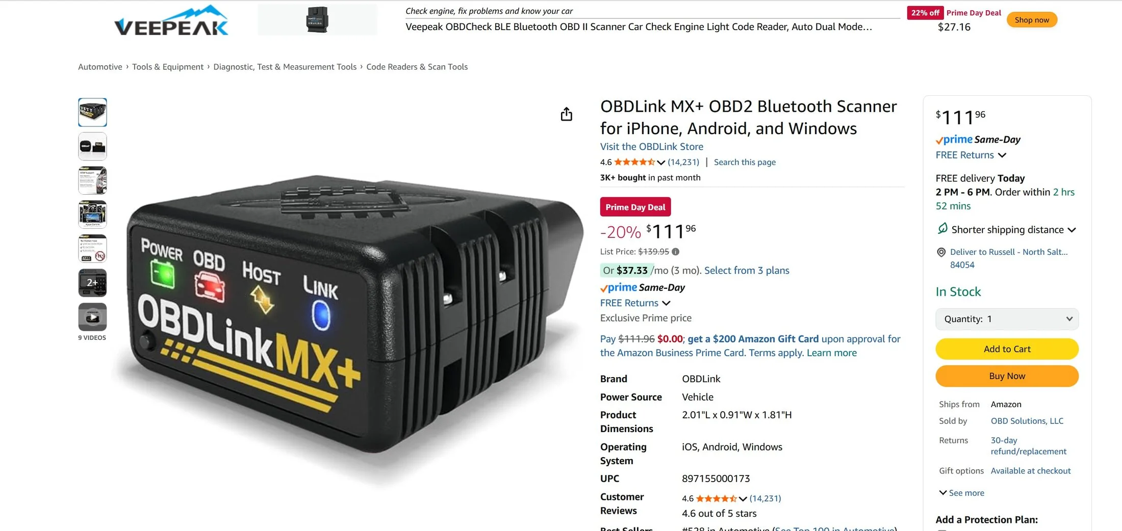

And this OBDII gauge setup:

Your loaded weight for that camper is probably north of 8k, especially with water tanks full. With a supercharger, it'll pull it no problem.

I am curious if the WD hitch I selected is a preferred style, vs the chain tensioners. I have heard/seen both. I know the hitch weight is important and think I have the correct one based on the weight.

I am very curious to the temp control of both motor and trans with the SC. Hence the OBD II gauge. I know I need to be watching that closely and am curious as to how well the extra power gets me over Parley's or other canyons pulling the weight.
