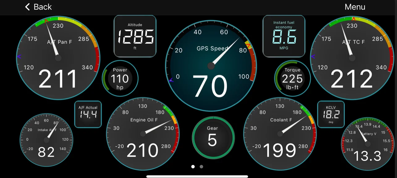

Since a couple people pinged me, here's my latest OBD Fusion dashboard (with a live action shot, nonetheless). It's laid out to fit my iPhone X, so your screen may vary. The green ring in the bottom around the gear lights up when the torque converter locks up, and turns off when it unlocks:

The ring around the "Gear" dial will light up green when the TC is locked, and will disappear when it's unlocked.

  1. Copy the .stg file to your dropbox or icloud account.
  2. Go to "Settings -> Preferences -> Dropbox/iCloud" and log into your dropbox or iCloud account.
  3. Then go to "Settings -> Menu -> Import Settings", select either dorpbox or iCloud (whichever you copied the .stg file to) and select the .stg dashboard file
