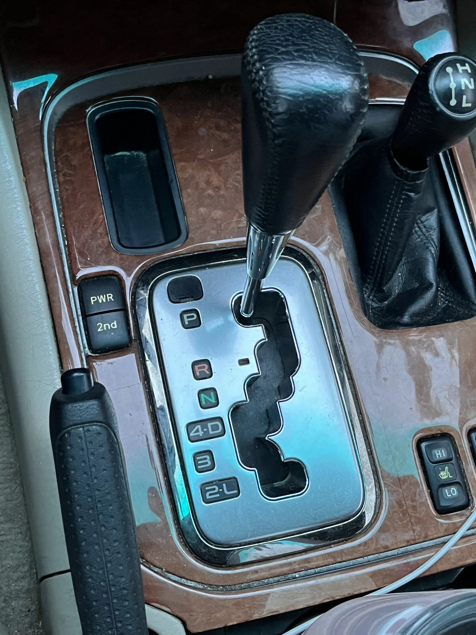

Thanks. I definitely don’t have a Tow/Haul button. Is this what the PWR button does?

I know the PWR button shifts the RPMs up, but wasn’t sure if that’s what the tow/haul feature also does. Here’s what I’m working with (please don’t judge the dirt, I track in a lot of filth from the barn lol):
So far I have been towing while in “4”, and read that I can enable PWR when going up hills for more torque (higher RPMs).

That's it. The 2nd button is to lock out first gear. Helpful in certain situations when your stuck. If you don't have an owners manual I suggest getting one. My 100 series came with a very nice leather zipper pouch for all the manuals. I liked the pouch so much I ended buying other manuals off eBay to get the pouch. One of them was a 2001 LC manuals. 2000 manuals stayed with the LC. Along with tools and jack. Nothing like buying a used and finding a previous owner or dealer took those out. Early FJ40 had really nice tool rolls. Only once did I every buy one with the jack and tool roll still there.

Awesome thanks for confirming! I’ll start using PWR next time I take the trailer out
