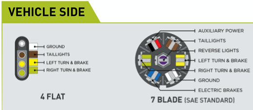

You still need to wire up a 7 pin plug like @geanes and @hoser suggested. Link to old thread on this topic. The Curt bluetooth thingamabobber would then plug into that. Or you could hardwire in the Tekonsha or similar upstream of it.
I think the image on the left is "before" and to the right is "after", but double check your truck with a voltmeter.
Edit: info above stolen from Hopkins site. Lots of good info there.
