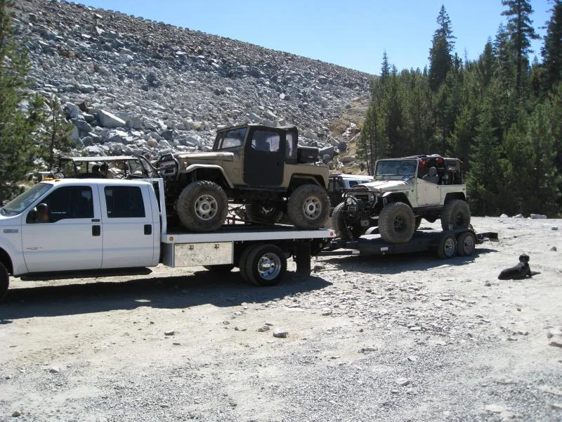

i drive with a trailer with a standard hitch and electric brakes on all 4 wheels just about every day for work
i have done it with a chevy 1500 and a diesel f250
the difference is staggering even with the trailer i use, heavy dump trailer but lighter than a 40, between the 1500 and the 250
the little experience i have flat towing my 40 has amazed me at how heavy they are and has confirmed my belief that they should never be towed, more than across a flat town very carefully, with anything less than a diesel 250/2500 or anything with a towing capacity at or above those.
as far as a fj cruiser or a 4 runner i would not even consider them close to safe with a 40 behind them
once you drive with a trailer of any sort and have a situation with some idiot driver that makes you brake hard(even with trailer brakes) you understand the difference between what a vehicle is rated at for towing capacity and what is safe with it.
If you're ever worried about your tow rig being too light to tow a 40.... You can always add some weight to the tow rig....:popcorn::popcorn::popcorn:
