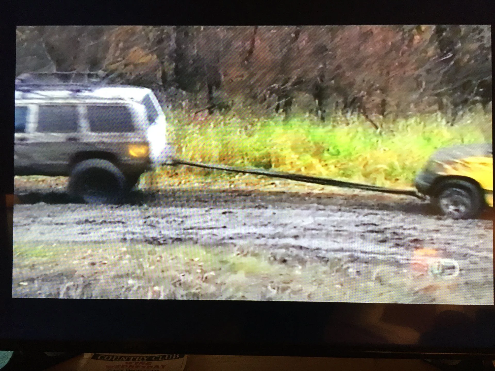

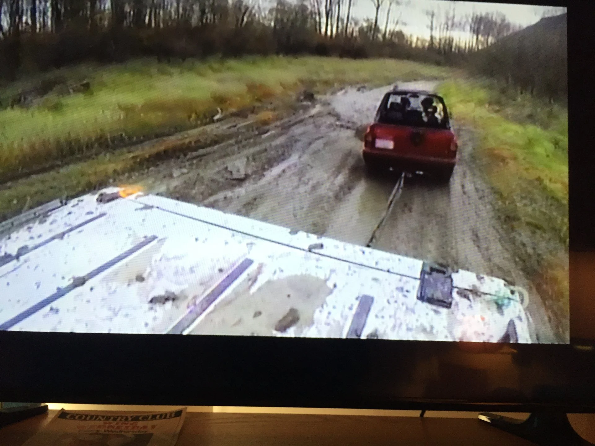

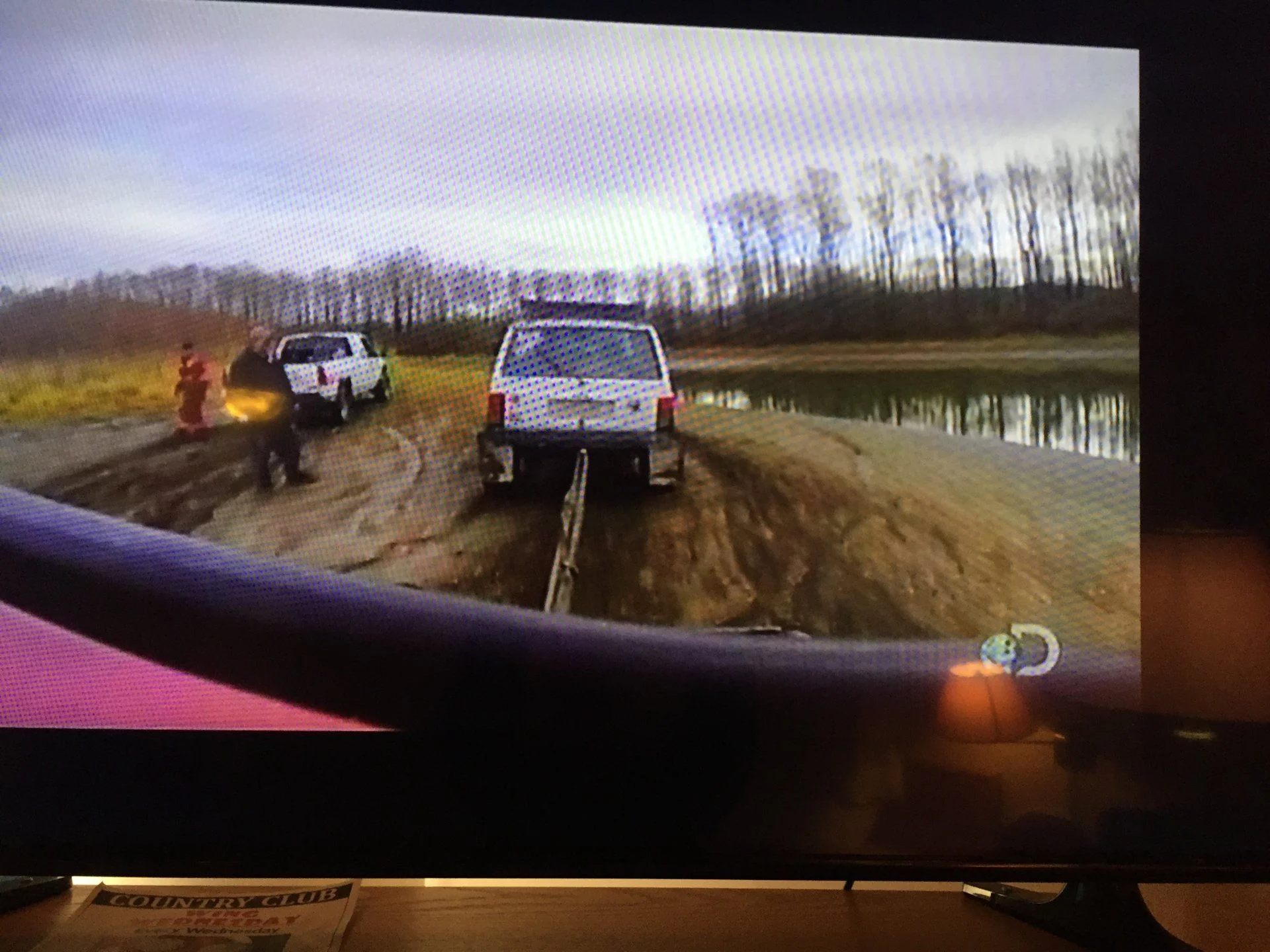

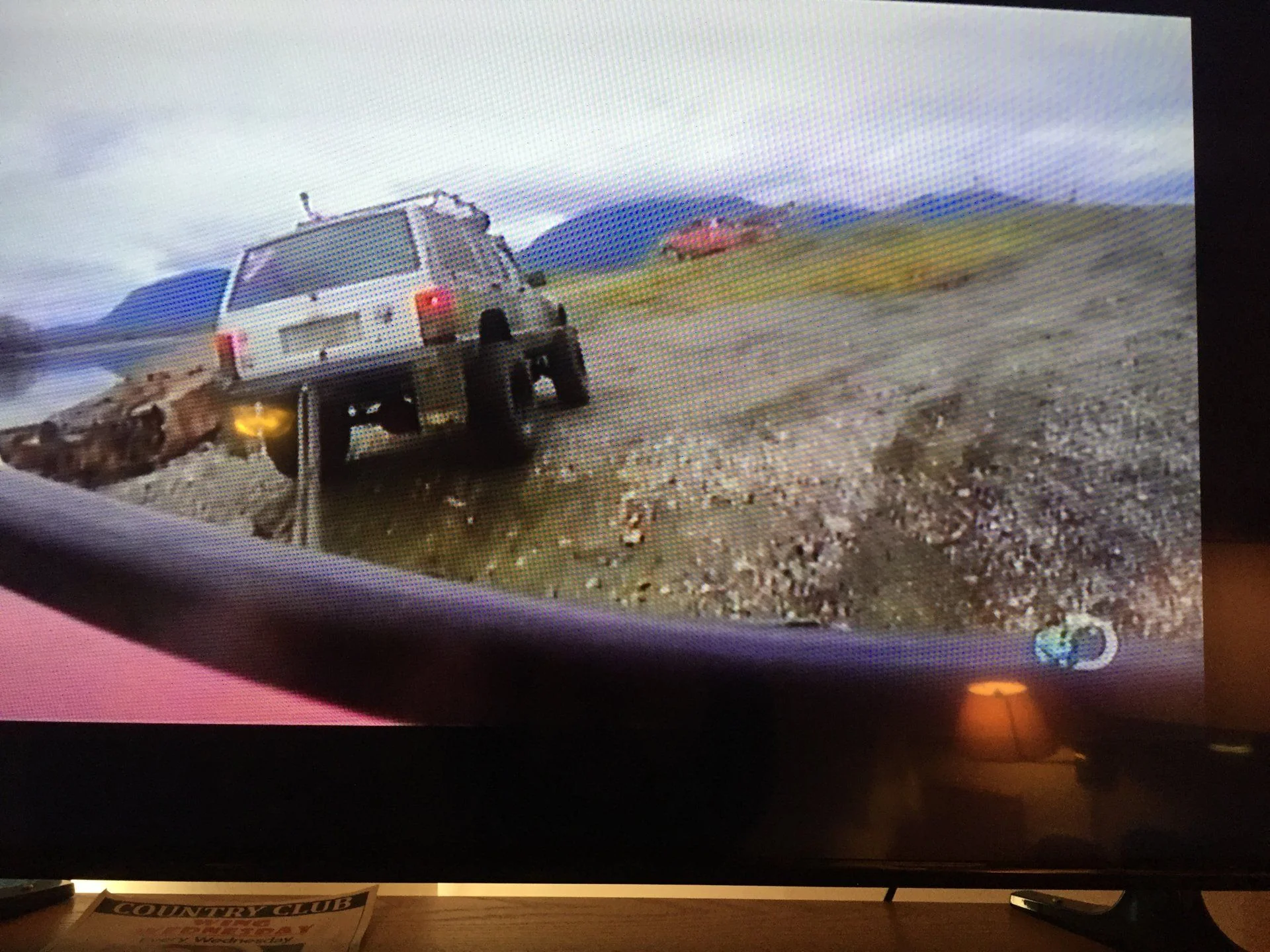

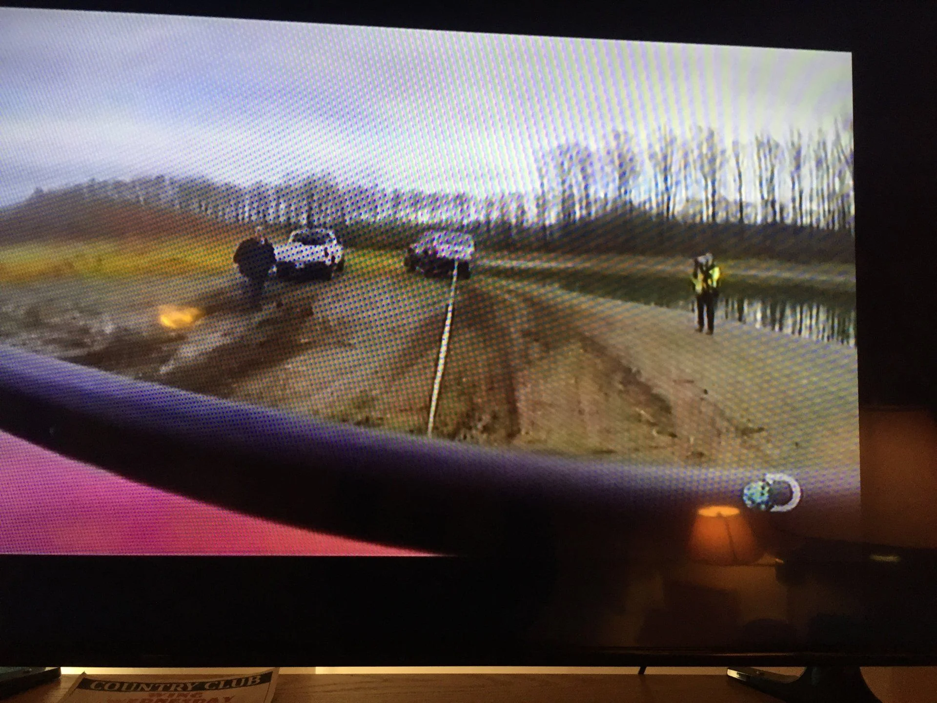

So I was watching Highway to Hell and the guy was recovering a couple of stolen Suzuki’s on the Fraser R mud flats. So a guy in the Cherokee comes in to help out and hooks the tow snatch strap over the tow ball. The first snatch strap broke. So they did a second bunch of pulls and recovered the two stolen Suzuki’s. The first they pulled backwards. It amazed me they’d put it on TV.
Had that guy tweeked the wheel that thing could have rolled in an instant. That would have made for good TV
Then they pulled the second Suzuki out, it wasn’t so bad and it was pulled forward. Still using the tow ball as a recovery point.
What I couldn’t believe is that they are a tv show about recovery and I’d have thought the editors would have realized they were endorsing a potentially dangerous idea.
This all being said, it wasn’t a really high load pull. But I just felt worth mentioning.
