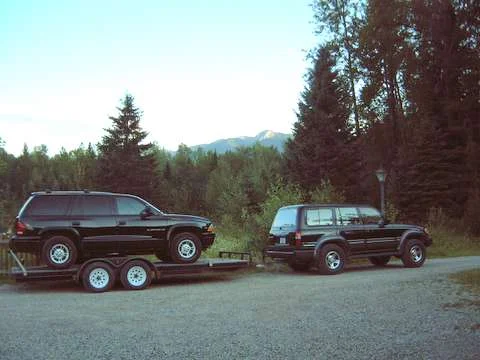

I towed this 180 miles. Trailer brakes are a must.
