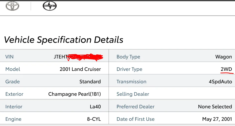

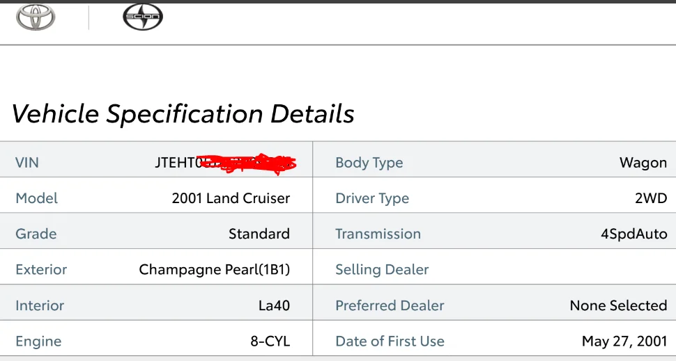

I was looking as photos of similar model year Cruisers. I saw pics of the transfer case shifter in what looks like the middle (N) position. I think there were pics of that in at least a couple of the restoration threads. Is it common for folks to have that shifter in the N position? I assume it’s was when parked and E brake was on. I guess that also threw me off. I would have expected if the H was the default position, to not see pics of that shifter in the middle position. But could be many explanations for that.
From the VIN and plate , it was produced in Japan. I’ll have to look up the details when I go back to the house to run it again, but it’s a lighter metallic brown. It runs great. There’s some superficial damage from my dad’s misjudging of the driveway fence post and someone keying it, but overall great shape for a 2005. I think mileage is super low. I want to say less than 30k.
Thankfully the shifter does move fairly easily between H and L. I would say about as easy as my 4Runner did from 2H to 4H. I am pretty sure my dad never drove the Cruiser off pavement. Looking forward to seeing how it handles the mud puddles near my buddy’s camp site. It’s been raining pretty heavily here for the past couple of weeks, so it should be interesting.
Sounds like a great vehicle with super-low mileage! Suggest be watchful of parts which may have perished or dried out with age and/or started to disintegrate - this mainly means parts like valve timing belt, belts for water pump, fan, alternator, aircon and the water hoses around the engine. In particular, and especially if you have 2UZ-FE 4.7 litre V8 engine, search "heater T's" on IH8MUD and replace urgently, not difficult, small not-so-minor part which easily can leave you marooned. When you can, do a "full base-line" of the vehicle -- inspect everything personally or with help and replace ALL fluids in ALL systems throughout the vehicle.

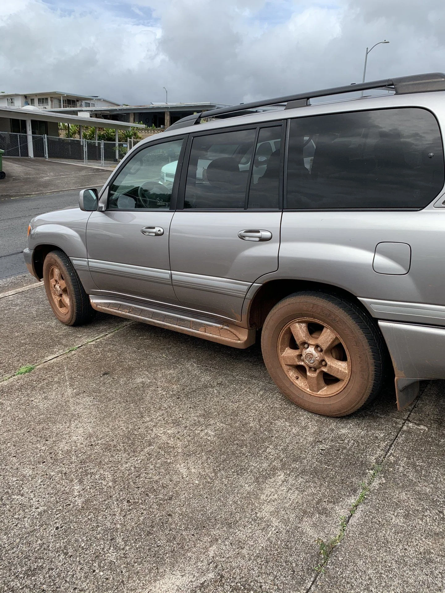

Overall it was a fun trip and good experience taking the LC off road, albeit pretty minor off roading. Good to not have to worry about conditions with capable 4WD. My other car is a 2WD SUV. I’ve taken it to this camp a couple of times, but not when it has been that rainy before.
Anyways, here’s a pic at my friend’s house after coming back from camp. Doesn’t fully capture how dirty it was, but captures most.
