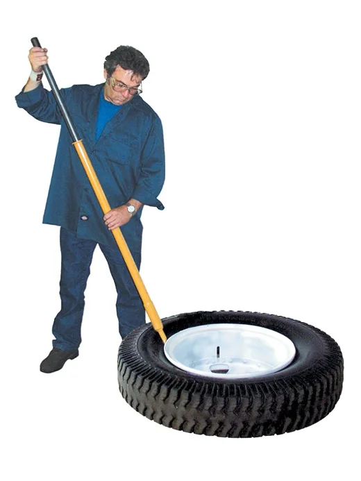

With the avatar vehicle weight is a HUGE concern. I made a tool to break the beads that uses the Snap-On 24" breaker bar that I was already carrying for the lever. I used motorcycle tire spoons because they are small and light. Before carrying those into the field I mounted a pair of 31's in the garage. It was a work-out, but they worked surprisingly well.
This is the bead breaker, the design is not mine and I've lost track of whose it is.
In use a piece of chain is attached to either a lug stud hole or if still on the vehicle to the lug stud itself. The breaker bar is inserted into the angled tube. The chain is picked up by the slotted hook and the 'foot' is pressed against the bead right next to the rim. With just a little practice it is fast and simple to break a bead with this. When we built one for MISF we built it to use the handle from his Hi-Lift (he removes it for stowage) and in that case the handle fits over a slightly longer angled tube.
