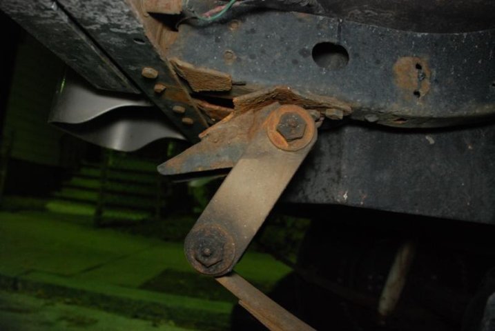

Then I went to Randy's to help Mark fix the spring hanger on his red, soft-top 40. I literally held the flashlight the whole time. I am skilled.
Fixed a broken rear shackle perch on the 40 with John and Randy. Well.. John held the light.. i loosened a few bolts.. and Randy did the hard stuff.. :hillbilly:. Fairly painless proceedure and got to spend some quality CRUISER time with some good peoples!
I noticed it was broken the other day.. coulda got ugly if it broke all the way. Got a replacement from Ted's next day as they are discontinued from Toyota.. product looks good and welded for extra strength. Randy has a few pics of the procedure he may be able to share.. here's a pic from before.

Mark, I notice that there were bolts there instead of the rivets. Had you replaced that piece before?
Mark, Randy,
I would suggest welding the tail end of the perch to the rear cross member to prevent that from happening again. I think they did that from the factory, if memory serves me correctly.
Jr.
Jason..
Yeah i replaced them both with brand new OEM perches back in 2002 when i restored the rig.. but i guess salty New England winters have paid their toll.
Junior that is a really good idea.. we should indeed do that.. (along with putting in the bolt that appears missing in Randy's final pic.. heheh)
