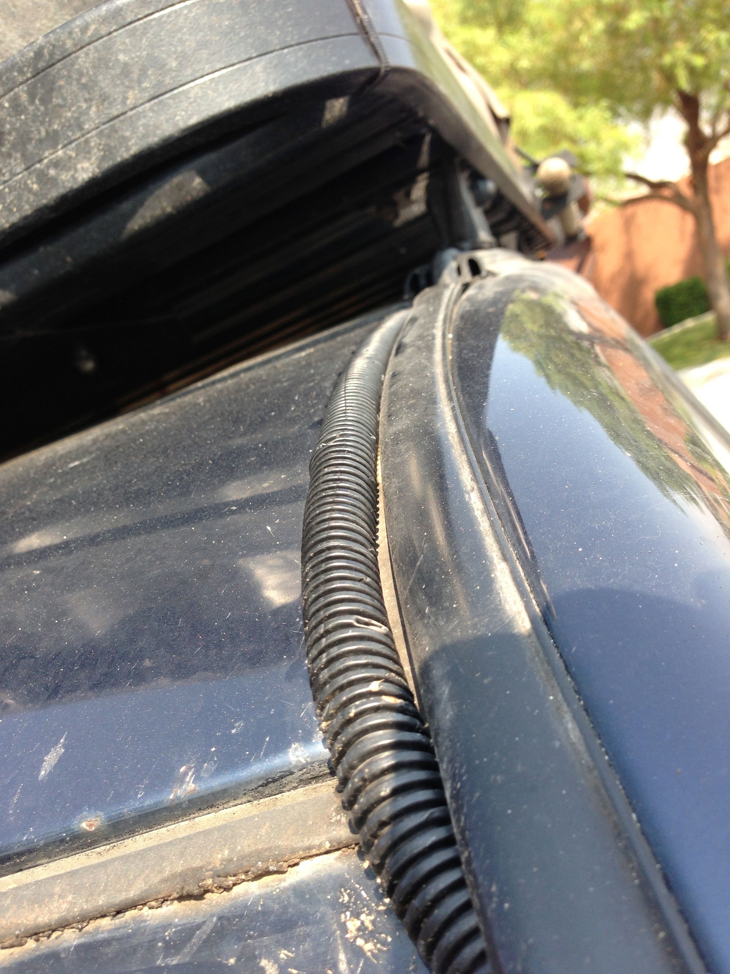

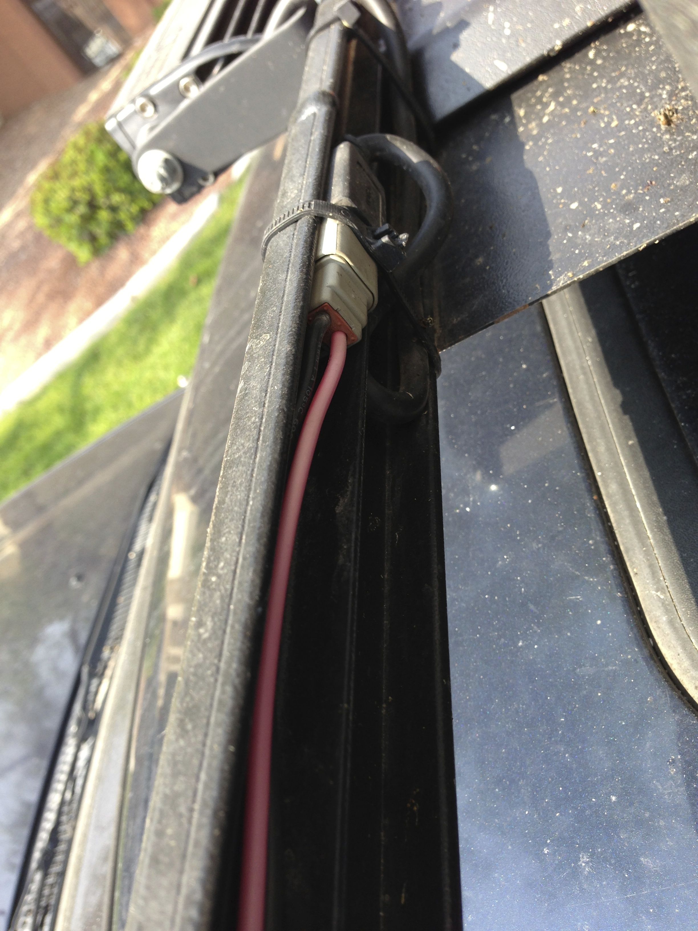

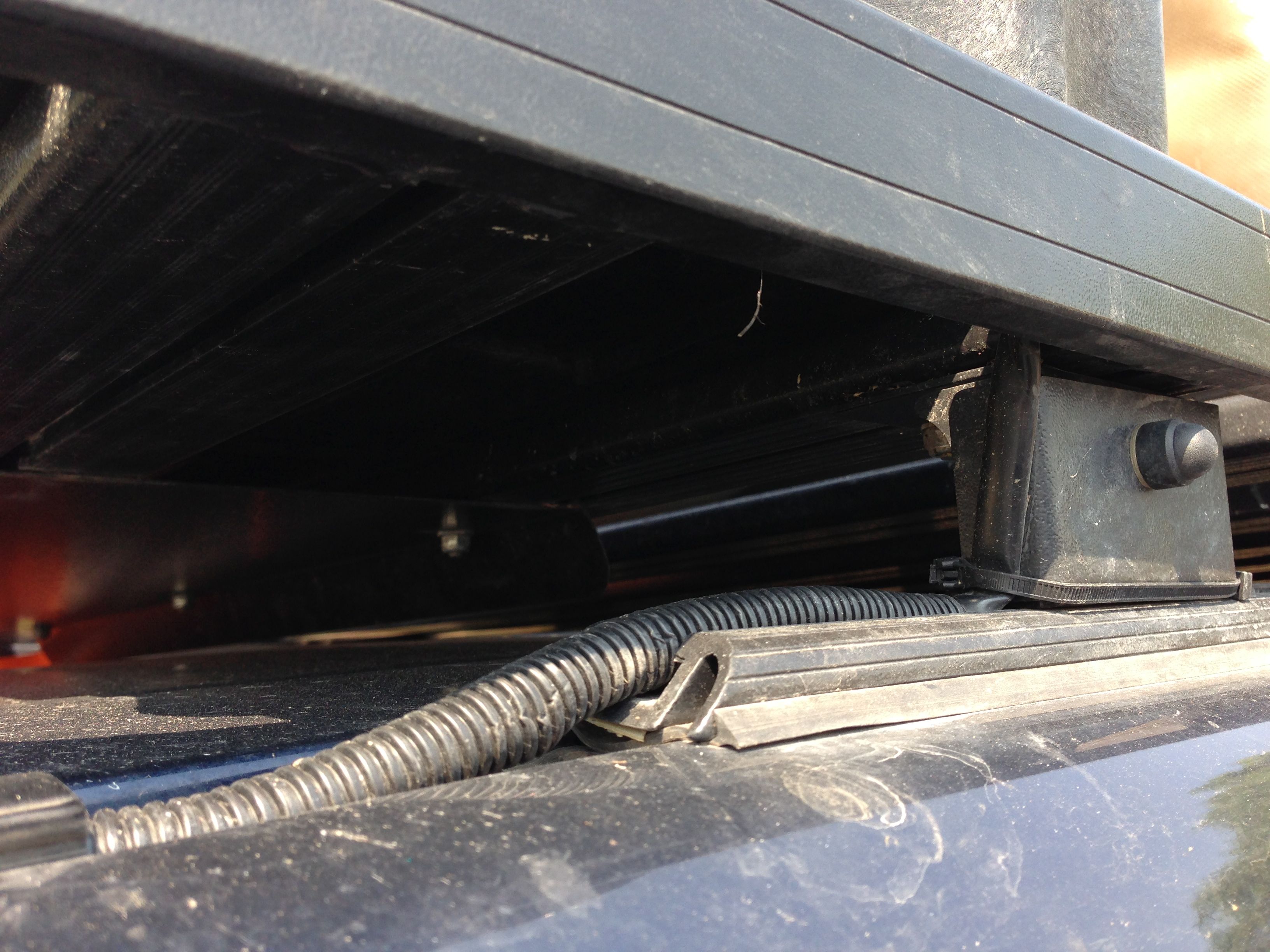

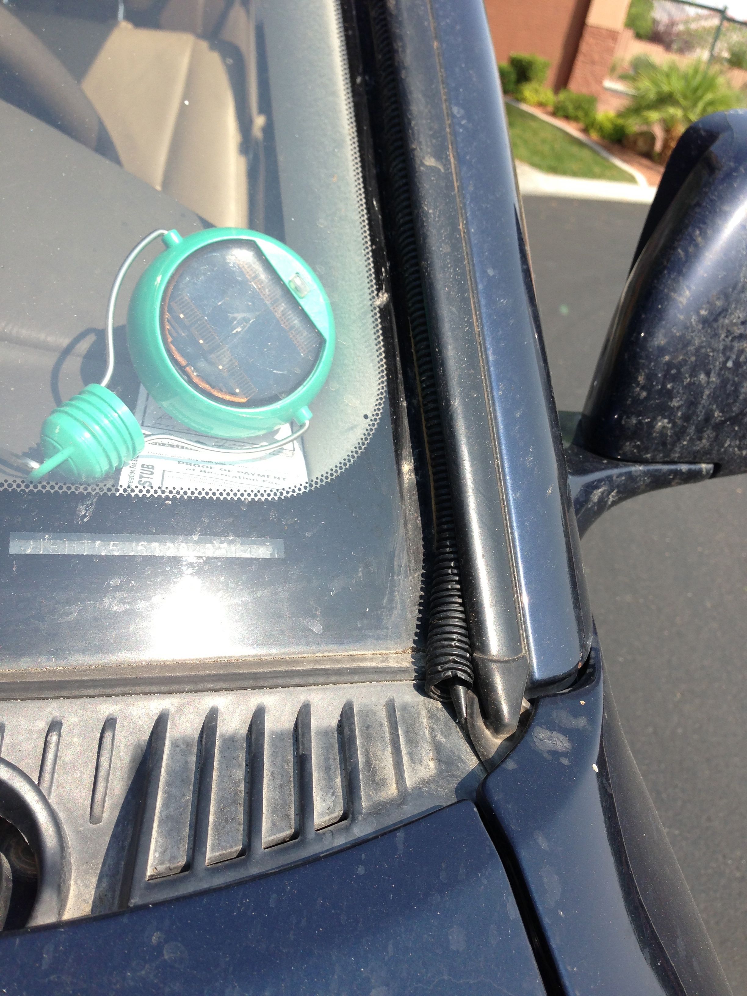

Here are a few pics of the wire run to the light on my truck. I'm currently using a Rigid 20" SR bar on my Front Runner rack. I mounted it directly to the of the rack using the provided brackets. I haven't tried, but envy the longer dual row bars, however this one provides more than enough light for what I need.
I'm not sure this is the "best" way to run wires, but seems to work.
From under the hood, I tucked the wire under the molding, then ran it through some flex tubing. I put some double backed tape underneath to hold everything in place.
Continued with the flex tubing up along the roof line...although it sometimes (like now) requires a little more tuck to stay umm, tucked.
Ran the wiring up the foot of the rack, then along the inside of the rails.
Cable ties hold the wires, including the connector in place. Had to loosen the Front Runner wind deflector to get a cable tie through at the top. If you had a longer light bar, this wouldn't be an issue.
