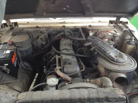

UPDATE!
Well..the new 55 is home and garaged. More rust than I had anticipated but better than most. Immediate needs are floor pans and then the passenger side top over the back door. Most everything else is surface rust.
I should be able to get her turned over this weekend...as suggested....I pulled all the plugs and got a nice dose of marvel mystery oil down each cylinder. Pulled and replaced all the ignition gear including an upgrade to an igniter electronic ignition kit + coil right off the bat....you should see this bs setup that was on here ..some old ass Peterson thing with wires going everywhere...no wonder it never ran right!!!!
Also drained the oil and was pleased to see regular black oil with no surprises inside.
Battery is fully charged and ready to drain during starting....will keep you all posted.

UPDATE!
