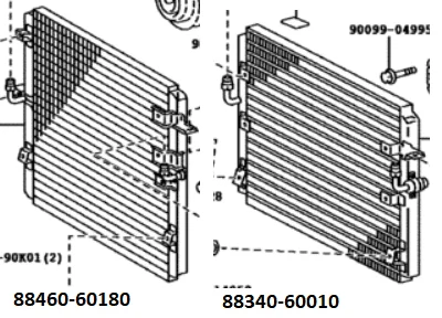

I have the same 88340-60010 condenser in my 1991 PZJ77 and am currently looking for a replacement. Judging by your last post the 88460-60180 replacement you bought was a close enough fit. You did however mention some mounting bracket changes across the different part numbers. Did you have to relocate some of the mounting brackets for the new unit to fit? Did you also have to replace some pipes and/or fittings?
Judging by these images (credit Megazip) the order of the fittings and mounting brackets is different and the 88460-60180 appears to be slightly taller.
I would greatly appreciate if you could confirm these differences and mention any required modifications.
Many thanks!
@tohox as you know, this has been some time ago. My recollection is that the replacement condenser was the same dimensions as the original. I just swapped the original brackets to the replacement condenser and it bolted right in. That part was easy.
The hard part was the fittings. I went to several shops in Lexington, KY and one in Louisville, KY and no one had seen the fittings on the replacement condenser. I thought I was sunk. This is where the hero comes in: @jblueridge had already gone through this process and offered up Fred at Hensley's Radiator in Charlottesville, VA. He attached the needed fittings on the replacement condenser so I could then use my original hoses. I installed it, had it charged at a local shop and it has been working as it should without issue.
If you are going to go this route, you will have to find a shop to replace the fittings. You might look for a franchise of Tubes and Hoses: Hensley’s Hydraulics - https://www.tubesnhoses.com/system-locations/hensley%c2%92shydraulics near you. I think Hensley's was a franchisee and had what was needed to do the fit up. I suppose you could also buy the needed fittings from them and have a shop local to you install them for you.

Thanks for the quick reply!
Did the shop simply cut and weld the original fittings from your old condenser onto the new one or did they manage to find new ones with the proper size/threads? If I was able to source the proper fittings I might be able to TIG weld them onto the new condender. I haven't removed the condenser yet so I can't really tell if this is a sensible course of action. Perhaps it is just a matter of cutting the tubes, changing the nuts and flaring again.
Again, many thanks!
They did not have the original condenser so I suppose they had the needed fittings in stock and used them. If you are a competent aluminum welder I do not know why you couldn't reuse the nuts/fittings from the original condenser. this would be a much simpler solution.
Please update this thread after you try this for future reference.

Hey!
Mr Fred Hensley used great experience and specialized equipment to cut and expand some tubes so another tube could fit inside it, like plumbing or exhaust piping.
I believe he hard soldered the fittings together.
All the equipment relates to his hydraulic hose business, which as Peter says is a Tubes and Hoses franchise.
