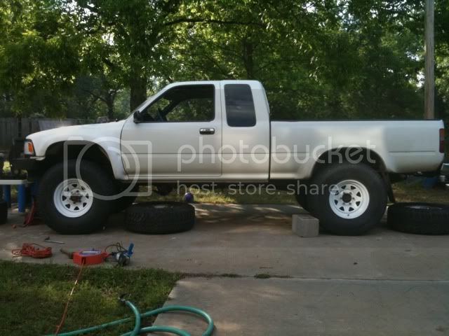

Here is a pic of my truck on 33s and then on 35s in the driveway. Same suspension: torsion crank and AAL & no BL.
33s
35s
Man that looks good with those 33's. I hope I can get mine looking that good at the end of the day. I like those front fenders too.
I will post a progress picture later today of mine.
Looks a little stuffed with the 35's, but that body lift should help with that. IF you can I would love to see pictures of it on both 33's and 35's when you get the body lift on. Let me know if you have any tire clearance issues anywhere.
