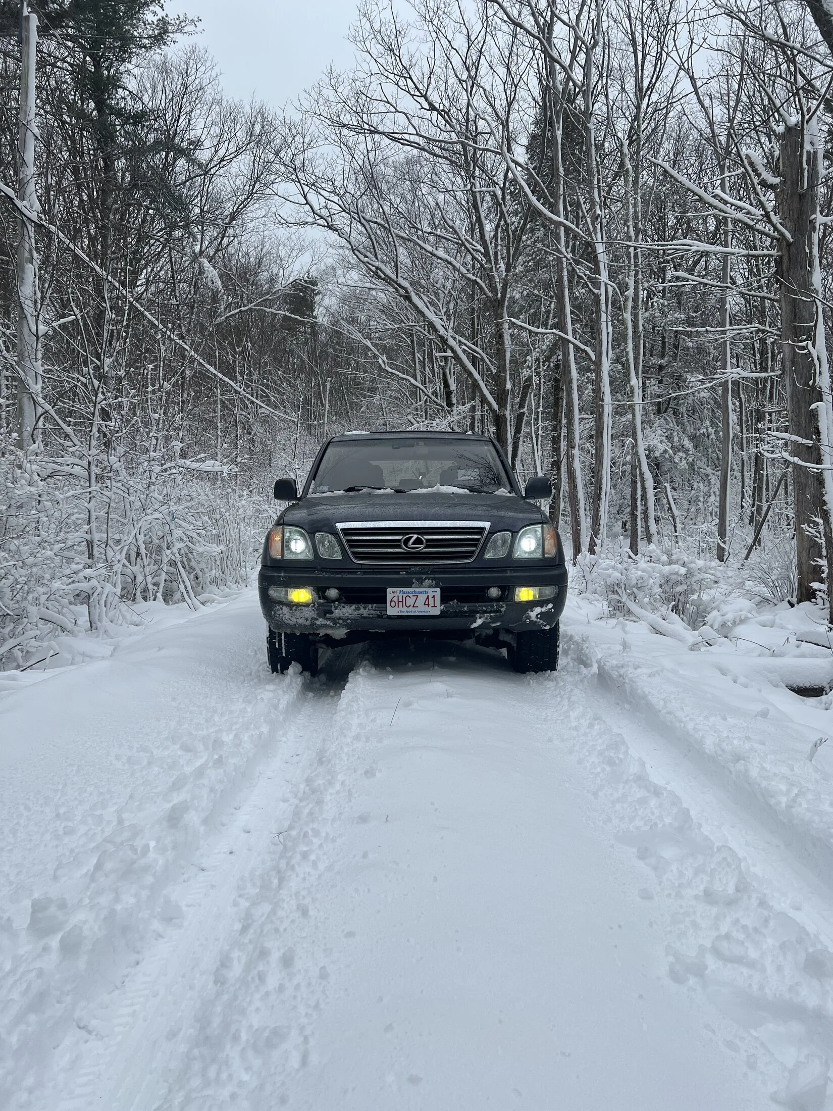

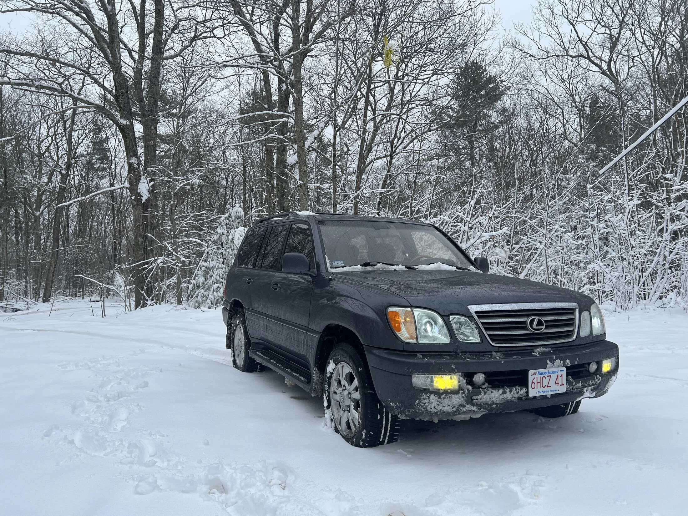

A Michelin Defender accomplishes all your goals, but if it comes down to looks I'd recommend Toyo AT3. Quietest AT I've experienced versus a few others.
With that much highway and not off-roading, I’ll echo the Michelin Defender. Great all round tire.
I just drove them through the snow storm we got over near Wachusett Mountain in Massachusetts. They did great on plowed/slush roadways and on unplowed roads. I was most impressed with the cornering grip. I was also surprised that I didn’t lose any traction on a light off-road trail I frequent.
They’re also fantastic in heavy rain. No experience in deep mud yet, but they’re solid in the thin mud layer stuff after a downpour.
All that said, those Geolanders seem like a good option too if you want a slightly more aggressive look without extra tire weight and road noise of a true AT
