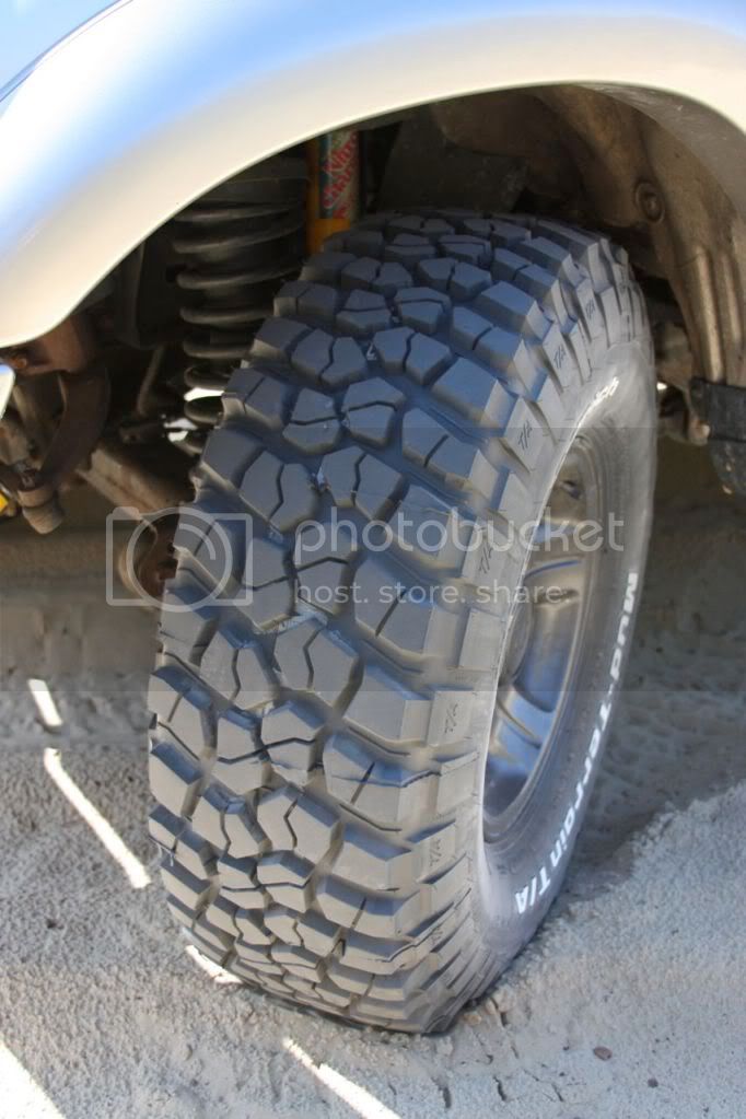

Here are a couple of pictures.
Those look real nice. Ive seen them on a few rigs and they look pretty mean. Let us know how they handle on the trails.
Looks very nice, now let's talk about your wheels, I really like the look!:cool:

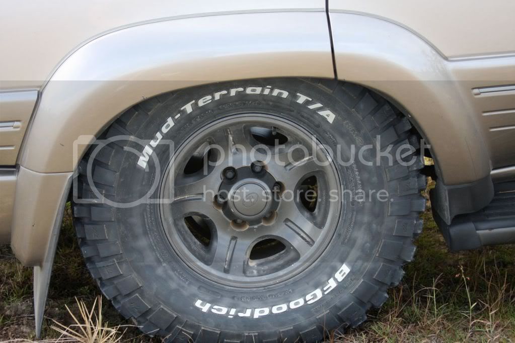

Nice.:clap: I prefer white lettering on the inside though.:p
I went back and forth on which way. I opted for the white out b/c I think they look sharp when the cruiser is fully dressed and cleaned. However on the trail and how my cruiser typically looks I may regret it. :rolleyes:
Thanks. I refinished my wheels awhile ago and I'm very happy with the finish. Plus is they get nicked I can just sand and re-spray. Looking new again. The old clear coat was oxidized and they looked like a spider-web. :mad:
yup, you got em on backwards:flipoff2:
and not bein an arse.... what is a wheel to hub measurement? Edge of wheel to hub should be the same no matter what tire size you have.

Backwards??? :) Thats how we roll in the 80's baby!! The white letters out on tires have always been a favorite of mine ever since I saw them as a kid in the 80's on toyotas, nissans, etc.. I guess its just a nostalgia thing.
Same here! :p
Give him a break...it's a south east thing!:hillbilly:
Don't listen to them Paul... your 80 looks awesome!!!:clap:

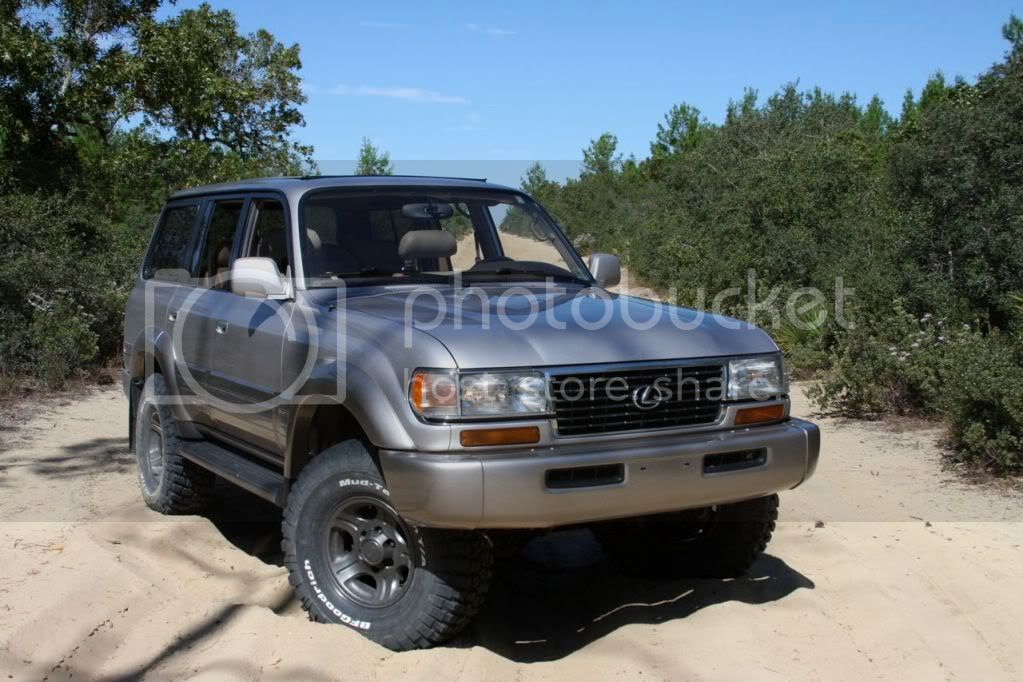

Here are some photos from wheeling this weekend. The tires were GREAT!! Its like having a locker up front. Sand that I would have to get a run at before now I can stop start without fear of tire spin. These tires are great! Tons of grip and side bite. This has sealed the deal for me. These were a great pick. I cannot wait to take them wheeling up in TN on some real trails.
Notice the flexing. There was some rubbing while fully flexed. I'm going to have to extend my bump stops before I do some serious wheeling. However still looks great!
