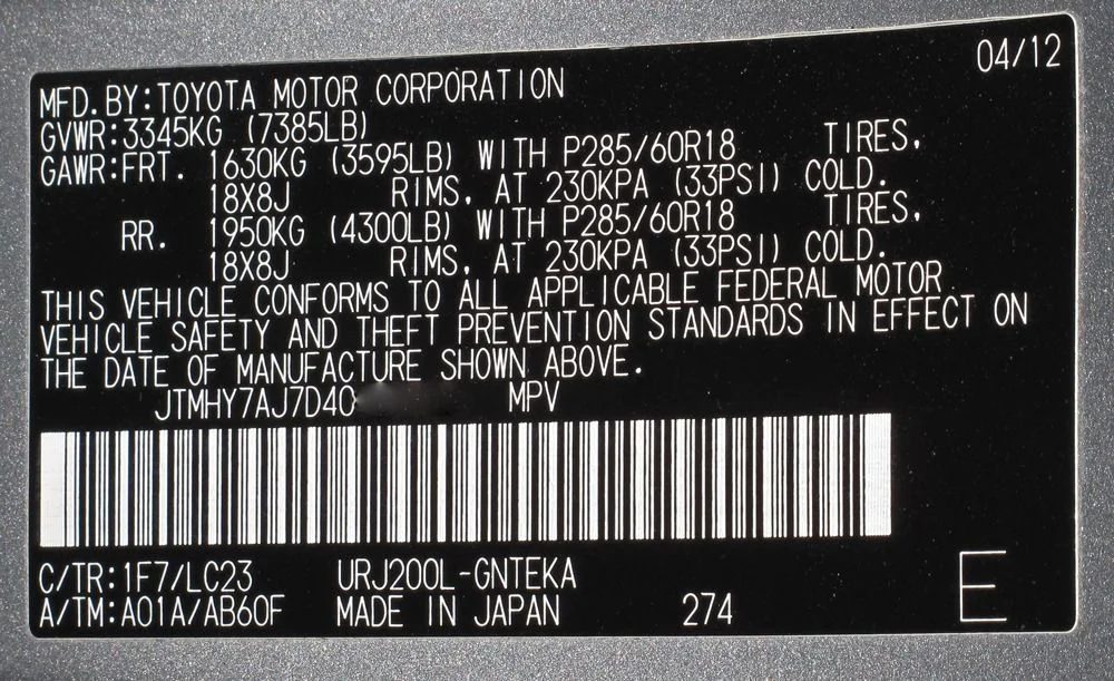

I looked through this thread for some ideas but I’m a bit unsure and this might be better for the SQOD thread but here goes. I’m running the original stock OEM Dunlop GRANDTREK AT23 285 60/R18 MSV M+S. I’ve been running 35PSI since I’ve owned my 2018LC, 15K miles on the vehicle & tires no problems. Max inflation is 51 psi.
I now have what I’m guessing is a 700lb* combined payload in the cargo area and roof. We’ll be doing normal interstate and city driving – nothing offroad.
  1. Should I air up?
  2. How much?
  3. Reset the TPMS for alarms if airing up?
Thanks in advance for any ideas.

If you check the information placard found on your Driver's door jamb, you will see info similar to this (from my 2013 LC200 for an example):
You should find on yours that the RCTIP (Recommended Cold Tire Inflation Pressure) for your OEM 285 60/R18 MSV M+S tires is the same 33psi F/R.
This is the cold inflation pressure Toyota recommends for all vehicle weights up to the GVWR (7,385 lbs) of your LC200.
1. There is no need to "air up" as long as you stay within the GVWR.
2. (See 1)
3. Reset your TPMS after setting the COLD tire pressure to the specified 33psi.
HTH
Many thanks!
I know about the sticker, and it's the same as mine - 7385 lbs. What I didn't know was if adding a few pounds would help with tire wear, heat etc...
The truck weight with me in it and a full tank of gas, no roof rack was 6160 lbs on a certified commercial scale.
Now with a loaded roof rack + cargo in the rear area + 1 passenger I'm guessing I'm at or near the GVWR.
Again many thanks.
