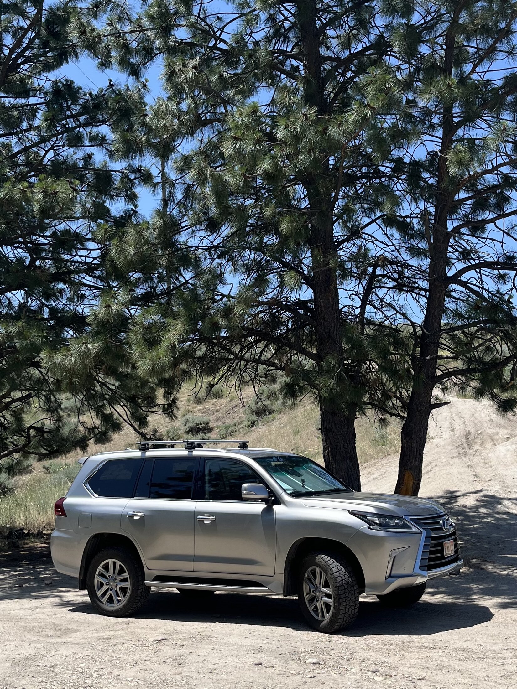

OP, I noticed you said you ski. I went with Falcon Wildpeak AT4W 275/60/20 SL. They are 3 Peak rated. I struggled with whether to go with a heavier load rating but wanted to maintain a compliant ride and reasonable tire weight and I already had the 20” rims. The WPs were impressive in the snow in Idaho last season. I ski 30+ days per season and drive up a windy mountain road to our local resort and road trip to Utah, etc. I will say the car does not love high speed mountain road corners. It will do it but leans a bit like the big boat that it is. Maybe a wider or stiffer tire would perform better in that aspect. (I was driving a BMW 325 wagon before, so that might affect my perspective.). Otherwise, very happy with these tires in town, snow, dirt roads, etc.

Not sure if the WP4s affected gas mileage. I wanted the 21s off as soon as I bought the car, about a year ago. Our last road trip, with a Yakima Box on top, driving 80+ on interstate with some dirt roads, I got MPG in 16s. In town it’s terrible, 10-11 mpg, but I do a lot of short trips - live 2 miles from work. I bike commute to balance it out!
I was in you identical boat, but I’m in New England. My LX is a part time commuter, and I wanted tires that could get me to the mountains confidently if it ever snows out here again. Full honesty, I also wanted a beefy/rugged looking tire. I swapped the 21’s for Evo Corse 18’s and 275/65R18 AT4’s SL rated. I’m very happy, not a single mod to make them fit. Plenty of snow grip, minimal tire noise, and slightly better ride. If I did it again I’d probably drop to 17’s. The LX has a pretty harsh rough road ride at speed. Not a fan of the stock suspension, but I have one more year of CPO.
