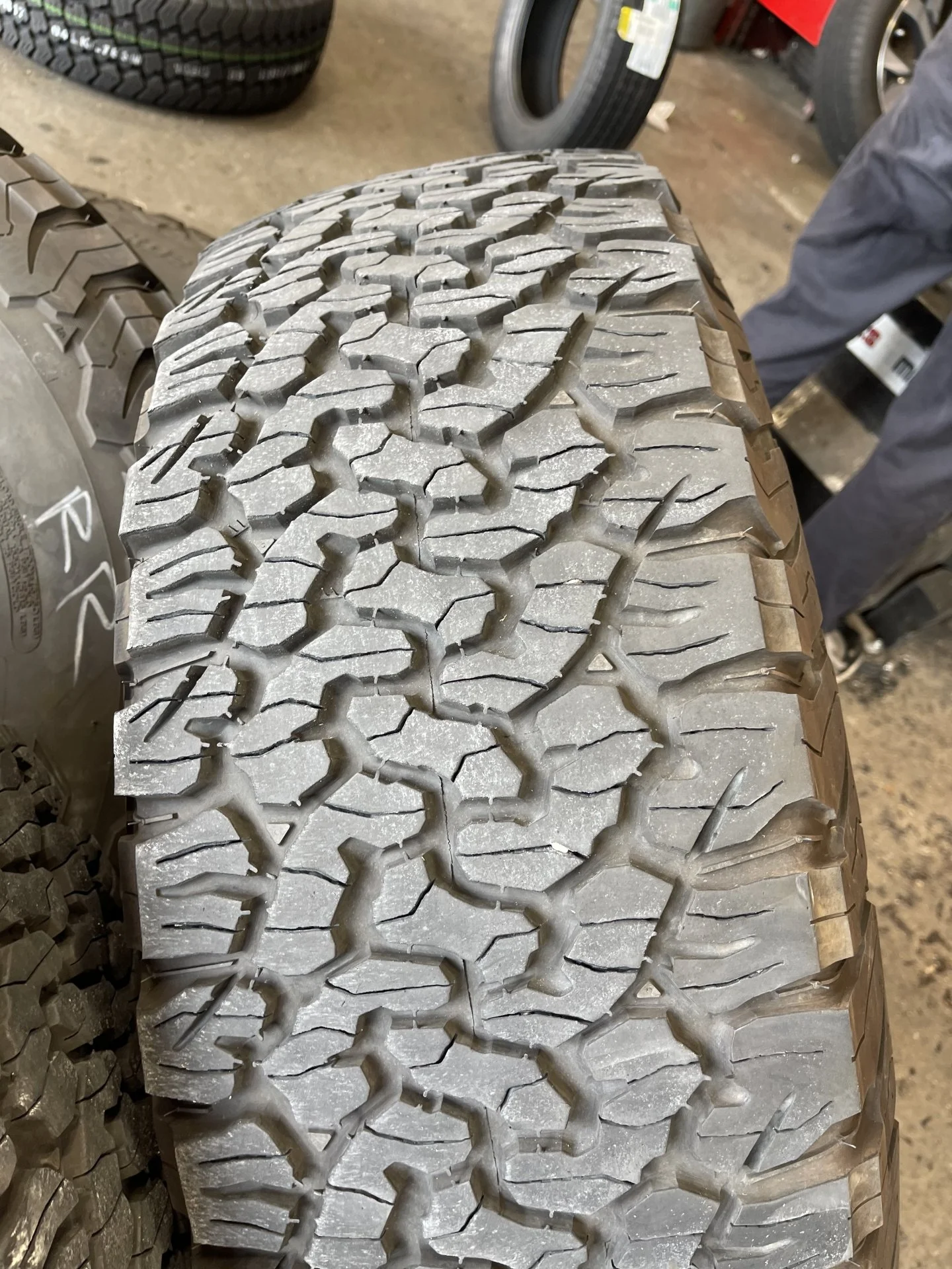

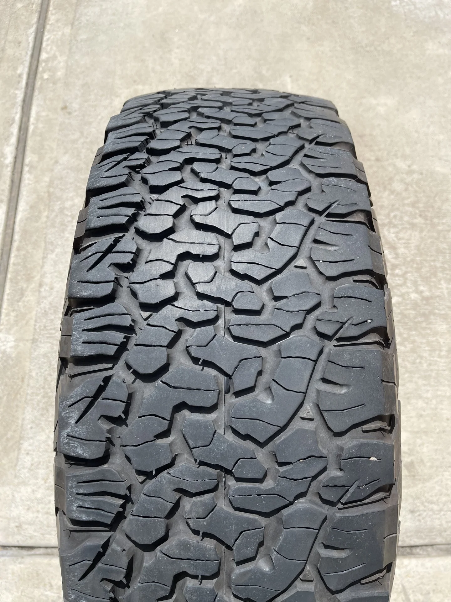

It might be hard to see in a picture, but my front KO2s have extremely uneven wear on the inner sides. I have less than 10,000 miles on them, and they have been rotated once.

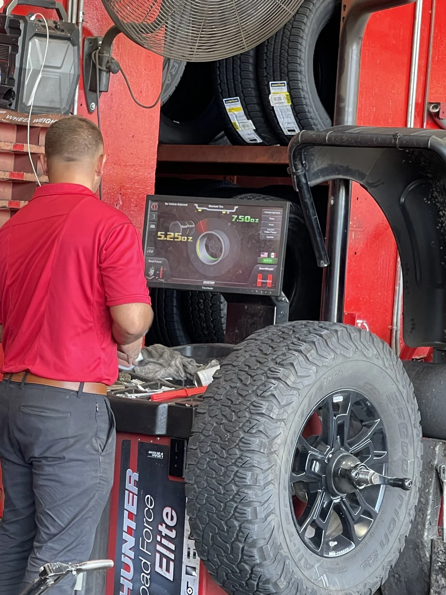

this is the driver’s side, and the road force balancing machine was so pissed it was throwing errors. The tech ultimately added enough weight to get it close (a lot of it), but any idea what’s going on here? Is this considered “cupping”?

Thats weird. Im gonna go on a hunch here and think if both fronts are wearing like this on the inner shoulder than my first guess is that your doing a bunch of highway driving and your AHC is lowering it out of spec and that camber adjustment is off somehow.

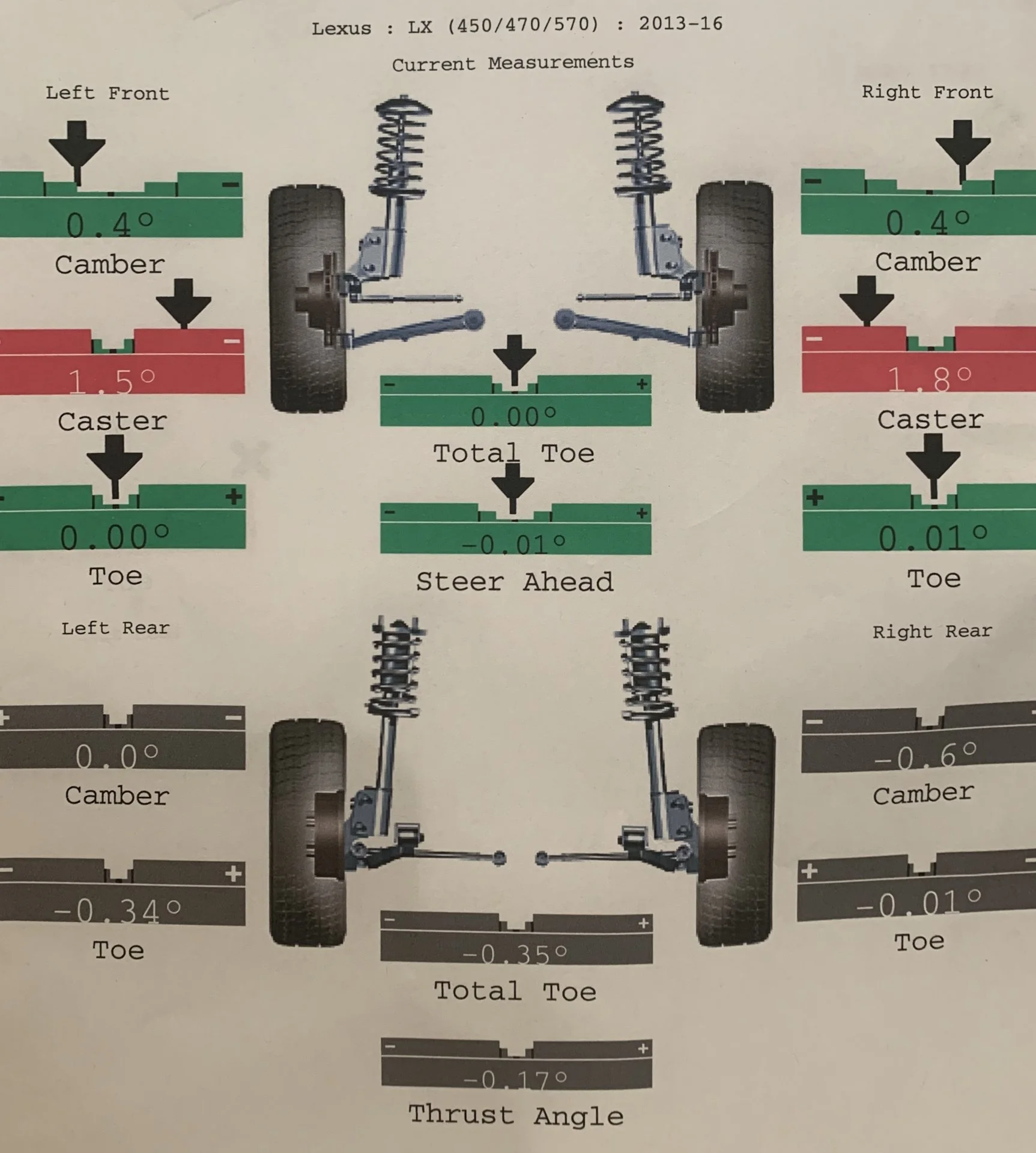

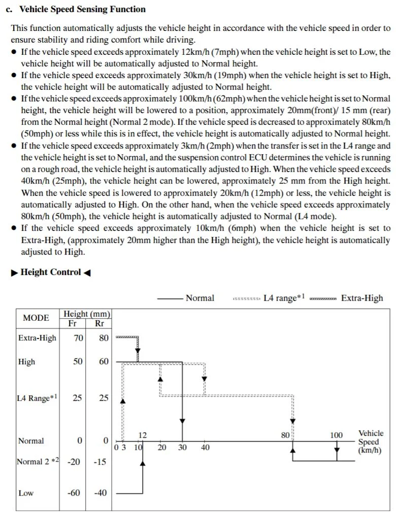

You make a good point, though. @doublehundy and I were recently talking about our alignments not being "toe'd in" at all. at 62mph, AHC lowers to "Fast normal", which is .75" lower than normal height.
Would a .75" drop be enough to put on that angle of wear? @Taco2Cruiser @TeCKis300 @linuxgod any thoughts?
Would .75" be enough to put on that angle of wear?

With the tire wear along the inside edge, the first thing I would suspect is toe out. Not sure if these tires have had a stint in the rear, but that also shows significant toe out, on account of the big lift. Not much you can do there. Short answer is I would dial in about .15 total toe in on the front axle to compensate.
I don't think AHC lowering has as much to do with this. Though generally, lifting the suspension will cause it to toe out. Lowering, toe in. At freeway speeds, it lowering prob helped a little but you still need more toe in. Likely other dynamics at work such as aero loads and toe steer actually creating more toe out at speed. That's how I read it at least.
Make sure that when whoever does the alignment, that the vehicle is in the Neutral suspension position, i.e. take it out of the entry assist function before handing it off to them, if you have it in that mode.
