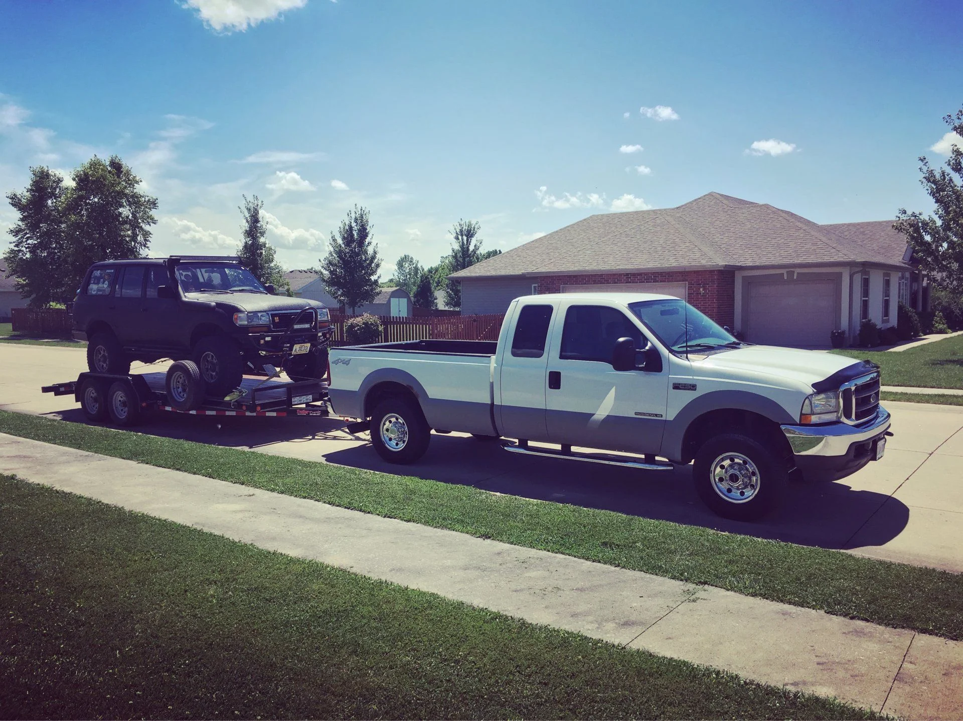

Mike this is where I got mine. 5k axles. I think it was 2300 bucks
All Inventory | Columbia, MO Utility and Flatbed Trailers | Trailer Trendz
