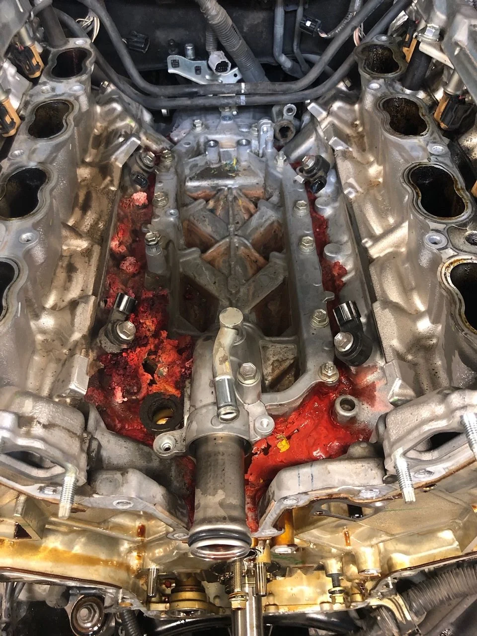

So I've just spent a large chunk of money to have all of the Tensioners, and other timing components replaced. Went ahead and had them replace the water pump while they had it appart. They resealed the leaking timing cover, and replaced a ton of Gaskets. Also the Valley Pan was leaking, here's a picture from it.
