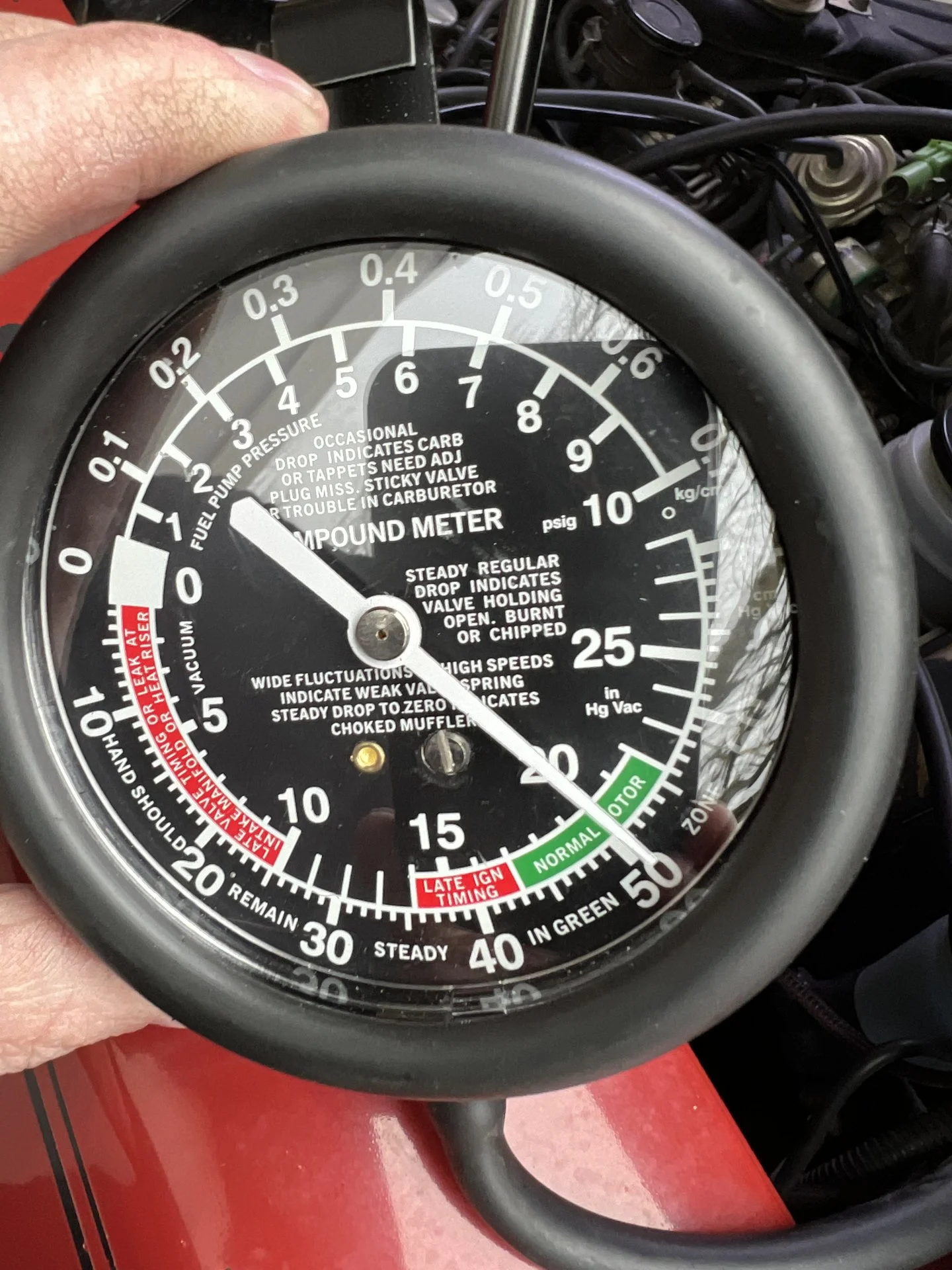

87 fj60 smogged. Did a lean drop with rpm and vacuum hooked up. With the timing set on the “BB” the vacuum gauge said “late ignition timing”. Like right on the line of late timing and normal motor. So like 17 per my vacuum gauge. If I advance my timing to 10 the vacuum goes into the green. Then I have to set the idle back down a bit. My question is. Do you set the timing eight to the “BB” or a vacuum gauge. Also my needle is bouncing a bit. From what I understand it’s a sticky valve? Thanks in advance!

I wouldn’t use that vacuum gauge as a guide to set timing.

The 2 degree advance I think was the best for my motor. felt responsive, no ping, idled smooth. My issue still is a low vacuum reading? Is that something that I need to look into more? and if the needle on the vacuum gauge is bouncing is that a sticking valve? I need to adjust my valves I assume. I might have a exhaust manifold leak too.
Low vacuum reading is a vacuum leak somewhere which leans out the A/F mixture which can create an overly hot combustion, which can lead to overheating the exhaust valves, which can warp, which will cause a compression leak, which will cause loss of compression, which equals loss of power.
Vacuum leaks on the 2F are BAD for this reason.
but if I turn my timing more advanced the vacuum gauge will go up. So I'm not sure what to think about that

Also as timing is advanced at idle, the RPMs will increase which will naturally increase vacuum just because of the faster engine speed.
