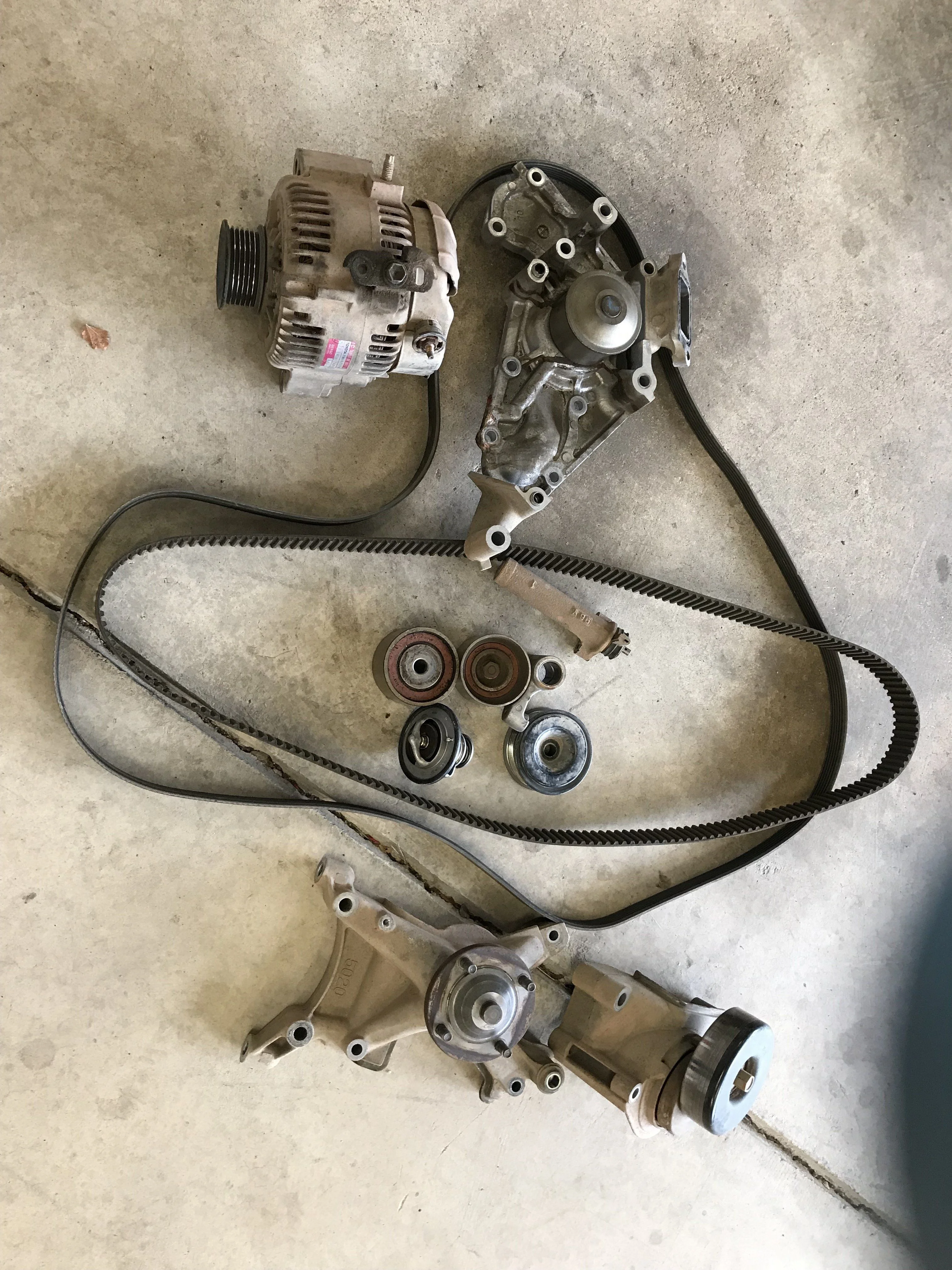

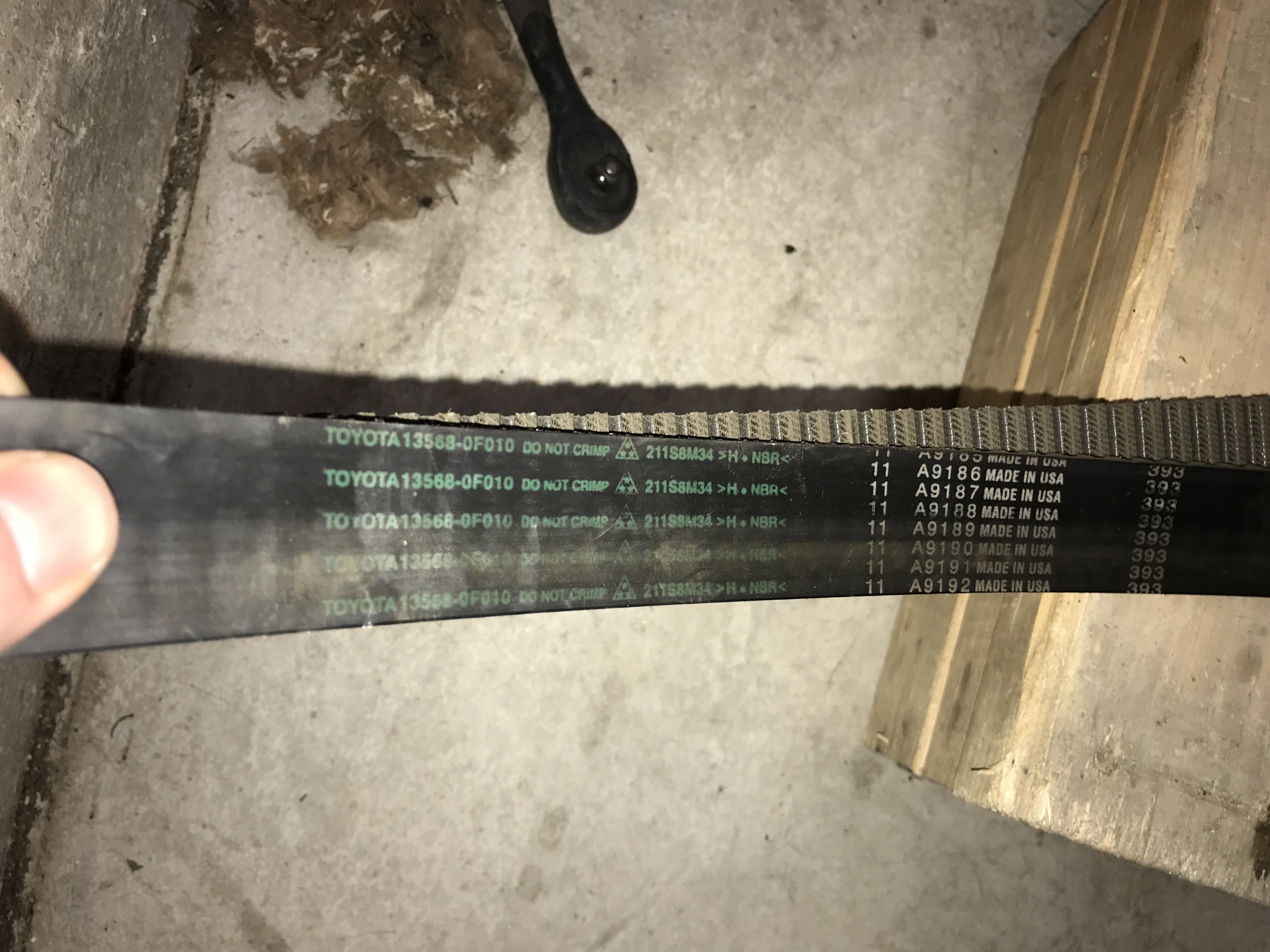

The timing belt still looked good. I think the water pump was end of life though. There had been leaking from the water hole:
Old Belt:
Alternators:
The new one looks smaller.
Work in process
It looked like a rodent had tried making a nest in the V. I fished all that out:
Pile of old parts:
