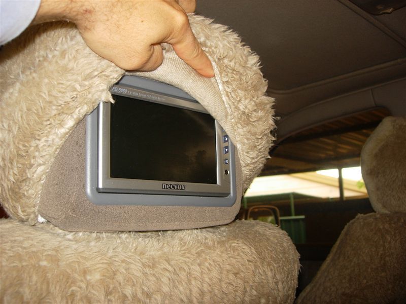

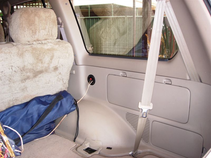

All the gear can go in the rear cargo area panels and rip out the Toyota amp under the drivers seat for either an amp or tuner. Install quick release speaker connection in your cargo area so you can remove the sub and wiring if needed. I have an amp and a DVD 12 disc changer in the side with the pocket (drivers side in Aussie version). I access the DVD from the pocket as I have simply unbolted the storage pocket from the panel and have the DVD close to the tail light mounted upright.

couple more shots

Looks very neat.
The Aussi version seem to be a bit different in the back. More "hatches" to open up.
On the right side, US version where the interior siding seem thicker, you have cup holders up front, and behind that, on top, a long fairly deep compartment. I store flashlights, batteries, and hazard triangles there. We do not have the lower compartment, nor the "vent" opening behind the wheel well.
What the cars have in common though, is that they are way to "delicate" in the back. I'd like to have good "rubber type" carpeting all over the cargo area as a factory default.

Yeah I removed the cup holder and installed the DVD controls and source controls for the rear head rests. I did have the deep pocket you are talking about but it simply unscrews from the inside and this is where I access my DVD changer and makes room for my amplifier.
