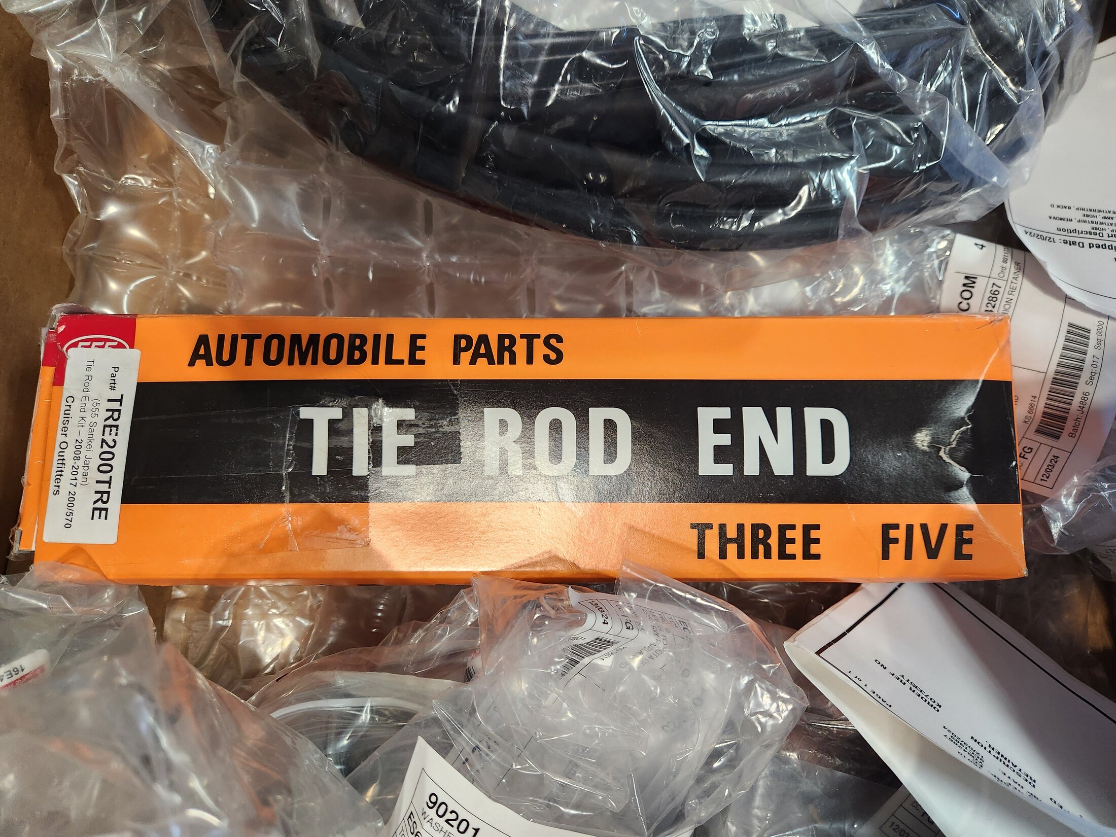

They are definitely on CruiserOutfitters.com and our ecommerce site, CruiserTeq.com
CruiserOutfitters.com: Cruiser Outfitters
The kits on CruiserTeq: Tie Rod End Kit - Fits 2008-2016 IFS 200 Series Land Cruiser & Lexus LX570

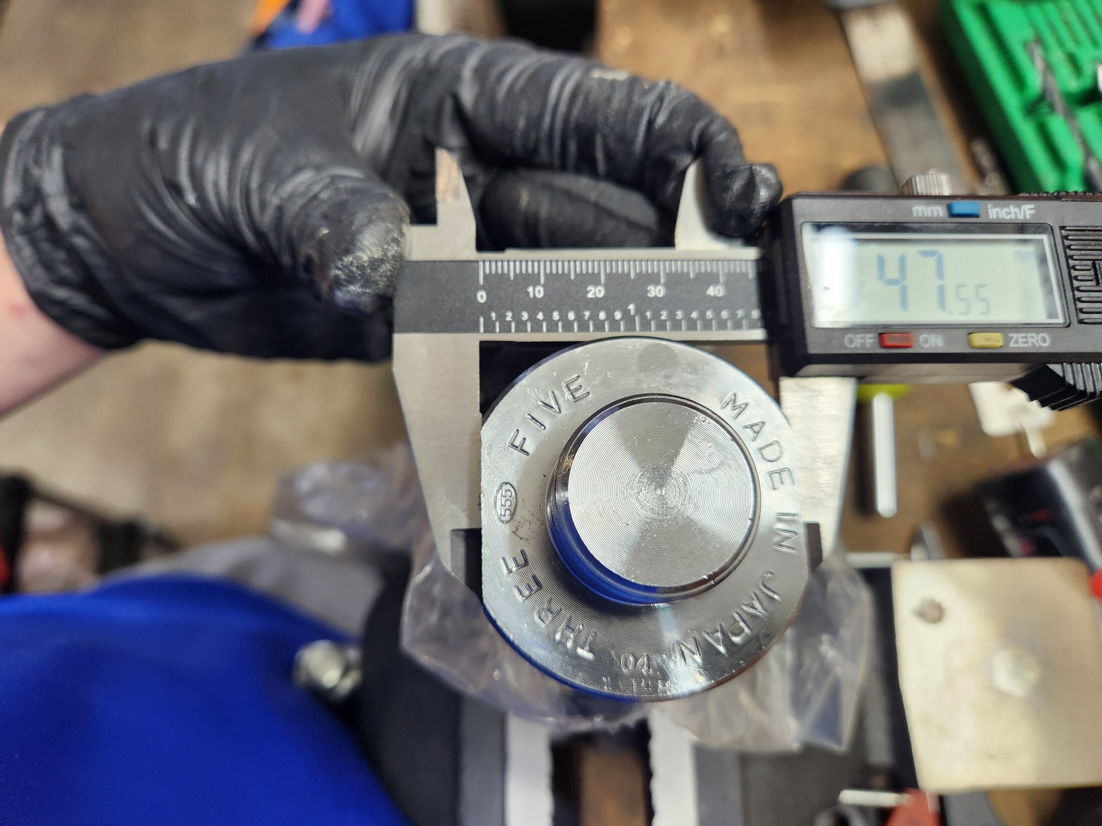

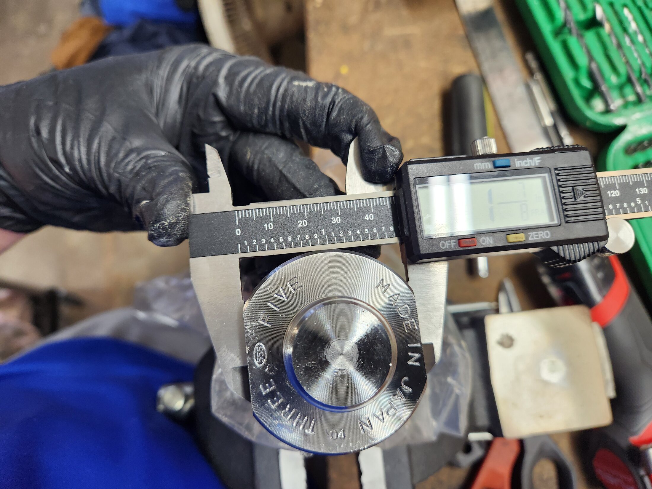

@Boston Mangler did you end replacing the inner tie rods when you were completing your front end rebuild? Trying to determine the size of tool I will need when removing them from the rack.
I have not done either yet. That’s on the list..
First phase was all the rubber bushings and such
I’ll likely do that when i get the Bilsteins revalved
I'll be at the shop today and am happy to pull a kit and grab any necessary measurements
