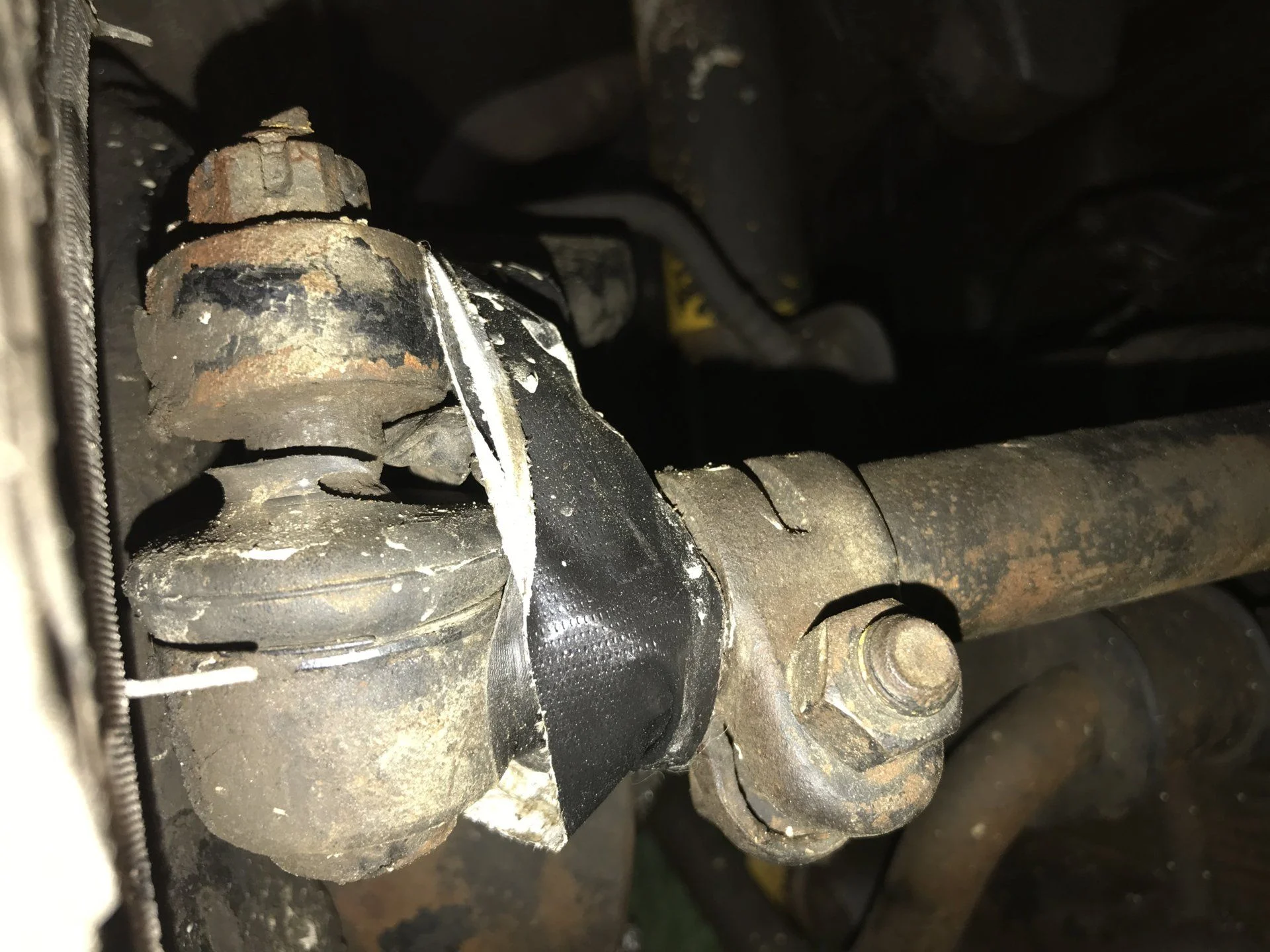

Tie Rod End broke does anyone know where I can locate one . I live in Halifax N.S. Canada .

Broke my Tie Rod end . Right side of 1987 BJ74 . Wonder if same might be found on other Toyota’s . Possible part number , or where I can get one .
Thanks
Yes, any leaf sprung 7* series from 84-90 and possibly later. As long as they are LHD or RHD to suit yours.
I'm also in Halifax (well Dartmouth) and am in the process of doing my tie rods with 555 ends that came with my truck. I've ordered from Cruiser Outfitters before with no problems!

Tie rods are RHD/LHD specific. However, Cruiser Outfitters quite likely stocks them.
Make sure the length of tie rod exposed thread is the same as the one in the other side.

We most certainly do :D
LHD & RHD kits for the 11/84-90 heavy duty 70 Series (BJ7x, FJ7x, HJ7x, etc)
LHD & RHD kits for the 11/84-90 light duty 70 Series LJ7x, RJ7x)
RHD kits for the 90-98 heavy duty 70 Series (and LHD kits en route)
RHD kits for the 90-98 light duty 70 Series (and LHD kits en route)
LHD/RHD for the 98+ 7x en route from Japan
We stock some of these applications in OEM too.
We've sold thousands of these TRE kits across the globe, fantastic results :D
