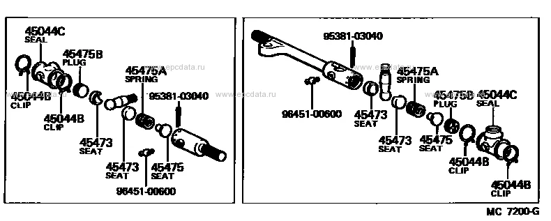

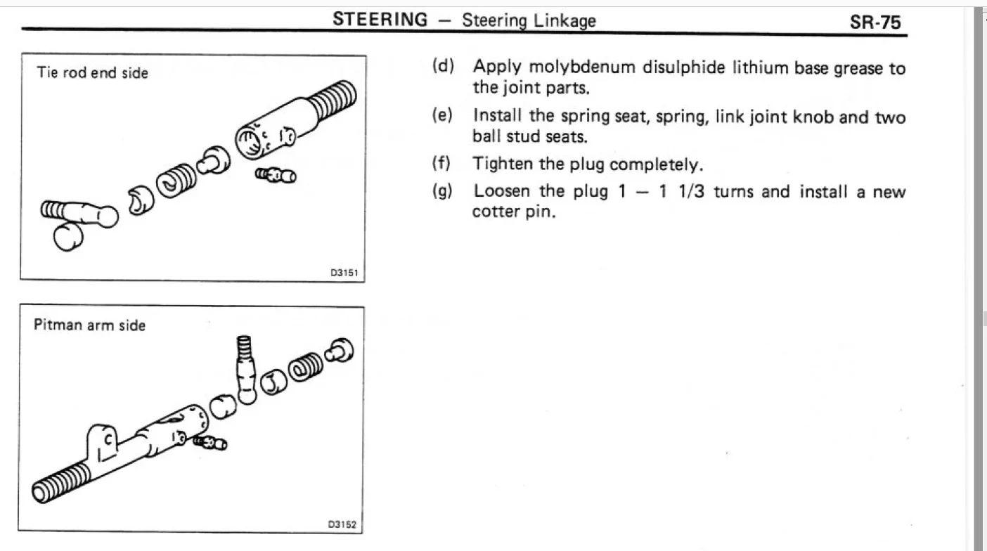

From the FSM it looks like the order of assembly of the parts is different depending which side of the pitman arm is being assembled.
As I mentioned above, if the whole assembly is too loose (maybe the spring has lost compression or is not tall enough, you can use a nickel as a spacer. I guess you would put the space on which ever side best centers the ball stud.

Also, looking closely at the diagram you posted, it has the seat 45475 between the spring and the ball seat 45373 which is not the same as in the FSM.
