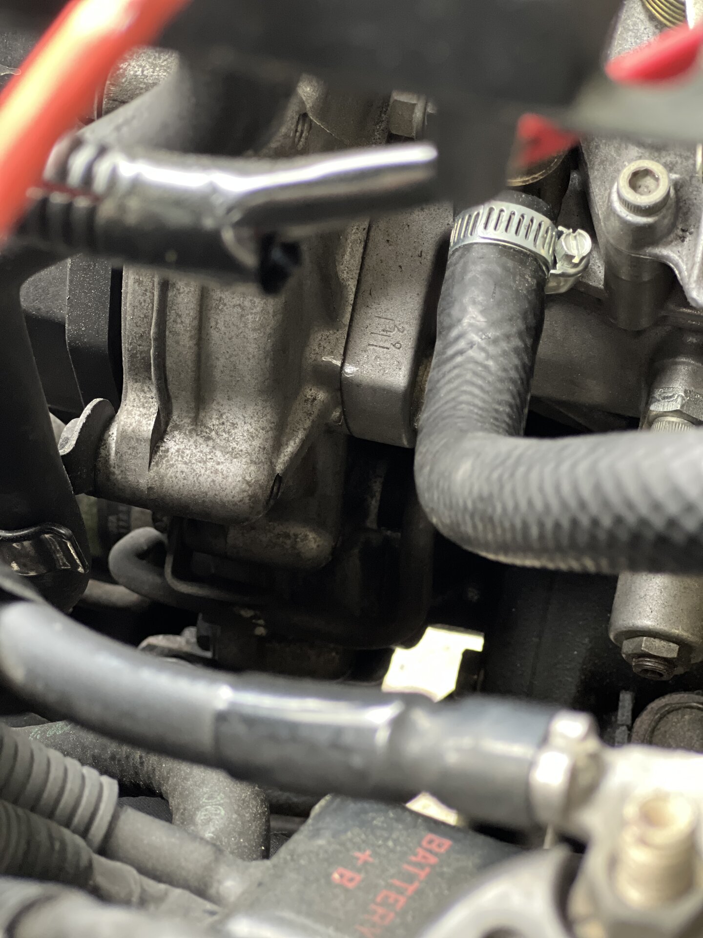

Finally got time/opportunity to mess with timing. Huge improvement with the first adjustment.
The etch on the housing was at the bottom end of the crude etch on the pump, slightly retarded it to the top. Was instantly quieter and smoother at the bottom end.

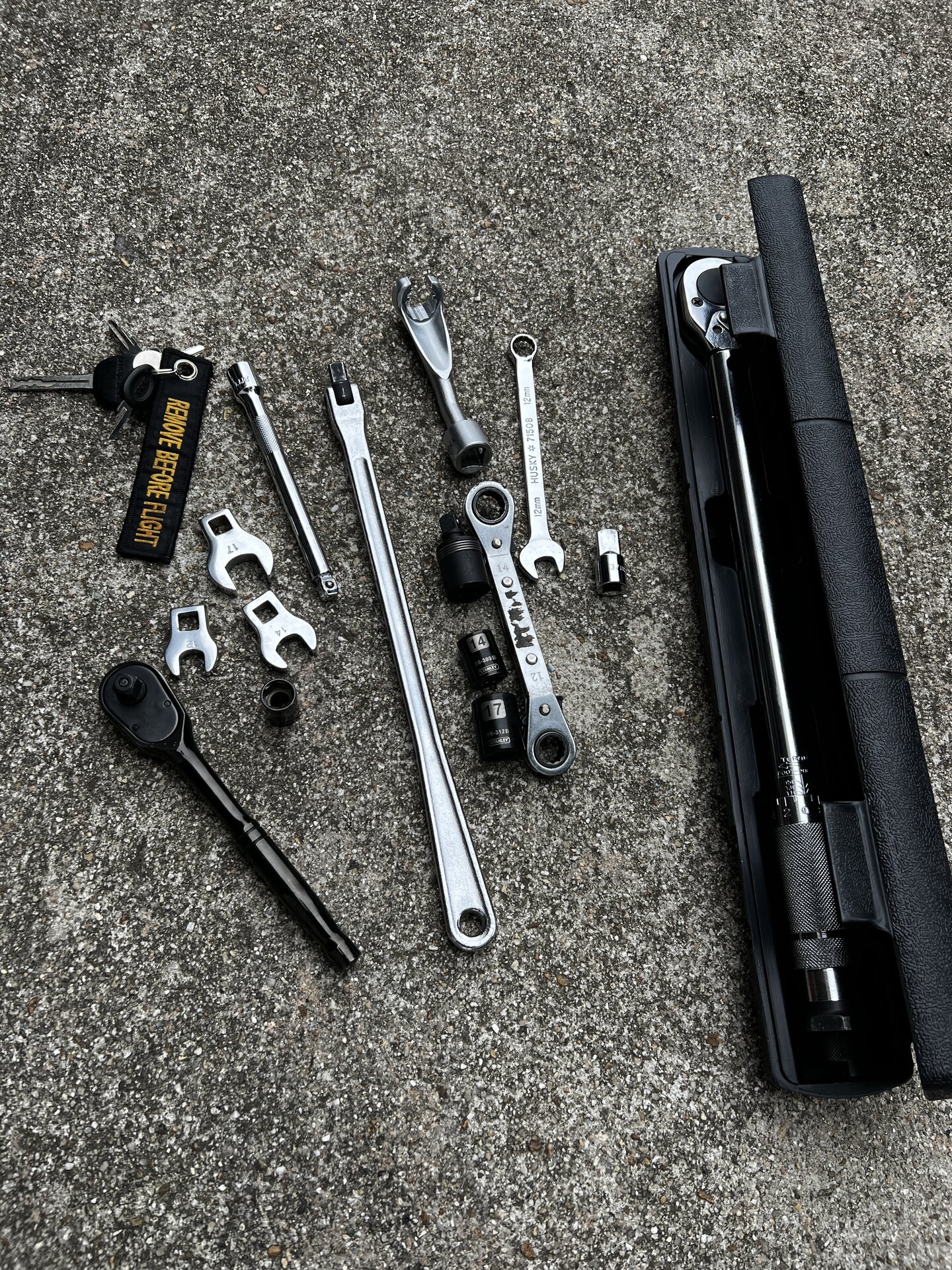

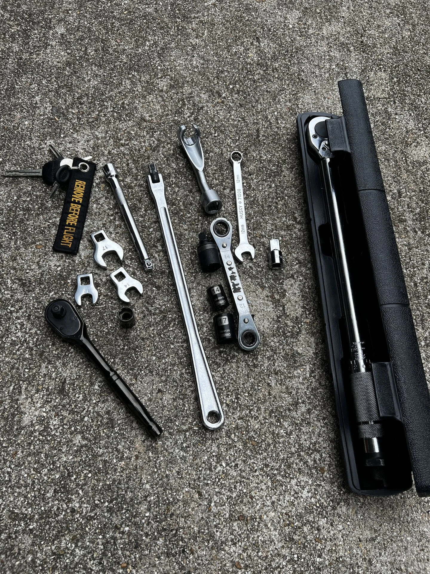

Plethora of tools used to do this…
