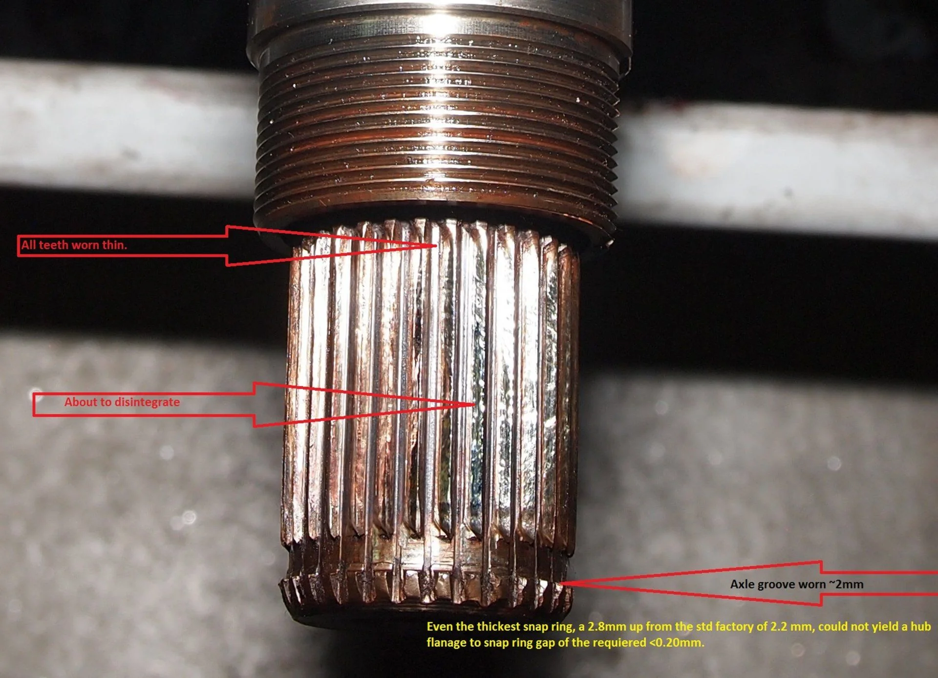

You can check your front drive shaft to hub flange play in many different ways. Here's one easy fast way wheels on the ground.
Most common D-N- R clunk.
New no clunk

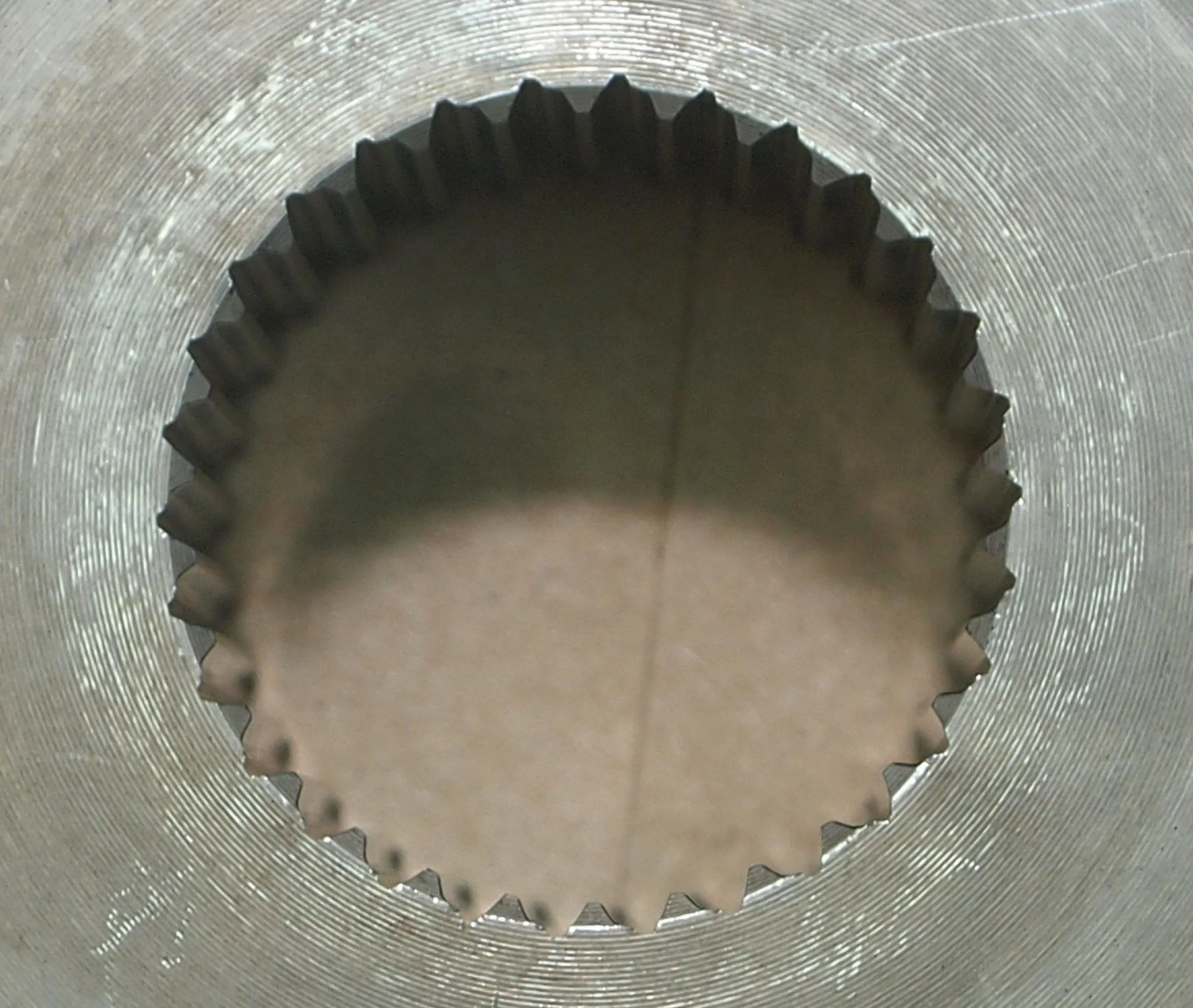

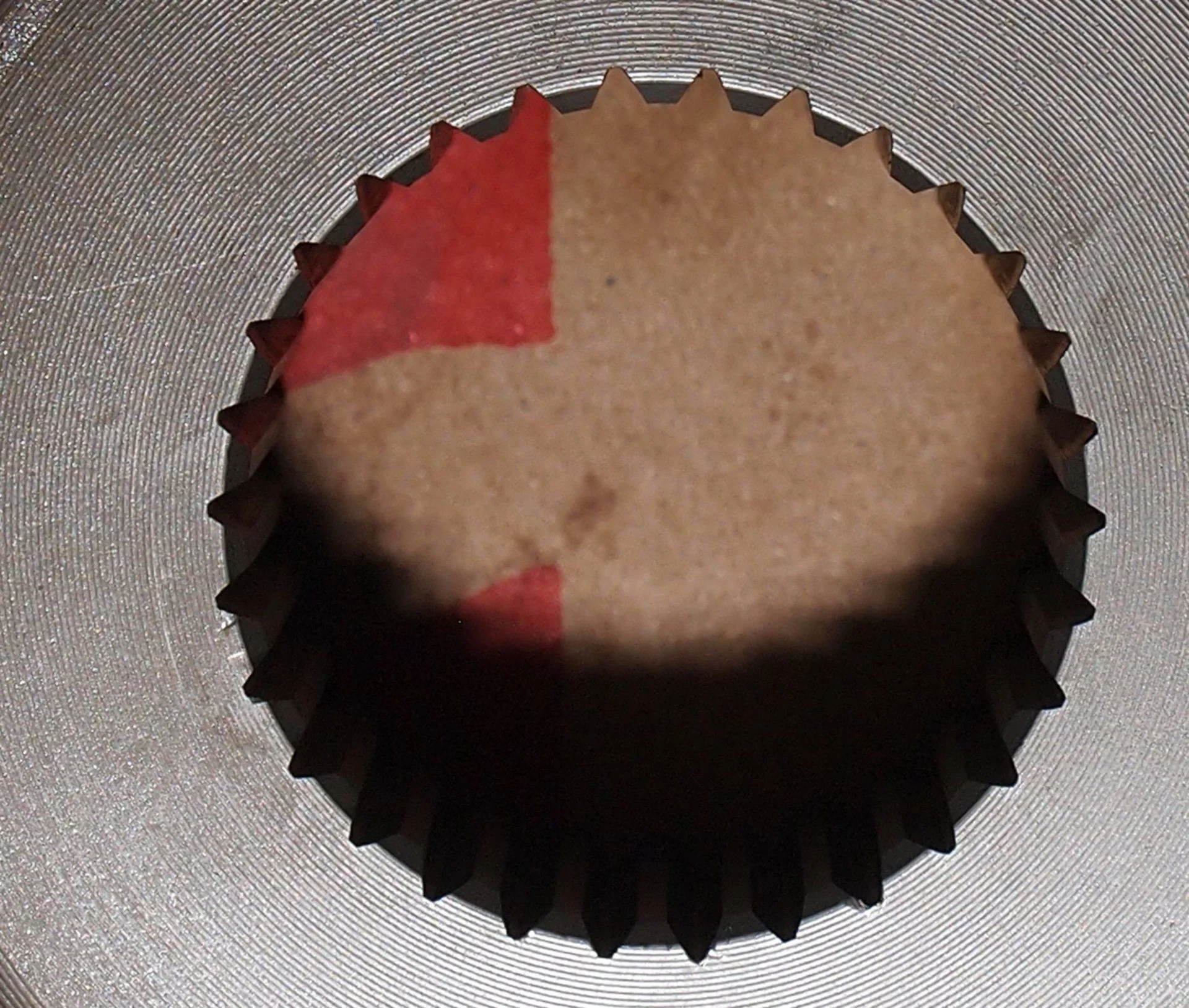

Worn hub flange and axle teeth/splines cause this. It's due to improper wheel bearing service.
Hub flange:
New OEM
Shot ready to fail. Front drive shaft outer axle splines/teeth

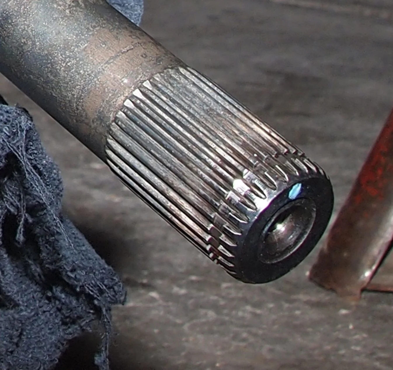

New OEM
