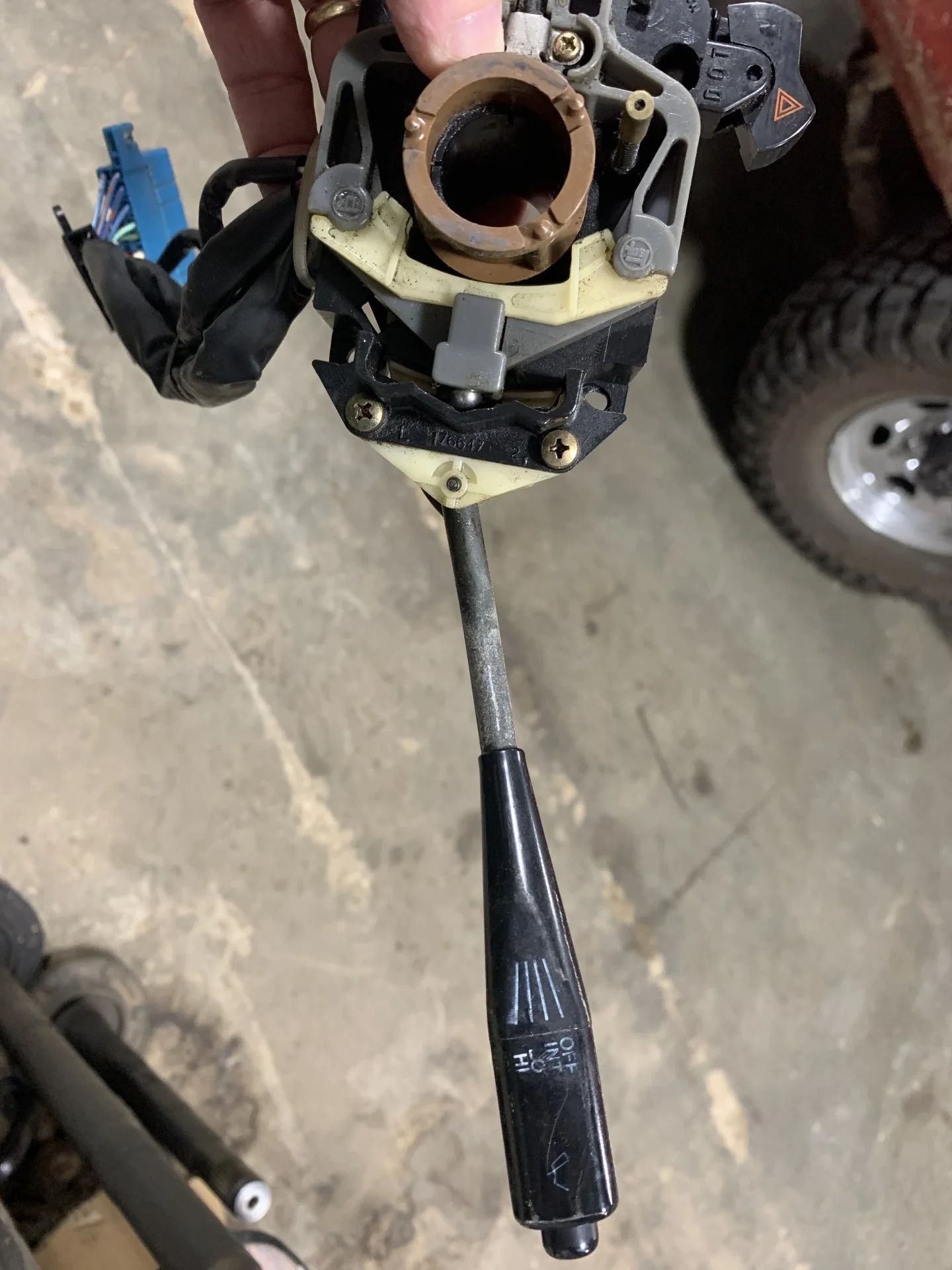

Pretty easy mod, but Im not sure why FJ60s dont have intermittent wiper switches. Picked up a combo switch from a 85 mini truck this guy was parting out. You can just remove the wiper arm portion from the center section where the hazard light goes.
Then you just unpin the wiper stalk from the 60 combo switch
You might have to bend the metal stalk part a few degrees so its spaced out from the steering wheel when its reinstalled. One careful cut to make it fit on the fj60 combo switch and repinning the connector and you are in business. All of the wires are the same colors. I used some zip ties to hold it together because the holes dont really perfectly line up. 5 months and no issues. When its all back together its all kind of sandwiched anyways.
Alternatively, you can just use the entire combo switch setup from the mini truck. It fits in there, but the hazard switch is vertical on the mini truck and horizontal on the 60 for some reason. You also need to drill holes for the steering wheel to catch the pins in the center. Unpinning was way easier
Its also a good time to fix the horn connection brass thing that looks like a 22lr shell. I just used the one from the combo switch from the mini truck i got. It was easily 4 times the size of the one out of the cruiser.
This, the repainted junkyard 4runner wiper arms, and the fj80 rear wiper arm done and probably will never have to think about any of it ever again

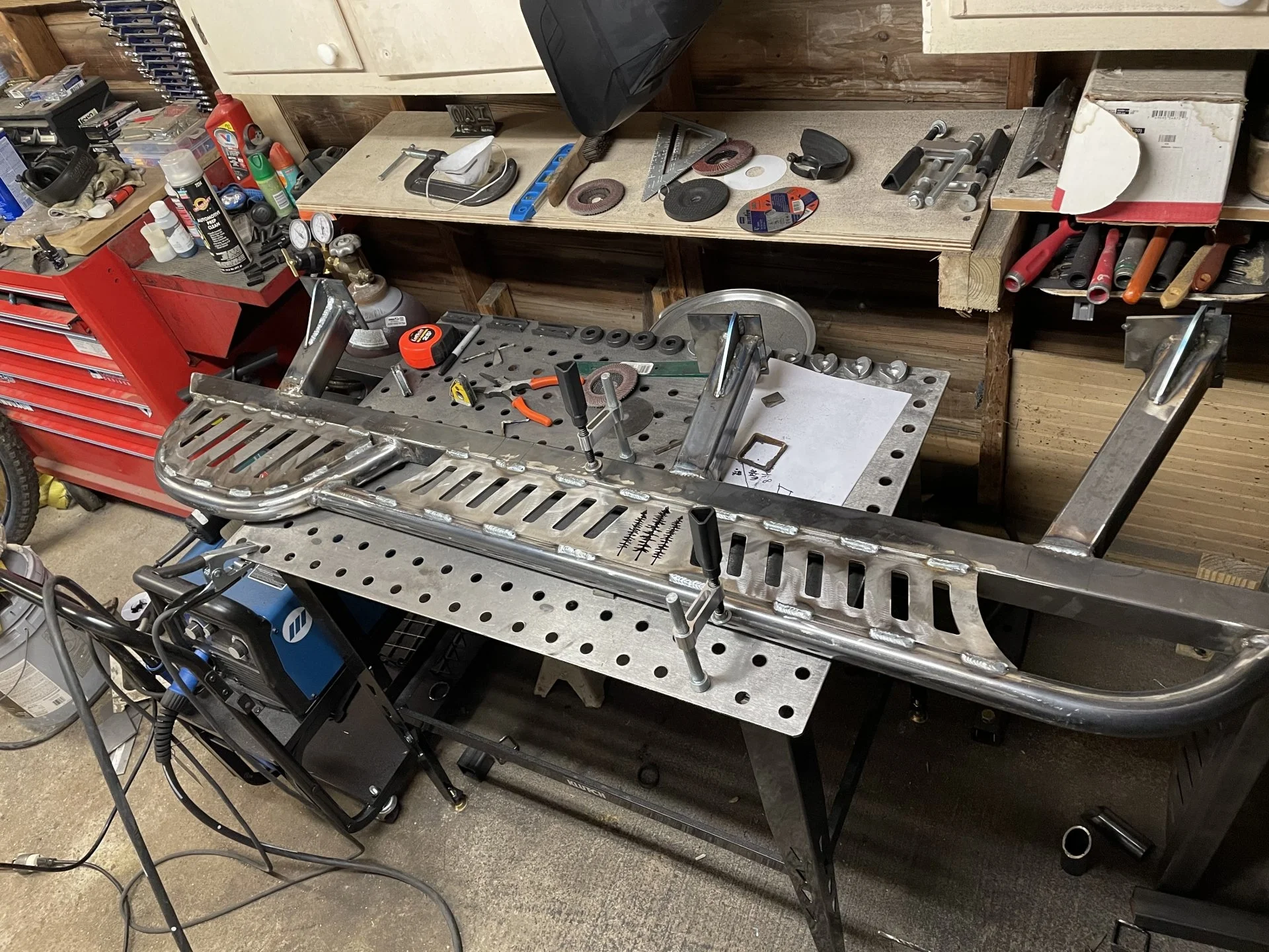

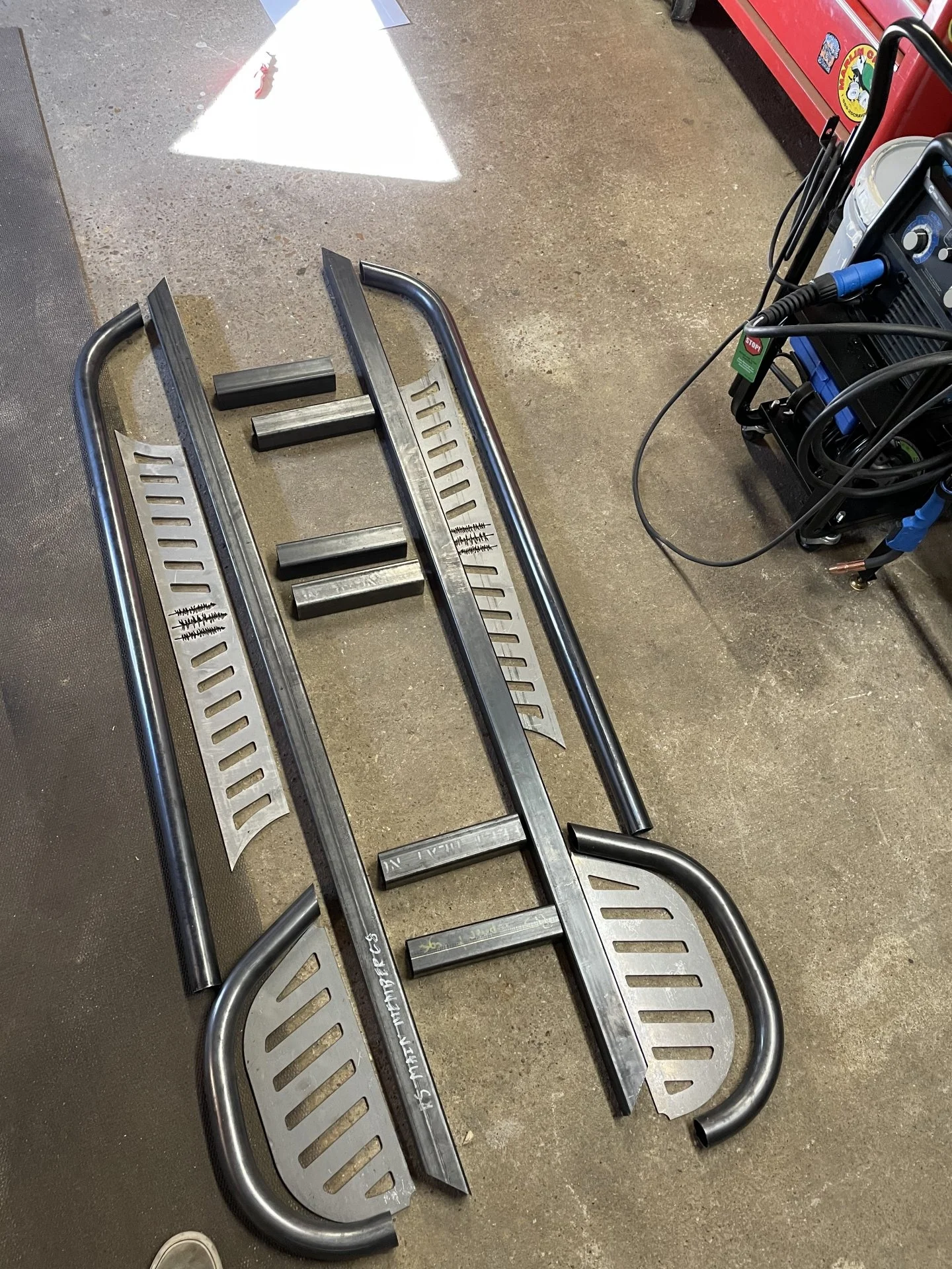

these guys want to be steps when they grow up. Center section leaves some to be desired. Seems like the 3/16 plate is the bracing for the tubing. Might add some pieces of tube to the center to distribute load better though.
Gusset where the posts hit the frame.
the kit came with some frame gussets hidden in a giant ball of Saran Wrap haha. It’s got some scab plates too. Got one of em down so far. Gotta figure out the leg angles and stuff tomorrow. I flipped the inner rail 90* because I thought it looked cooler. I think the angles on the end are supposed to face down and not out. Oh well

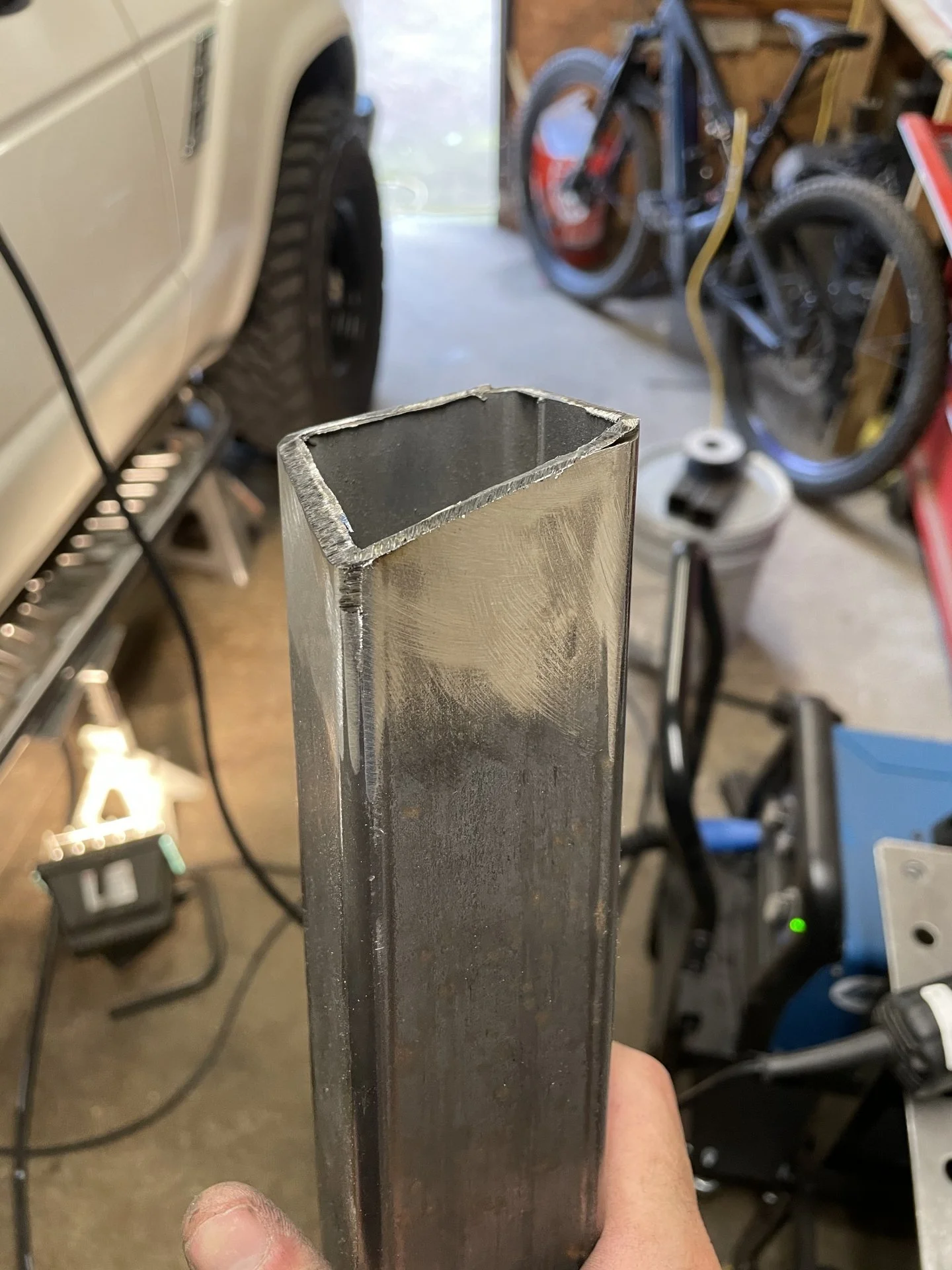

These are taking way longer than I planned. When I did my 4Runner sliders the frame was flat and the legs were a straight shot to the frame. The 60 frame is tucked up under the body and it bows in towards the front. Lots of cussing involved. And weird ass cuts like this for the legs

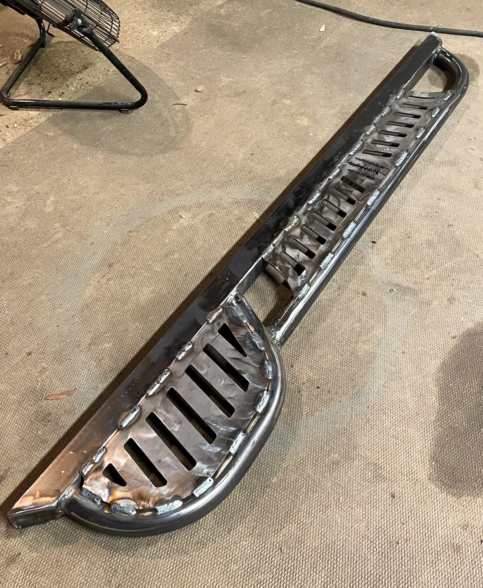

Some great welds and some really bad welds. Oh well. One side is done.
And some happy little Bob Ross trees...
Hahaha the wife likes the trees. its like 90% of the reason we got these sliders. 10% they have a step plate. If it wasnt for that these would totally be the trail gear ones haha
