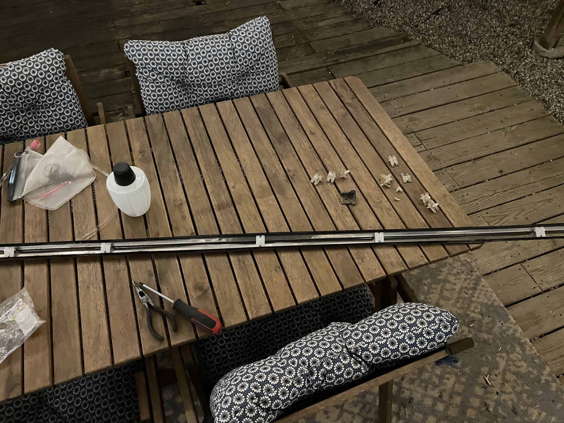

Hah. Biting fingernails is bad. But I also never get the black s*** and grinding dust underneath so it’s got it’s ups and downs

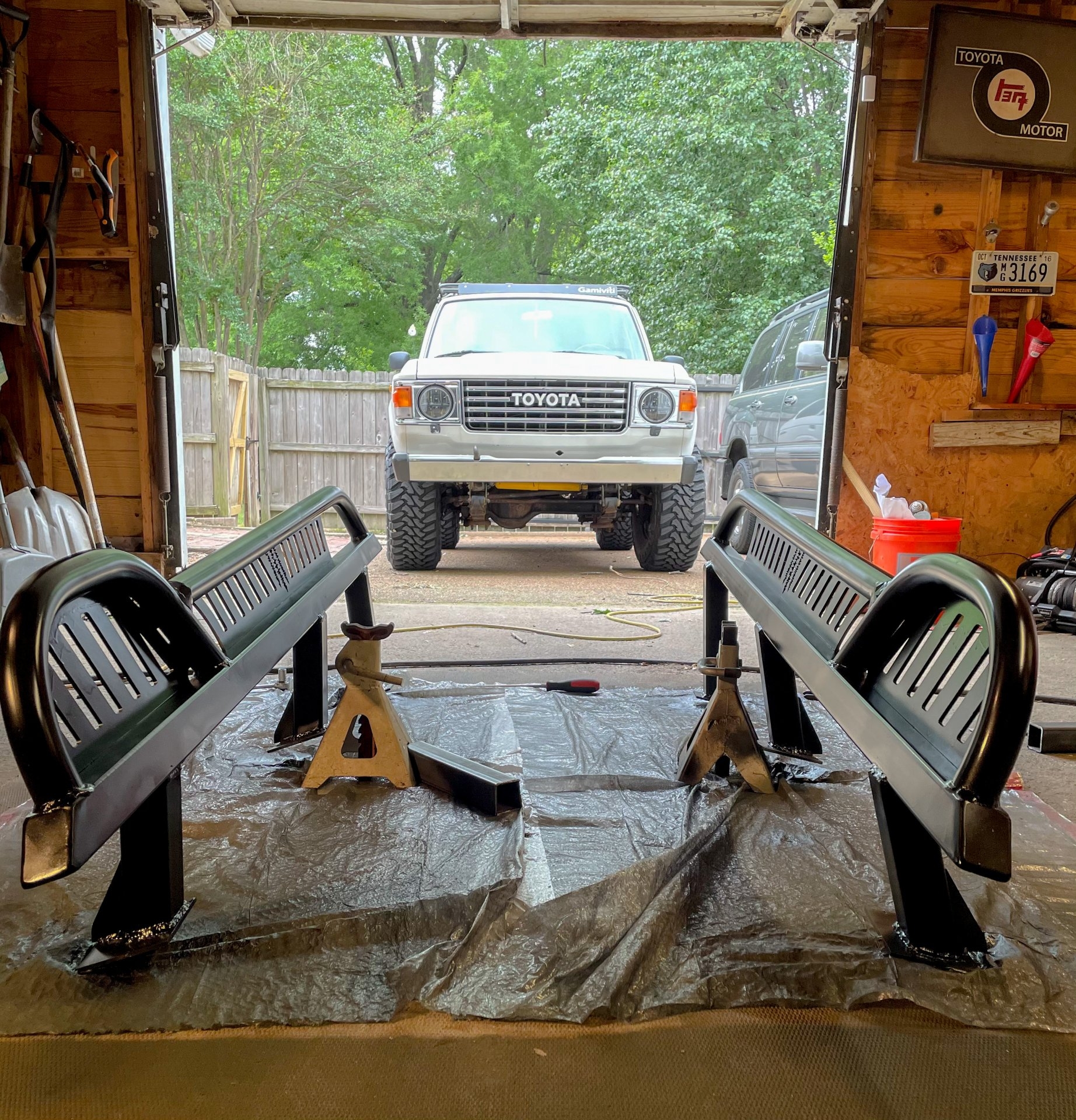

Fingers crossed that the legs didn’t warp while welding them up

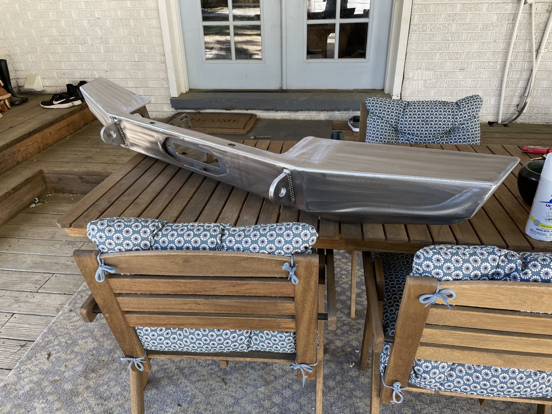

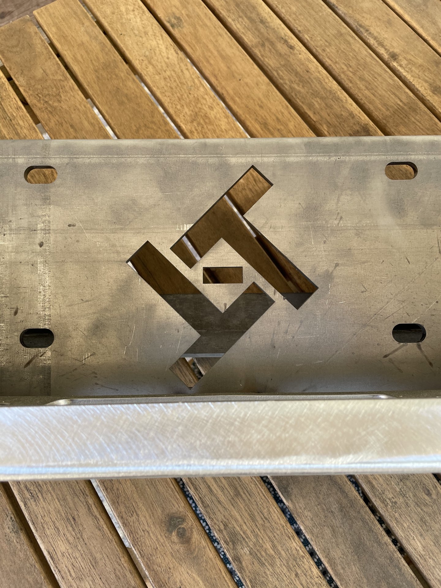

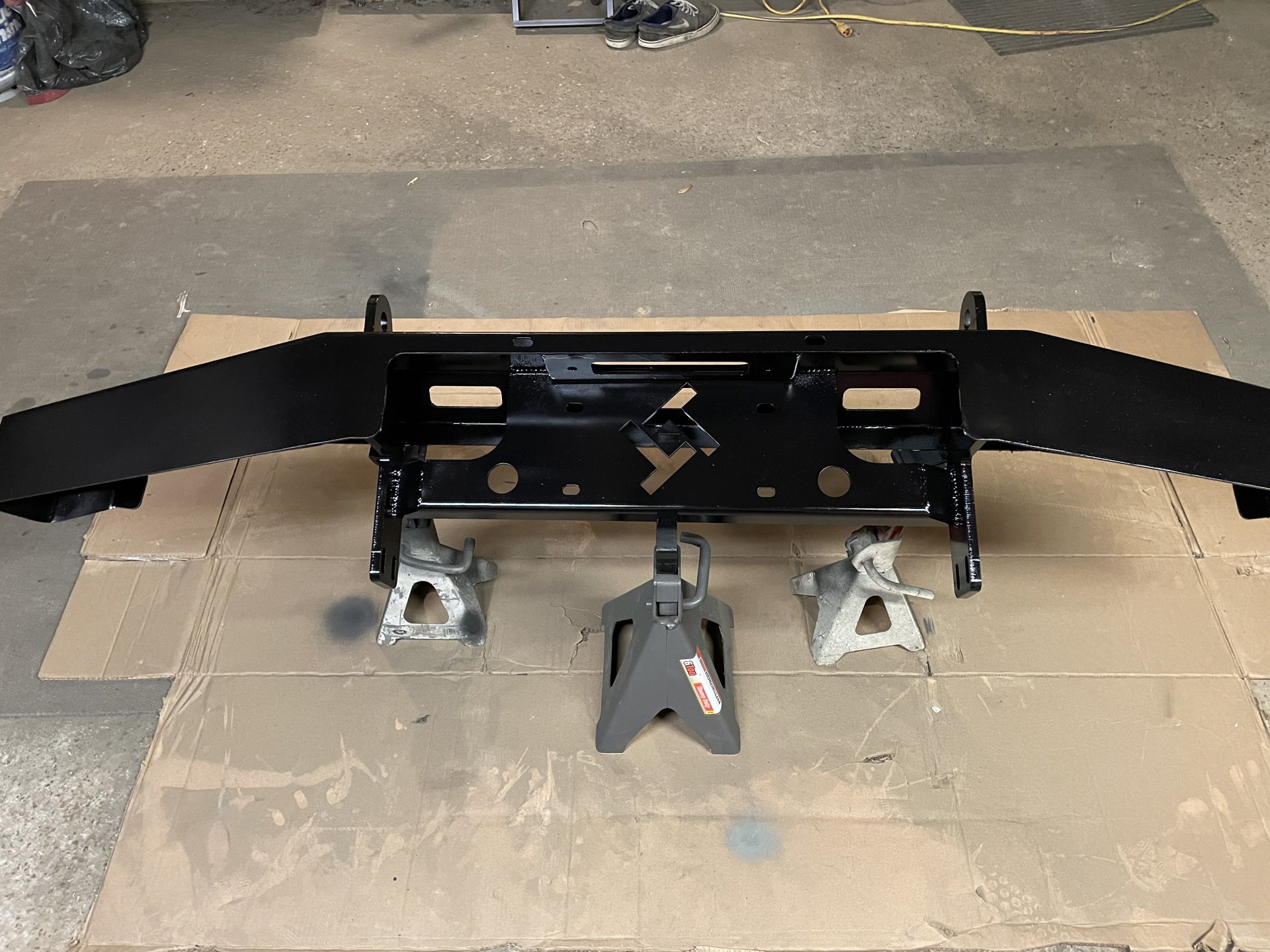

Oh yeah my @TRAIL TAILOR bumper arrived. It’s some serious bling.

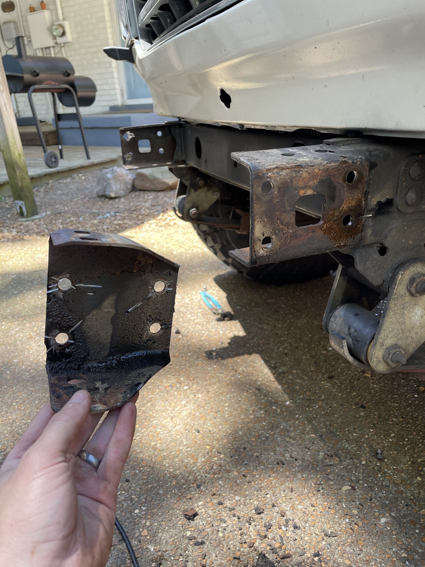

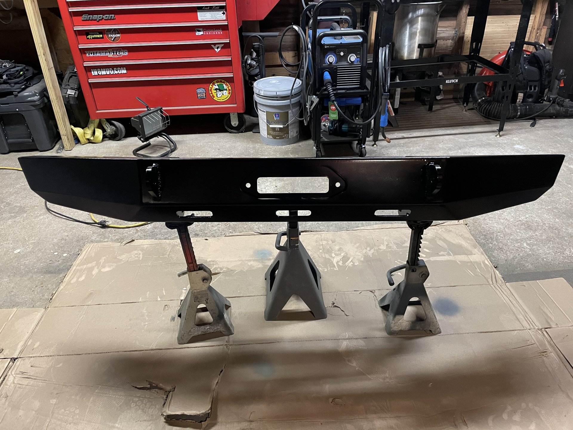

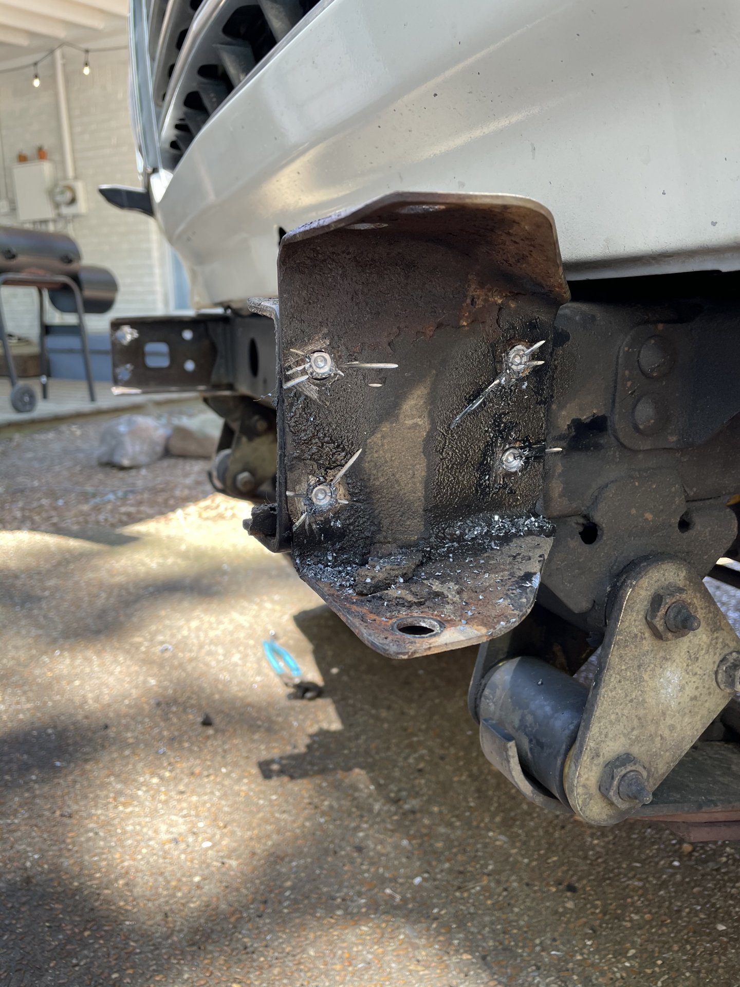

It got the rustoleum treatment and hopefully I can get the frame rivets out tomorrow to get it mounted up.

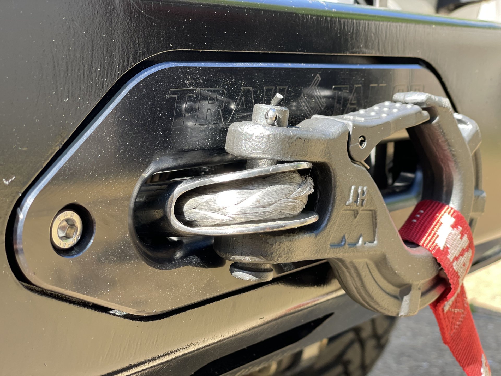

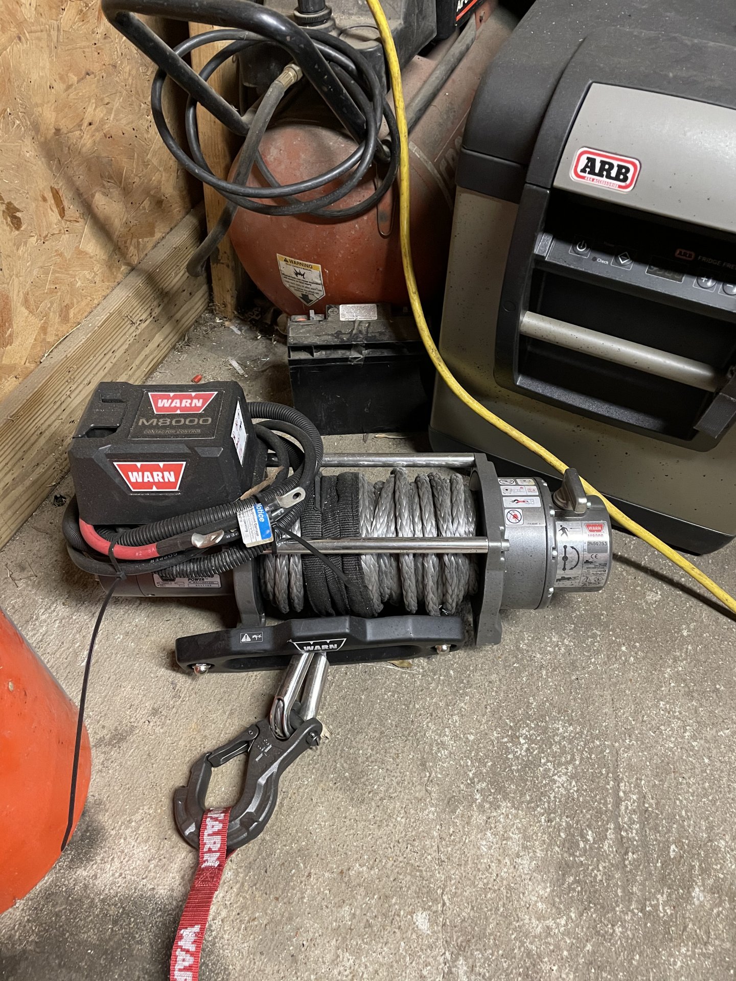

the fairlead is so freaking nice. It is a flush mount into the bumper. Kinda a shame that a little Warn M8-s is going to be behind it but whatever.
That is a sweet bumper.
Does it have any up/down adjustability like the later ARB does? It looks like it could be moved up a bit and close up the gap to the headlights and gain a bit of approach angle.
There’s no up down adjustability, but there is some front and back adjustability. The holes are about 1 inch or so long so you can tuck the winch in pretty close
I have one of those Warren Wenches and it’s plenty stout.
you’ve used the warren 8,000 on a 60? I was worried it would be underpowered. Most people use the 9.5 or 8274 from what I was seeing. I got the 8000 with synthetic rope for a price I couldn’t turn down from a jeeple here in town
I agree with Nolen. Unless you sink the 60 in mud up to its floor pan, 8K will be fine. Once you eliminate any air gap between the bottom of the rig and the mud, you might as well call for help.
If 8k worries you, carry a snatch block. 8k becomes 16k with this small magical device.
Yes. It’s fine. Just stay out of them Wolf River
you’re telling me you dont want to go wheelin down there in the bottoms here in town?
that makes me feel a ton better. The guy I bought the 8k from replaced it with an 8274 on his TJ. So basically no mud boggin in the swamps here in Memphis
That was my emergency plan so far. Figured the double line pull is a little more work but should work anywhere I’m doing single line
Also, for reference the 8274 is rated for 8,000lbs as well. The newer 6hp units are rated for 10 I think.

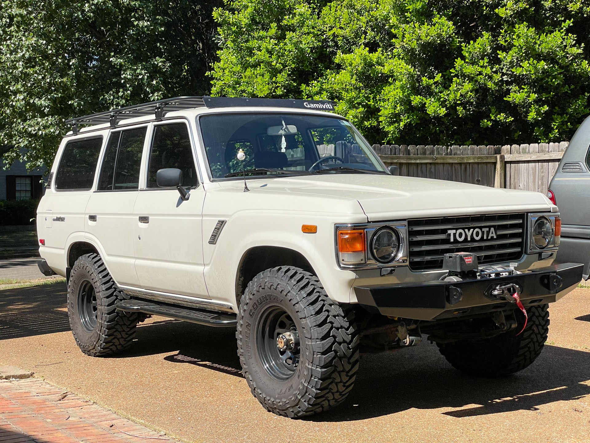

So after getting some armor going, my GFC tent finally got here so we went to LBL on the busiest weekend of the year to try it out.
This tent is really nice in its simplicity. Not many moving parts, super easy to use, and super affordable as far as RTTs go. The main reason I bought it is because it weighs about 80 lbs. I can put this tent on and remove it alone in my driveway with little to no effort and no help lifting it up onto the 60. Just get it on the back and slide it up and youre done. I dont really have any interest in having a tent on my truck all of the time so this is nice.
