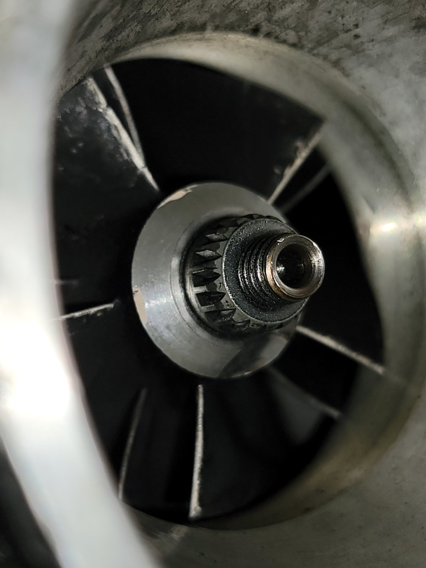

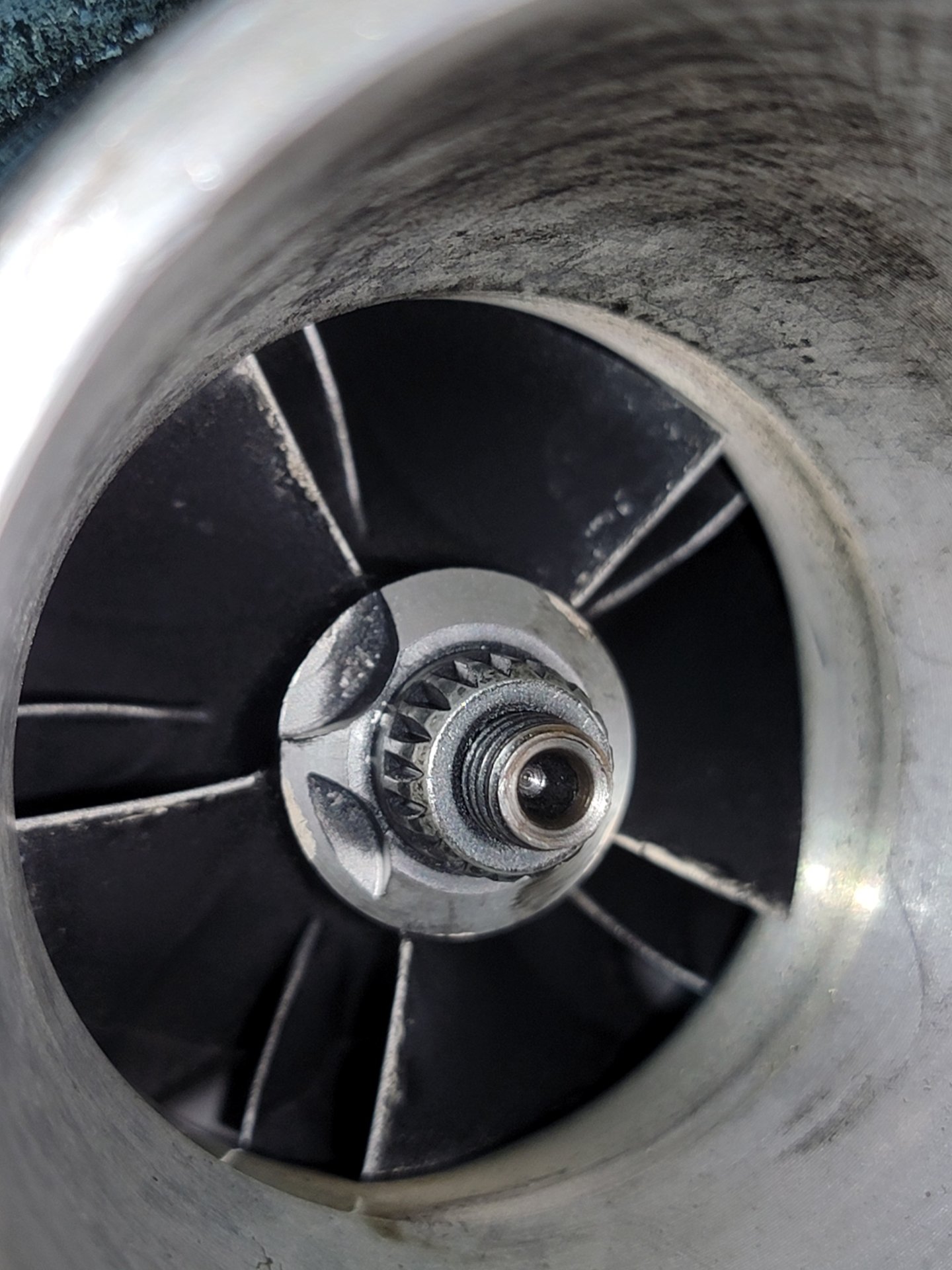

I had the intake tube off to clean it out and noticed some damage to the the turbo blades
That first photo is no go for me.
I'd be parking it, and swapping it out ASAP.
Do you have a shrapnel collection device on the intake?
If it lets go and you don't have an intercooler, plan on a full engine rebuild.
I had a turbo disintegrate, and had beads and chunks of alloy impellor throughout the engine.
Also look at play in the shaft. A tiny bit of play side to side is ok, any play in and out is an absolute no.
Regardless, I wouldn't run it. If you want to roll the dice, check the shaft play.

I've run worse. I've also cleaned them up with emery with no ill effects (total balance change is negligable as long as you're careful).
I'd be more concerned with what went through it. You have filter issues and maybe now engine issues.
It may have had filter issues at one point perhaps. I know it doesn't know. I've only had the rig a year. So I honestly don't know how old those marks are.
The engine runs fine. Starts quickly. Has good power. Doesn't smoke. I'm not concerned with the engine.
Also from a local cruiser group i found a shop locally I'll hit up too

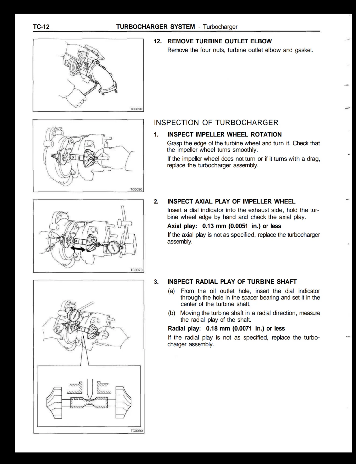

This is incorrect and not how journal bearing turbos work. You will always have some in and out play (axial play) by the design of the bearing system, it'll never be zero. The specs for the CT26 allowable play is 0.13mm axial and 0.18mm radial or less.
Any little groves or markings indicated something has gone in contact with the blades. Recommend to replace and upgrade.
No upgrade. I'll have it rebuilt.
You're literally splitting hairs.
If you can feel axial play, it exceeds you 0.13mm (human hair is around 0.12).
My understanding is that Axial play is more likely to allow the impeller to contact the housing. Changes in boost and exhaust gas pressure push the shaft back and forth axially.
If a compressor floats forward and contacts the housing at 100,000 rpm, you're left with shrapnel.
Thrust washers do wear and fail.
Radial play is more forgiving and better taken up with oil film in the journal bearings, so less likely to contact the housing.
Radial play is measured at the shaft centreline. 0.18mm play at the shaft centre line could be a lot more at the impeller due to leverage ratio. Which is why a small amount of radial play can be more easily felt, and slightly less of a concern than axial play.
From the 1HD-T FSM
I can most certainly feel the axial movement even when it's still within the 0.13mm tolerance. Pretty easy to feel and get used to the movement actually, you'd be surprised by how little movement you can actually feel. But I guess if your hands aren't very tactile or getting old it'll be harder to feel but there's always movement which can be measured if not always felt by everyone.
