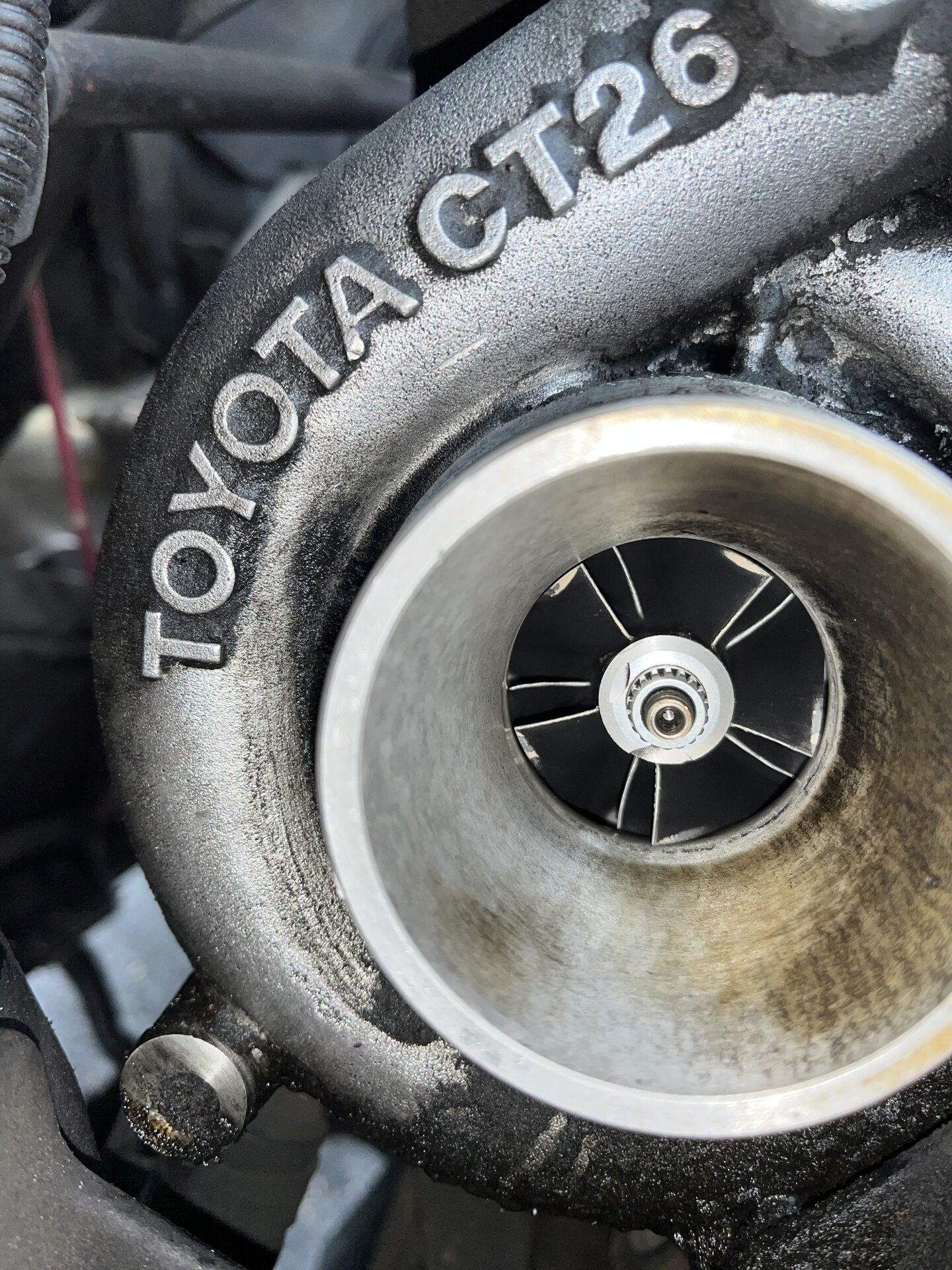

Thoughts on these turbo fins...
If it's catastrophic, I think you'll know it.
For me, it literally made a loud POP at 3500rpm. Huge loss of power. Cloud of smoke out the back. A bit of noise as the engine chowed down on chunks of turbo blades.
Fins made contact with the compressor housing at high speed. The compressor wheel disintegrated.
I managed to get mine off the highway pretty quickly. Engine started to run away within 30 seconds of the POP.
I stalled it out before it really got going. ( manual trans).
Happend to me almost the same way. Pop neir full boost. I had run away neir 5000+ I’m in a auto and I neutral dropped at first sign to stall. runaway scared me so I have a shutoff valve now on a pull cable
The only turbo failure I've had was funnily enough first seen as an EGT spike. I'm guessing because the turbine flow just got restricted. Boost drop and noise followed.
Mine had lost an oil line a week earlier which must have damaged the bearings. I drove around for a week and it all seemed good. Then almost exactly a week later at almost exactly the same piece of motorway the turbo gave me the finger.
I popped the wastegate arm off and drove home quietly on back roads. Turbo took a rebuild kit well and I'm still driving it over 15 years later.

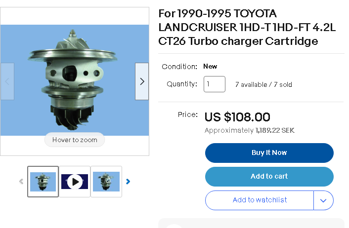

Almost bolt in, and most would consider it an upgrade (I know KiwiDingo won't).
Shipped to you would be close to your $500 rebuild price.
Very slight oil and waterline line differences, but OEM parts are available.
Intake pipe to manifold would need a solution.
Exhaust will bolt up.

Decided to take the intake hose apart today just to inspect……no oil in the tube, some grime, a lot of grime on the outside of the pipe. I wiped it all down with 91% alcoho. I reached in with a gloved hand and didn’t feel any movement forward/back or side to side.

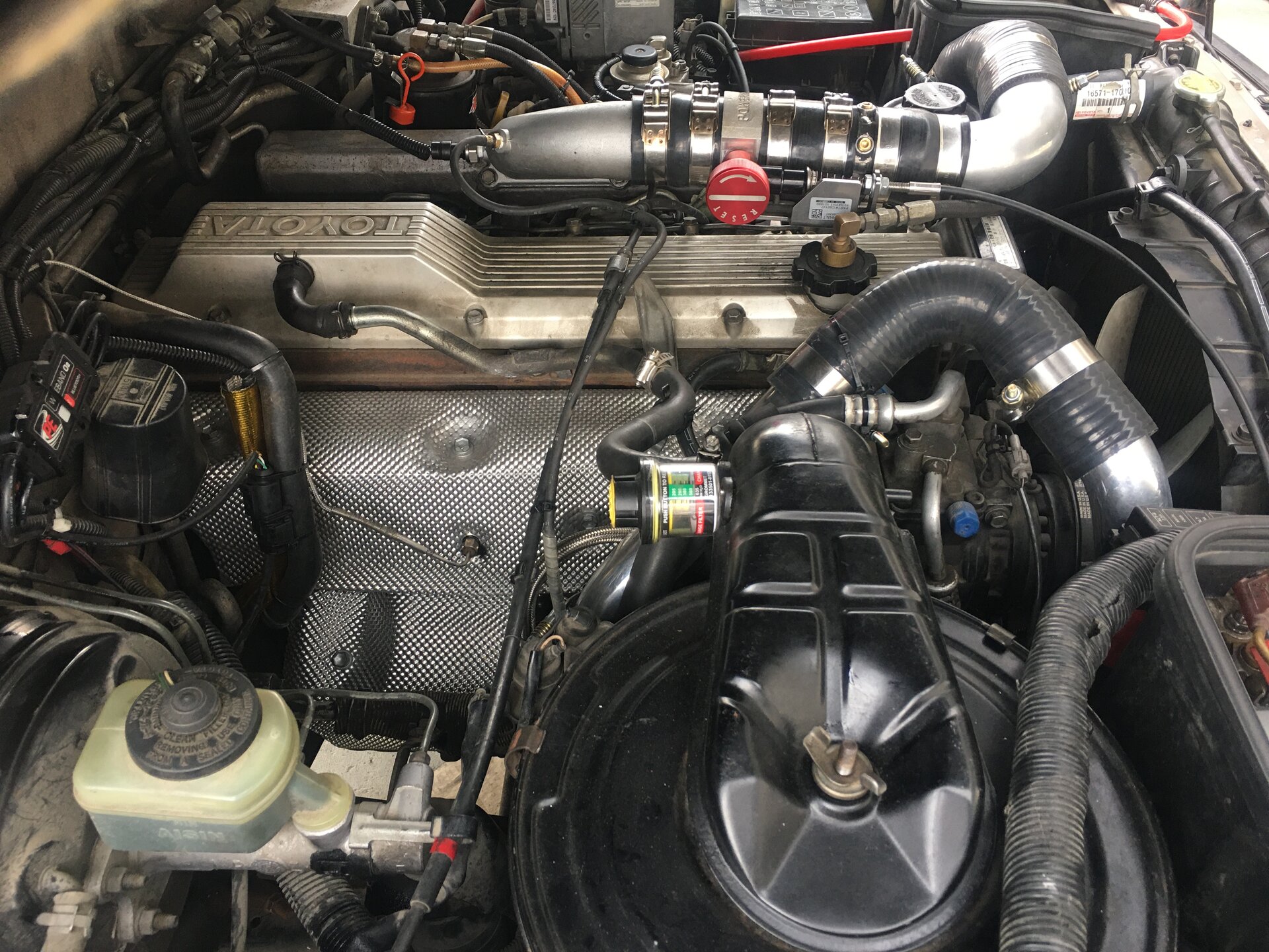

I have an accumulation of oil around the air intake. Is this a sign?

Also, seems tiny turbo failures can adequately destroy an engine... are they also exceedingly rare? A $500 rebuild at 300k km doesnt seem foolhardy.
get that crankcase vent going somewhere else,
that is fackin disgusting, and is going through the turbo, intake tract and into your engine.....
bj70bc: thank you for prompting attending to this wee but worthwhile project. Good for all.
The thread sums up that the vent gas should go into the void. Its corrosive acidic gas and oily unpleasantness.

A rebuild isn't my point
It's everyone clutching their purse and running to check their turbos because I posted a photo of my turbo. Which by the way I haven't touched yet.
This forum has a sky is falling herd mentality where 1 person has an issue and everyone all of a sudden needs to verify that issue doesn't exist. Regardless of how rare the issue.
Can a turbo fail and kill an engine? Sure.
Have I owned numerous diesels with 300k+ miles on stock turbos, yes.
I stand by my statement. A catastrophic turbo failure is rare. Damaged fins almost always come from something entering the intake not from wear. When they do come from wear it was from years of neglect that left to shaft play and compressor to housing contact.

A turbo can be neglected and abused. Abrupt shut down without proper idle time. Dirty engine oil. Improper air filtration.
All the ways people neglect an engine will effect a turbos health. They share the same oil. The same air.
Shutting a turbo vehicle down before egt's have reached an appropriate level can cause oil coking on the bearings.
