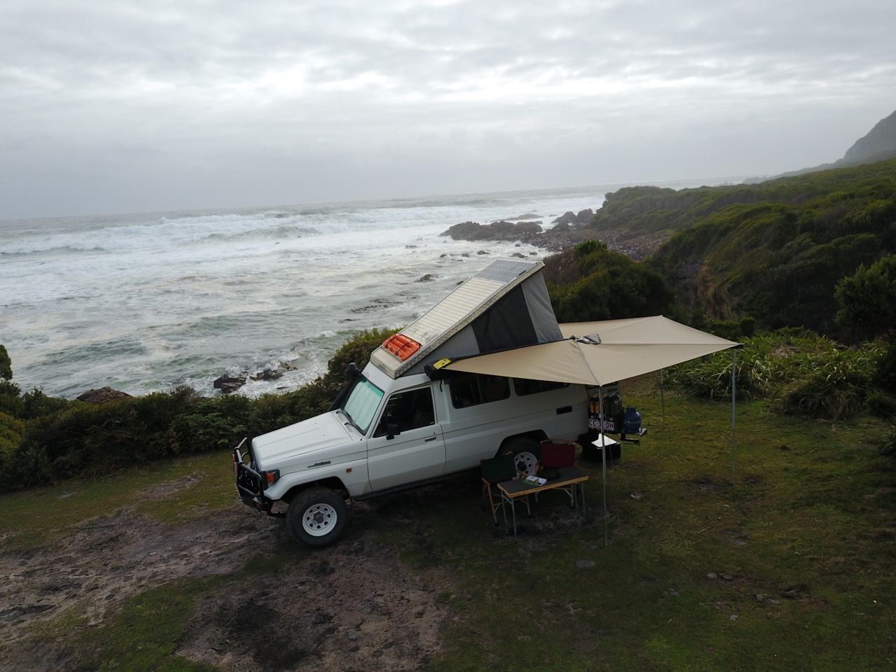

I did see that one. Oddly, I almost prefer to find one in AUS so I can have a Mulgo Poptop thrown on it. I keep getting pics from my buddies who are enjoying there's and it's driving me insane.
