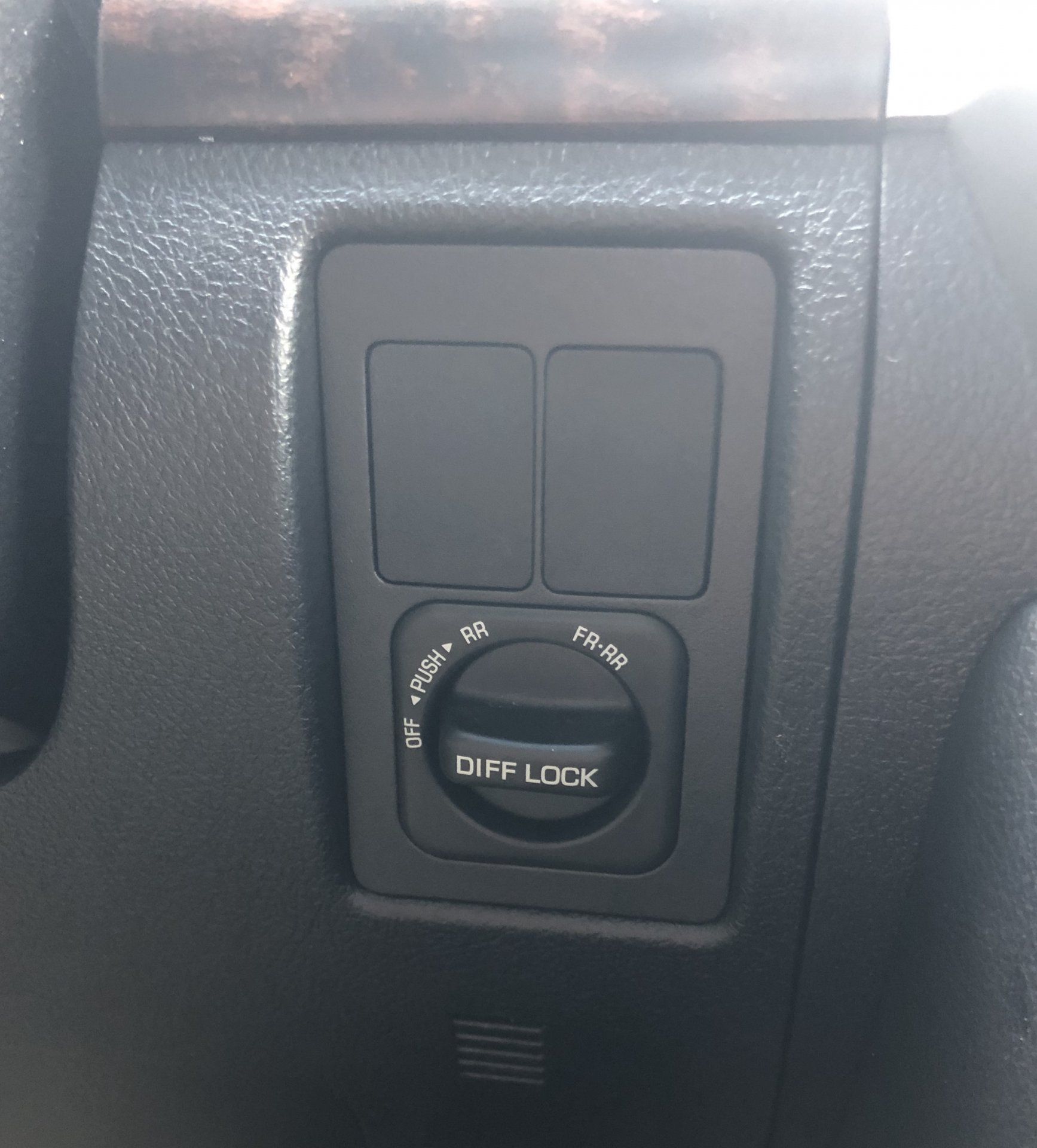

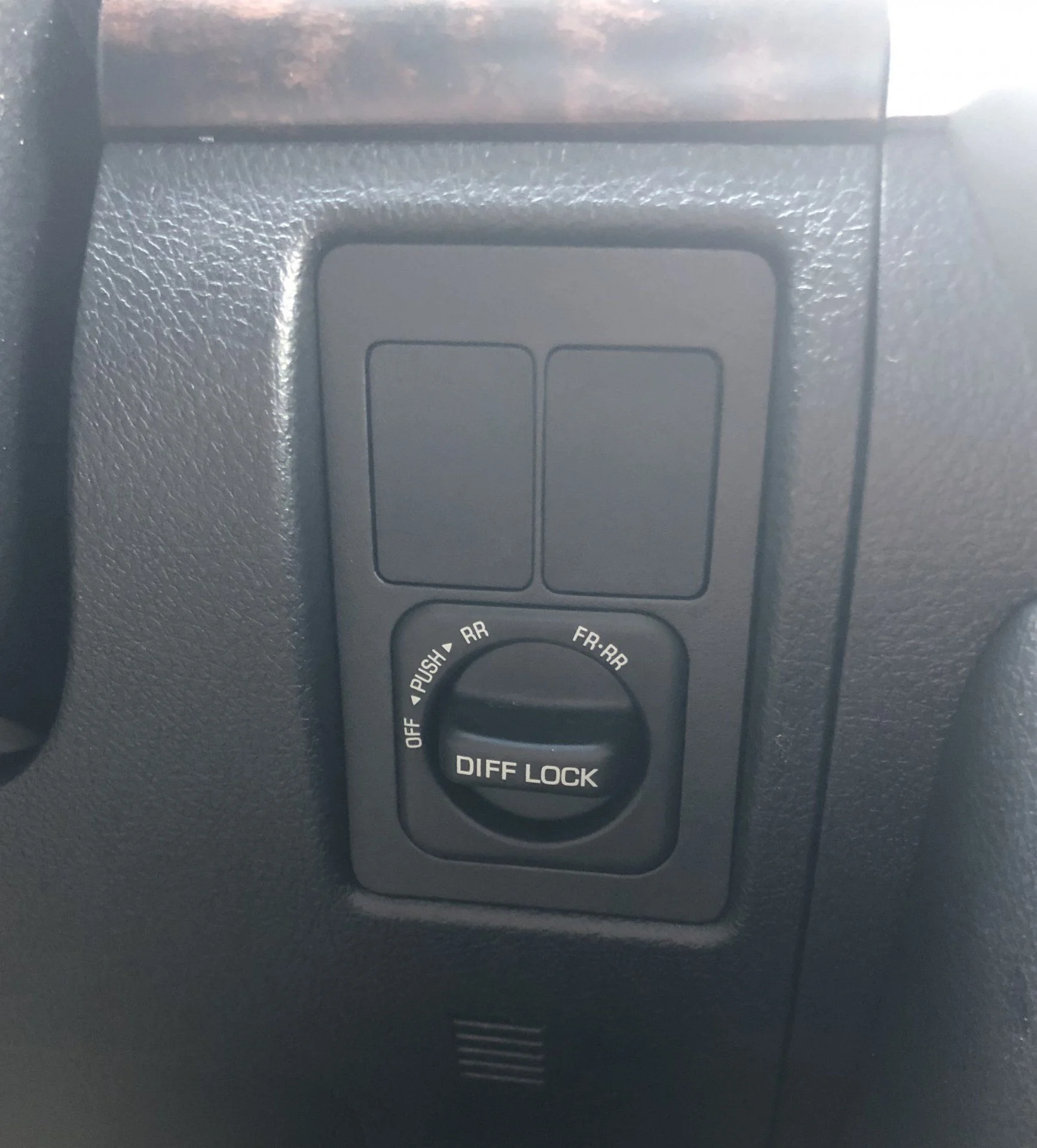

I like the idea of using the 80 series locker switch, but then I wont be able to activate the front locker independently. Any thoughts on how important that is?
Im about to do the same; rear is already locked.
Well it would only come on to play if you were in a situation were locking and spinning the rear could cause you to slide in a way you don’t want too. Basically super technical terrain. How often do you find yourself in that type of situation?
It's occasionally desired. You can also easily wire in a "front lock only" rocker switch (parallel)... or perhaps a rear locker defeat switch. That might be more safe, in case one were to accidentally hit the switch.
Well I cant think of any off the top of my head, but it sounds like if you are in that situation and dont have the option you’d be kicking yourself in the dick

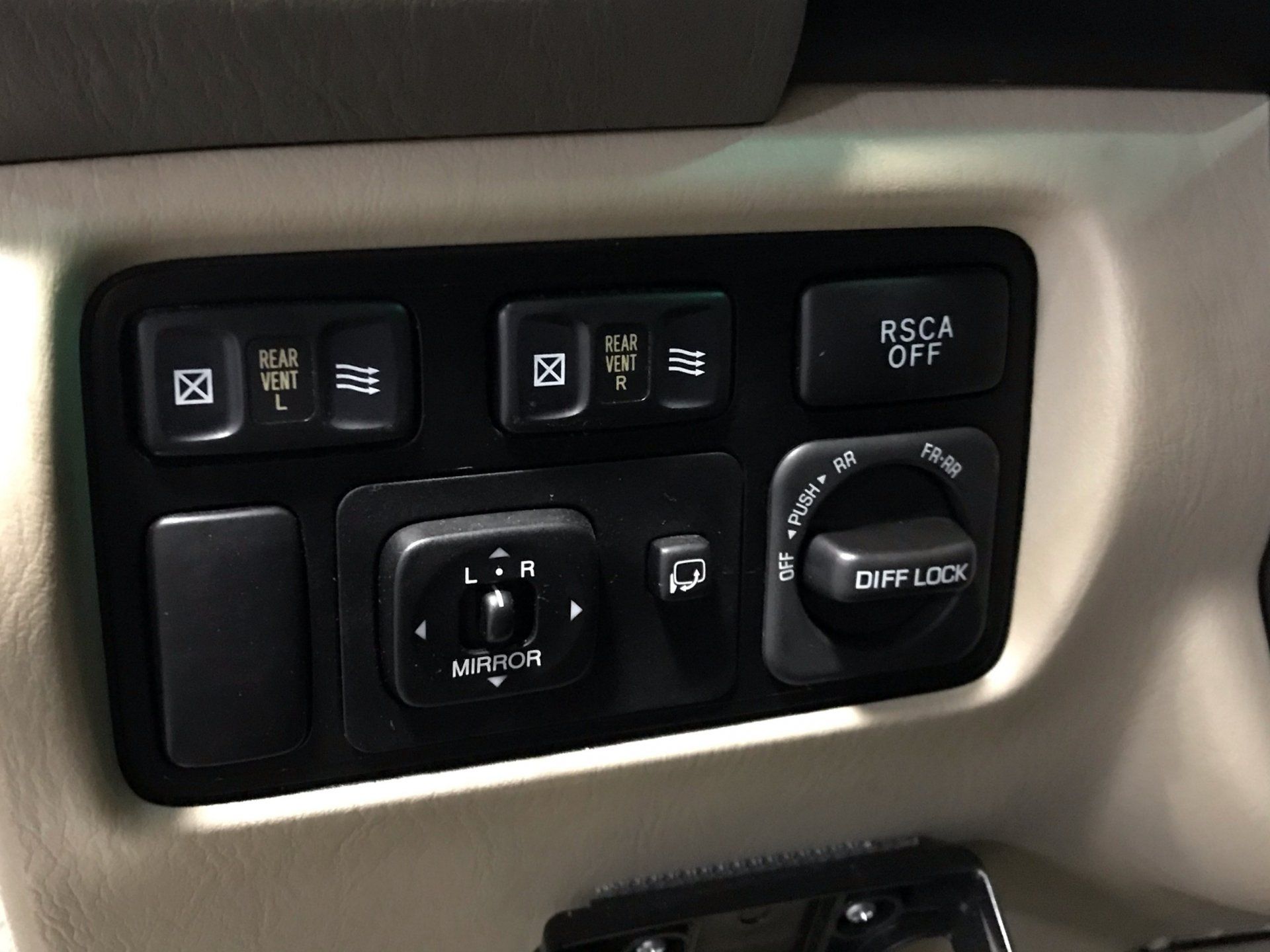

I have a factory 80 locker switch in my 100 and 200. So if it got that hairy I’d be breaking out the winch and snatch block or crawling under the back of the truck to unplug the rear locker. There’s always a way to skin the cat;)
Plus the factory switch just looks so nice and at home in there. 😁
I am about to put in a Harrops in the front and it is easy to wire up a Harrop to factory switch. Quite ironically the factory rear is nearly impossible to wire up to the factory switch without using the factory computer and harness :confused:
