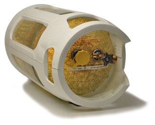

Im planning on putting a 25 horizontal propane tank
I currently carry 2 10lbs tanks on the rear swing out from the bumper...but im getting lazy and having to unmount the tanks in order to be used its getting old...
I also want to shift some of the weight from the rear to the middle/front of the rig...
Im planning on putting the horizontal tank in front of the rear axle on the right side.. The tank itself is made out of fiberglass so Im thinking of building a steel/alum sleeve to hold and protect the tank.... The tank would need to be pulled out for refills but not for day to day usage.... Im also planning on running a hose to the rear of the bumper with a quick disconnect like this one
Any input recommendation would be great.. !!

Personally I wouldn't do it. I do not like the idea of a bomb under my truck. Sure many people do it and have for long periods of time with no problems but I simply do not like the idea. I have been hit in my truck by other drivers so perhaps that has something to do with why I don't like the idea.

I also would use the fiberglass tanks which would not explode as regular tank do (I think).
I wouldn't have the tank under the truck all the time but only for the extended trips..

the tank IS expensive but cheaper n safer than steel or aluminum..it also would hold the most propane than any other tank out there... including the westfalia replacement tank from manchester tanks... which go for around $350+..........

Check out this video.. of a fiberglass propane tank on fire.. sure they will burn and if I already have an open flame going under my rig...Im already screwed...the propane tank would only be the cherry on top , on a really bad situation........!!!!!!!

Great video on the tank I was impressed with the leakage in pressure vs the exploding capability the steel tanks carry. Thanks for sharing. Post this with sticky as a safety type forum

I think you should be fine and can't see how it poses any greater risk than a gas tank in terms of a collision. They have been mounting these for years in RVs, VW vans etc. and I dont recall there being a lot of reports of explosions. I would be sure that the manufacturer recommends it for that purpose though. I have an ASME tank from Manchester to mount on my chinook. I hate lifting and positioning my propane tank and always feel like its in the wrong place. I personally feel its safer to permanently mount one. The one i have also has a digital meter so i can read it while inside the chinook:grinpimp:.
For those that don't know. Horizontal and vertical tanks are extremely different so don't mount a vertical tank horizontally and there is a difference between vapor and liquid propane tanks. Make sure you are using the appropriate tank.

Yep, these tanks are the schiznitz, way safer than steel.
On the other hand, I'm one of those who'd worry about this being under the truck -- if it was my truck. Mainly because fire burns up really easy, while sideways at least gives you a chance to run...:D
It is true that the older steel tanks are in wide use, exposed as mounted at various places on RVs. But with trailers, it's not actually in with passengers. Motor homes are a bit different. I'm not really sure about all the regs, but they're meant to reduce risk, not eliminate it. Everyone has their own comfort level, too.
One last thing to note when used on vehicles with humans aboard, i.e. most commonly forklifts, but other equipment, too, LPG tanks generally have a hefty steel cover to prevent penetration if the vehicle was to push up against an object. That would be my greatest concern, not a collision. It may be that you want something heavier than a stone shield, depending on the exact mounting location, to prevent anything trail-related that could stick up and puncture it.

It will go under the passenger rear seat and I will probably over build it to give me some sense of added safety... not only will the tank slide on its own steel sleeve but it will also have a 3/16" skid plate...
If my measurements are correct it will sit higher if not even at the frame rails under the rig.....
Anything (most likely rocks,boulders) that wants to make contact with the skid place will first make contact with the lower control arms and / or drive shaft....
