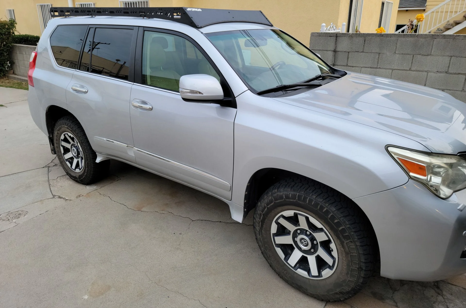

i ran this size in a duratrac on my stock 2012. it looked good and filled in the wheel gap nicely. i upgraded to 255/80r17 when i got my lift on for the additional 1" in tire height and also to go from a P tire (duratrac) to an E rated for more durability offroad.
i like the 255 width though. looks great and to your point, better for snowy and icy street driving.

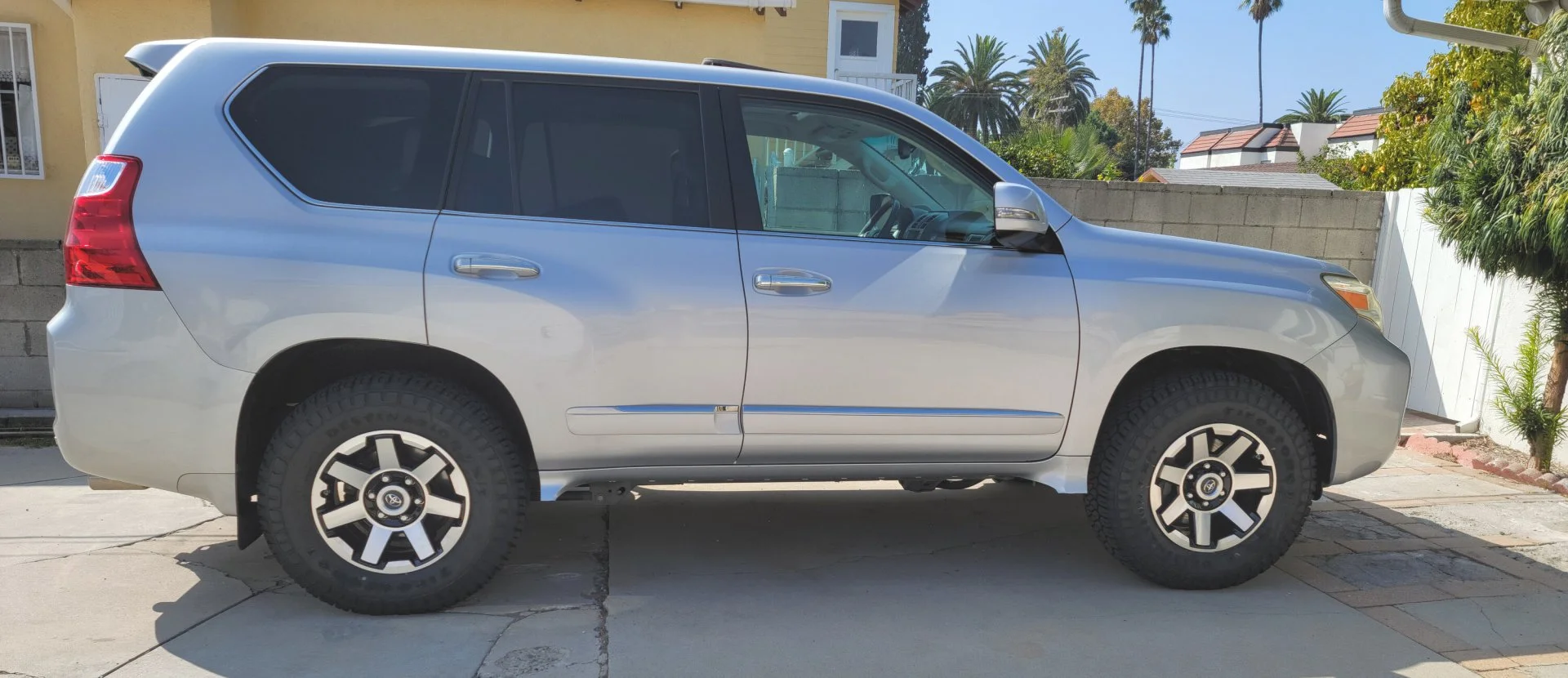

255/75R17 Continental Terrain Contact-at load C 6ply
1.5
Rear = 1.5 Cornfed Spacer in rear with new Blistein shocks
Front = 2.5 Bilstein Adjustable shocks on top setting
OEM shock
Venomrex VR-601 Wheels
Some thoughts on the 255 tires.
OEM 18 inch rims weighed 32Lbs
265/60R18 Michelin defender where 36.99
Total weight per wheel was 68.99
Venomrex VR-601 Wheels 17 inch wheel - 24.6 lbs
255/75R17 Continentals are - 40lbs.
Total os 64.6 Lbs
With the less rolling mass (10.4 inch wide v.s 10 inch) and weight difference... the truck has great pickup and handling.
The front has dropped a little after the Ironman bumper was added, and no trimming was needed.
