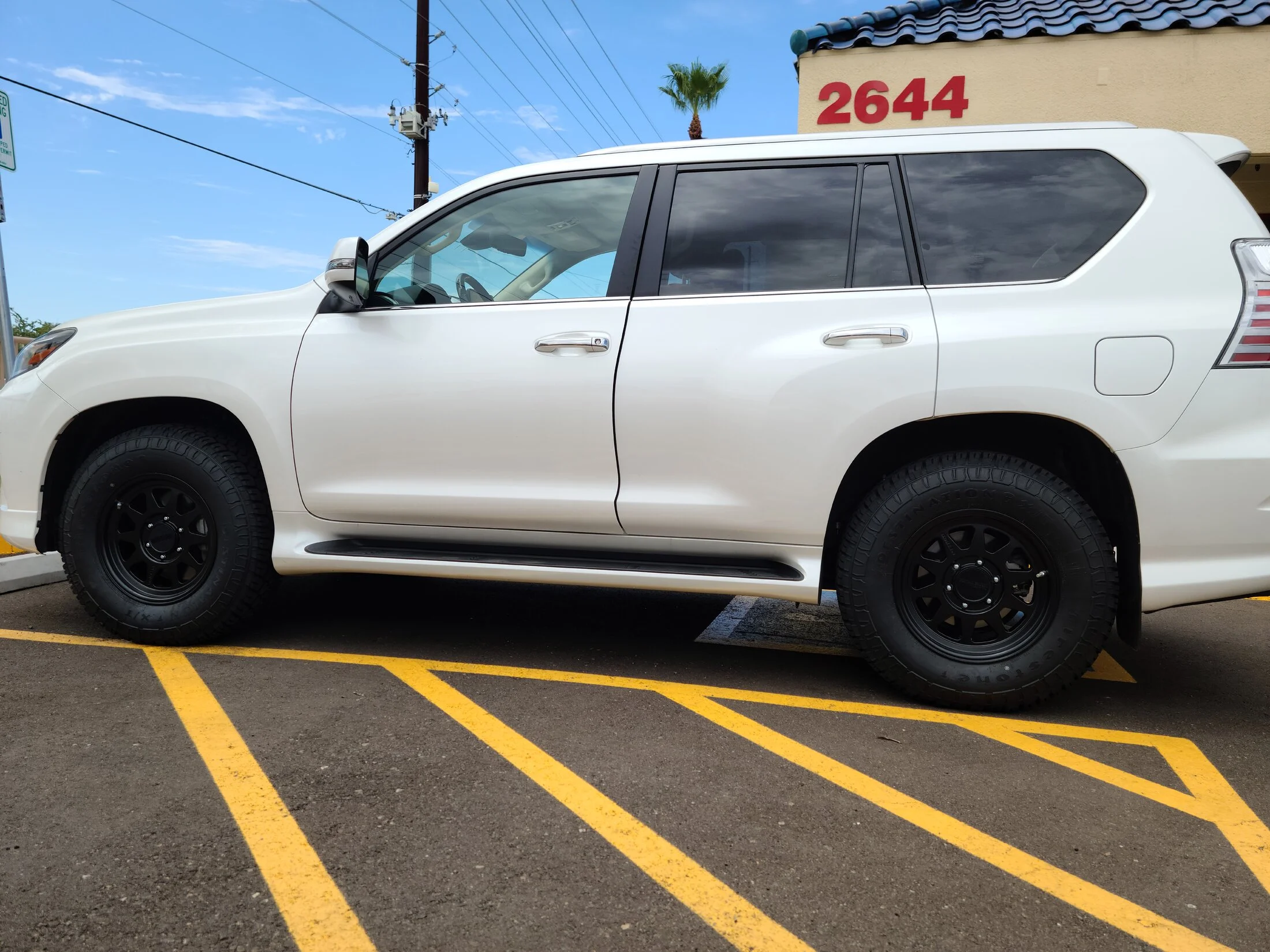

255/75R17 Continental Terrain Contact-at load C 6ply
1.5

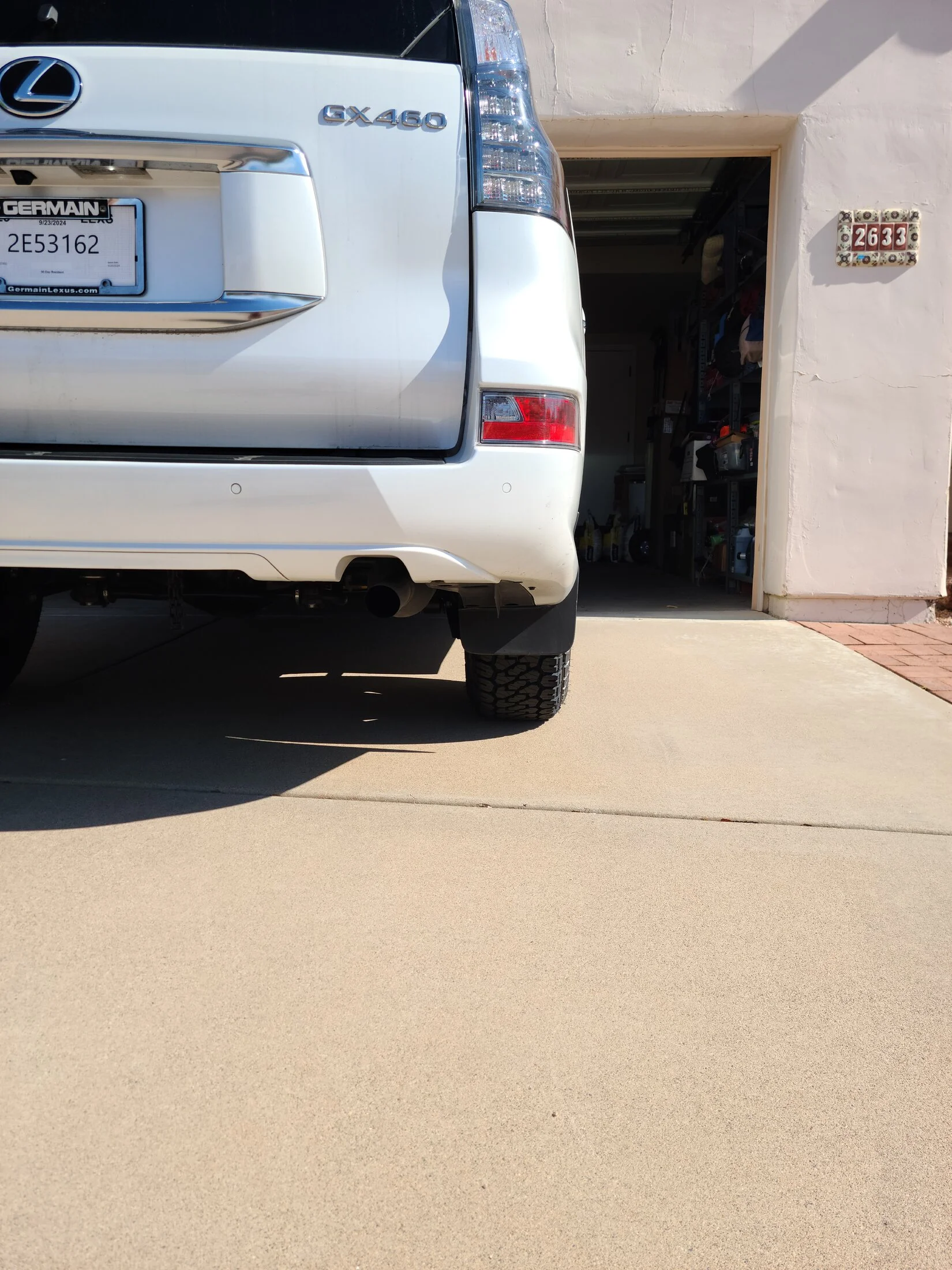

Rear = 1.5 Cornfed Spacer in rear with new Blistein shocks
Front = 2.5 Bilstein Adjustable shocks on top setting
OEM shock
Venomrex VR-601 Wheels
Some thoughts on the 255 tires.
OEM 18 inch rims weighed 32Lbs
265/60R18 Michelin defender where 36.99
Total weight per wheel was 68.99
Venomrex VR-601 Wheels 17 inch wheel - 24.6 lbs
255/75R17 Continentals are - 40lbs.
Total os 64.6 Lbs
With the less rolling mass (10.4 inch wide v.s 10 inch) and weight difference... the truck has great pickup and handling.
The front has dropped a little after the Ironman bumper was added, and no trimming was needed.
Spacer in rear and new Blistein shocks
Bilstein Adjustable shocks on top setting 2.5 lift
OEM shock
Total os 64.6 Lbs

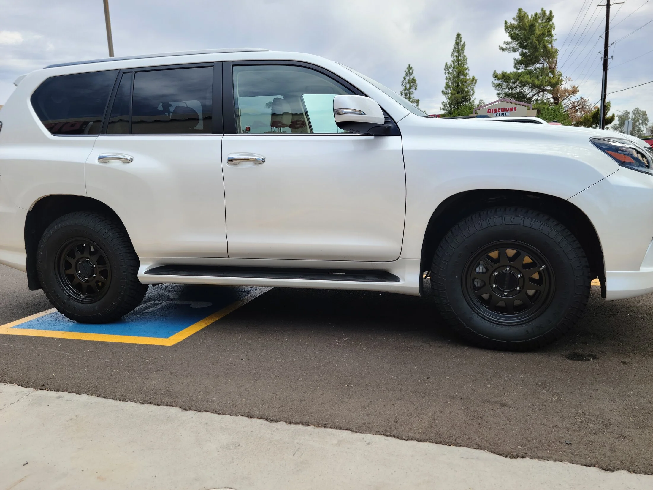

grabbed method rims w the same +25 offset. put on 255/75/17 (32.1"). no rubbing until i went offroad. only had a bit of rubbing on the driver's side where the bolt attaches the running board endcap to the truck. replaced it w a lower profile screw. the tire will fit the stock spare location. i have no lift nor a hitch.
no change in mpg's either. tad better actually as i dropped weight at each wheel vs oem. hope that helps someone.
