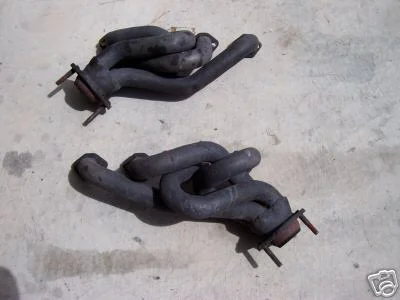

I think both will work. I have the rams on mine, but we just did FJKai's and he is running 1 of each (ya, don't ask) with Mark's Adapter. There is so much room in the 60 for a V8 it's crazy.
Right on...
Then the spagetti headers will fit with a 5.0
attachment.php
Also, how much did you offset the motor to one side (2" to the drivers side or...)
Stock exhaust 5.7 TPI engine 1 inch offset to DS
