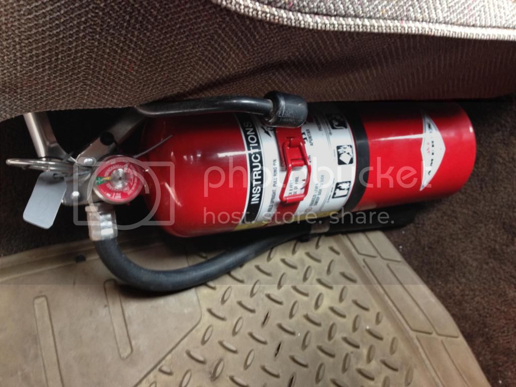

Cree Bar and 5lb Extinguisher and my ARB switches

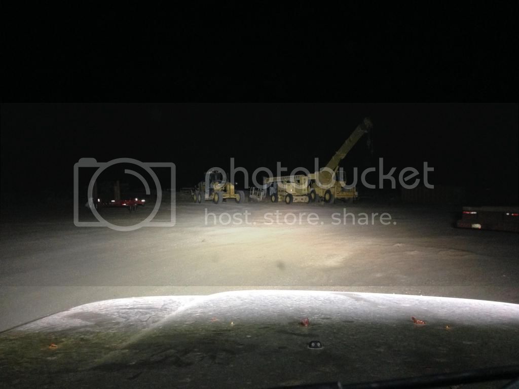

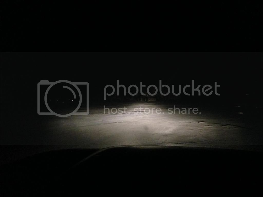

Here is a pict of the stock low beams
Here is a pict of low beams + LED Bar

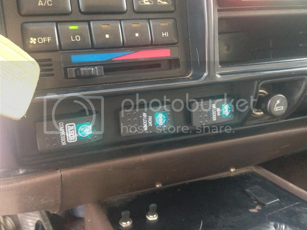

ARB Switches, the Heater switch was relocated under the ignition switch.

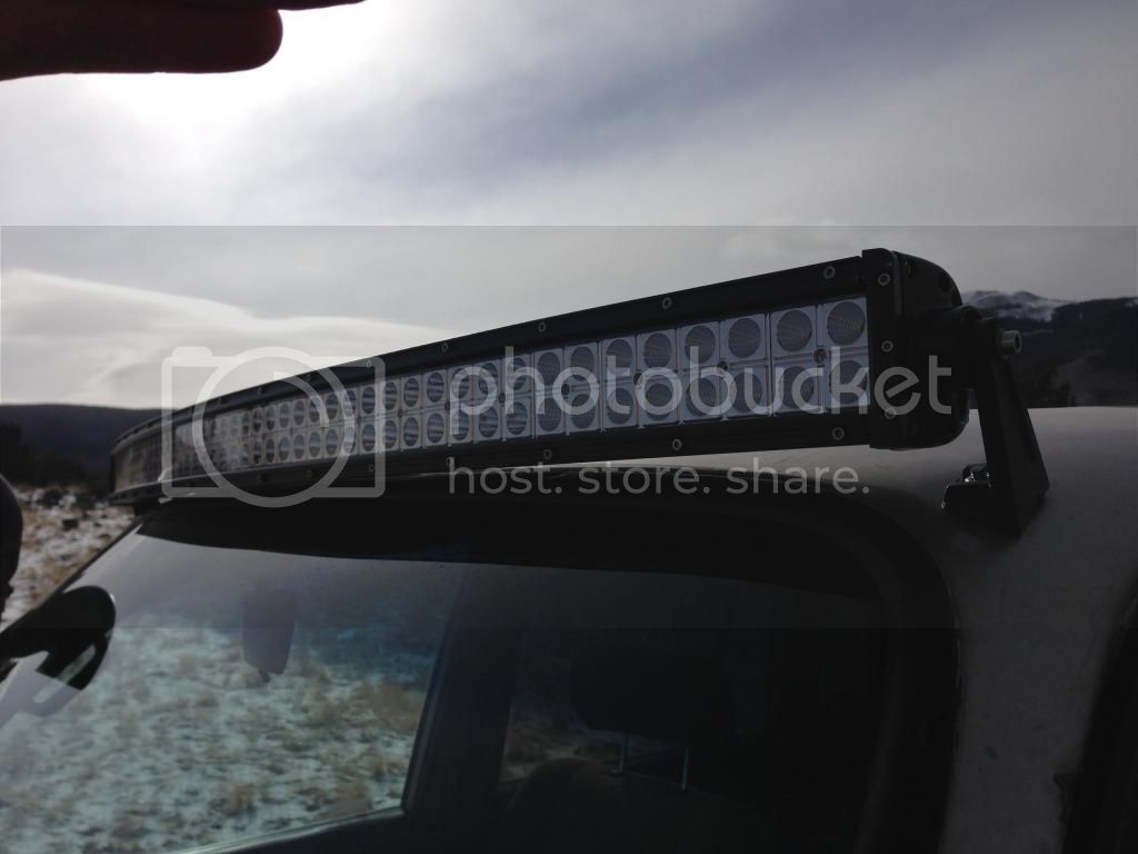

how did you mount the iightbar? just curious.
The Cree bar came with Cast Aluminum brackets, I ground down the mounts to make the feet a bit angled to match the cab. Then ran a carriage bolt through the roof to the inside of the cab. Flat side is inside, bolt is outside. Everything is siliconed.

Did you mount that rear lightbar to the "wing" inserts? If so you absolutly must give the model of lightbar, brackets, pictures, and any measurements. Very slick mod

Finally about the light bar: Its a Cree 42" don't know the part number I got the front curved 50" and the rear on a group buy at trundatalk.net for a "to my door price" of $230. While they aren't RIGID's they are fantastic. My 80 didn't have a rear wing so I drilled through, used a carriage bolt (flat side on the inside) a judicious amount of silicone and the supplied rubber spacer to install both bars. I am 99% sure that the holes will not allow moisture in and the bars are very stable. @Dubbinchris Why would you not drill the roof?
