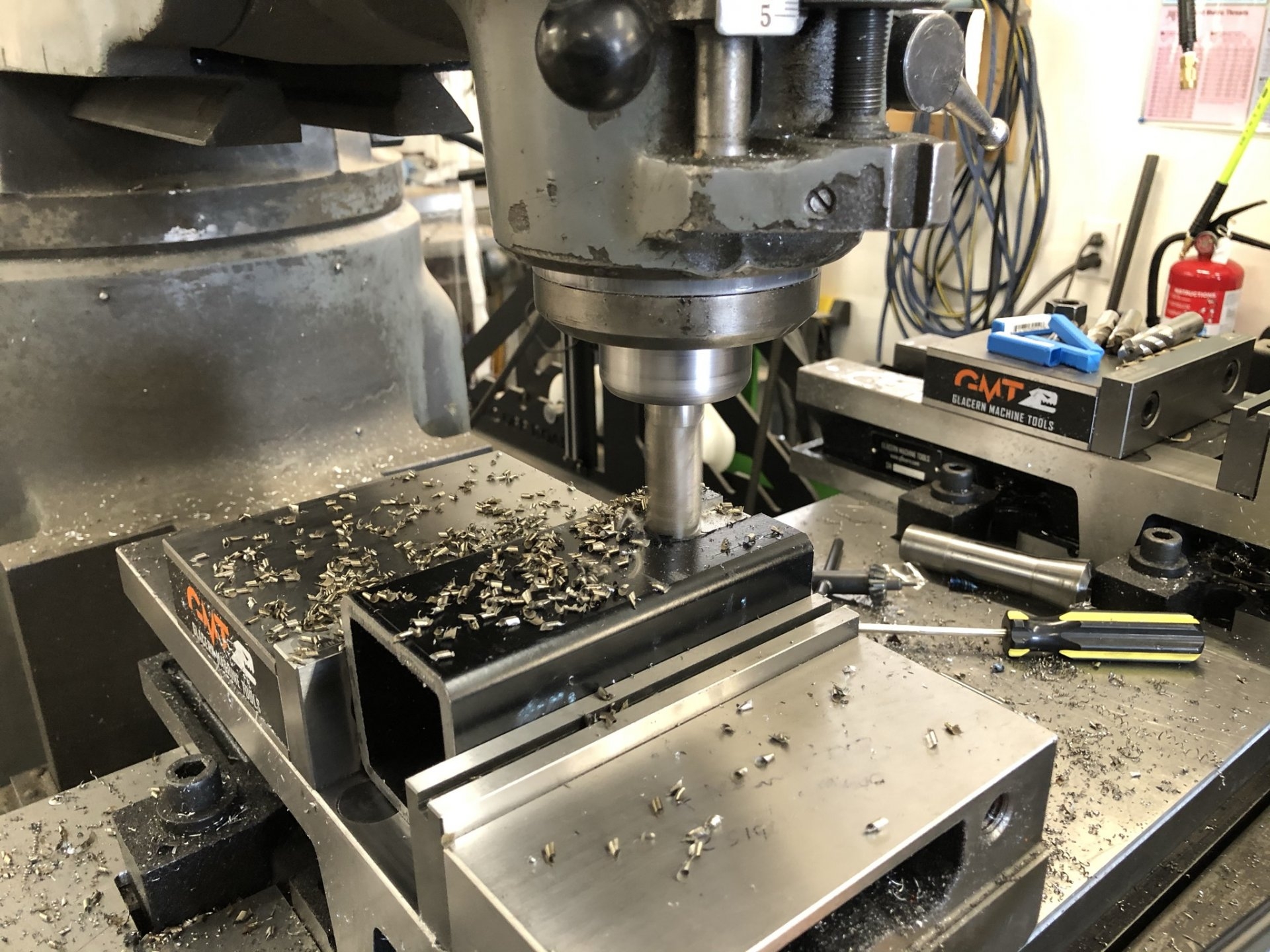

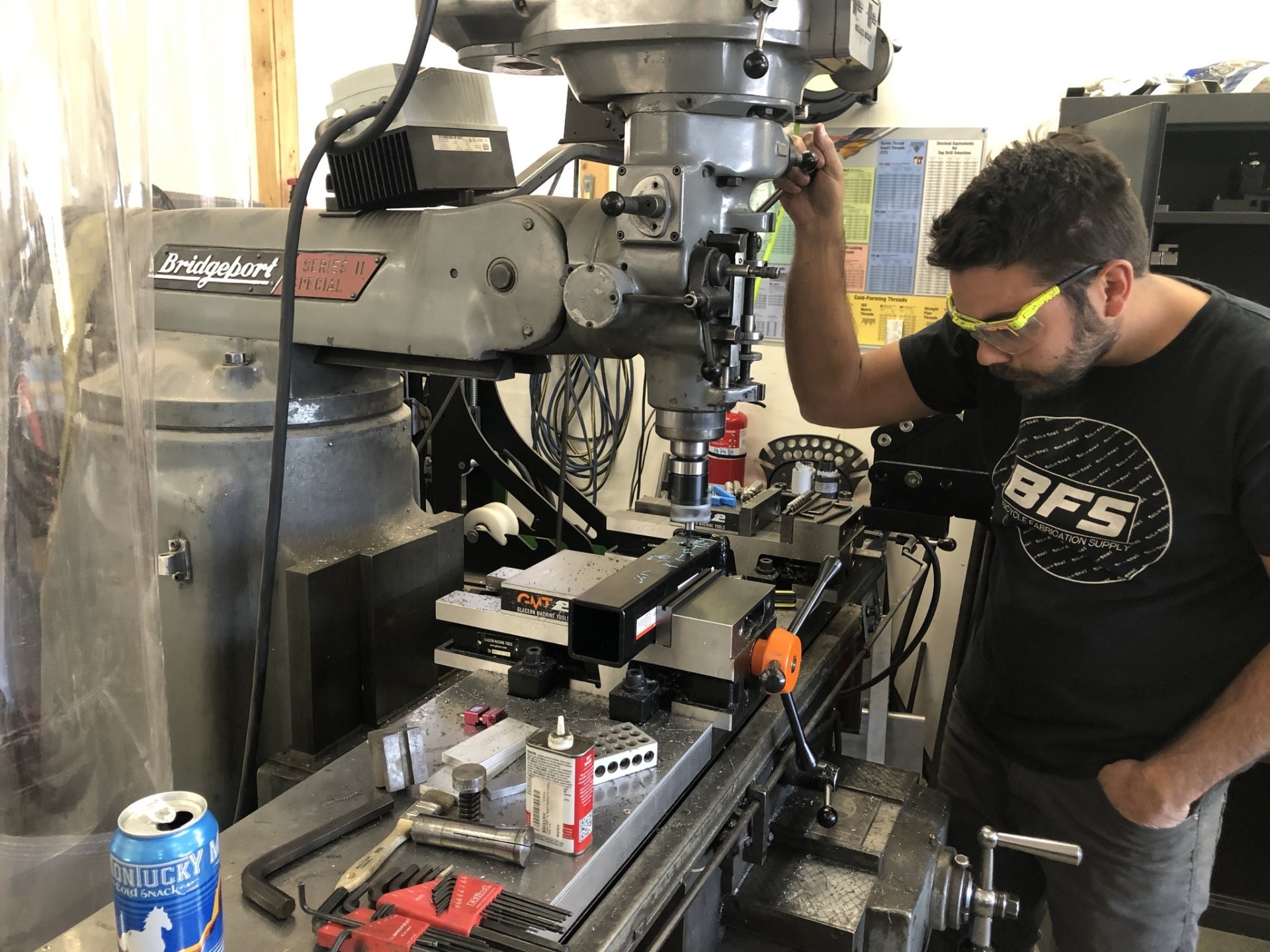

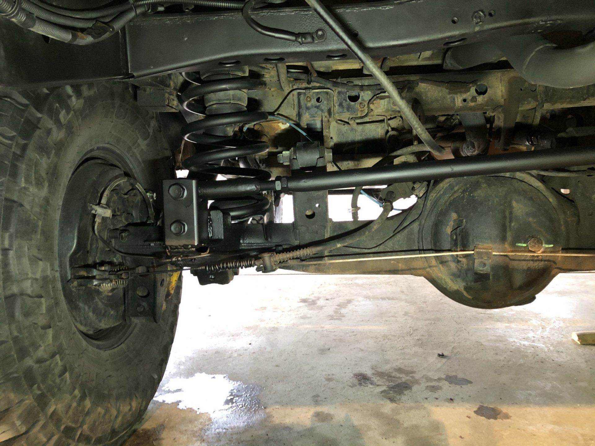

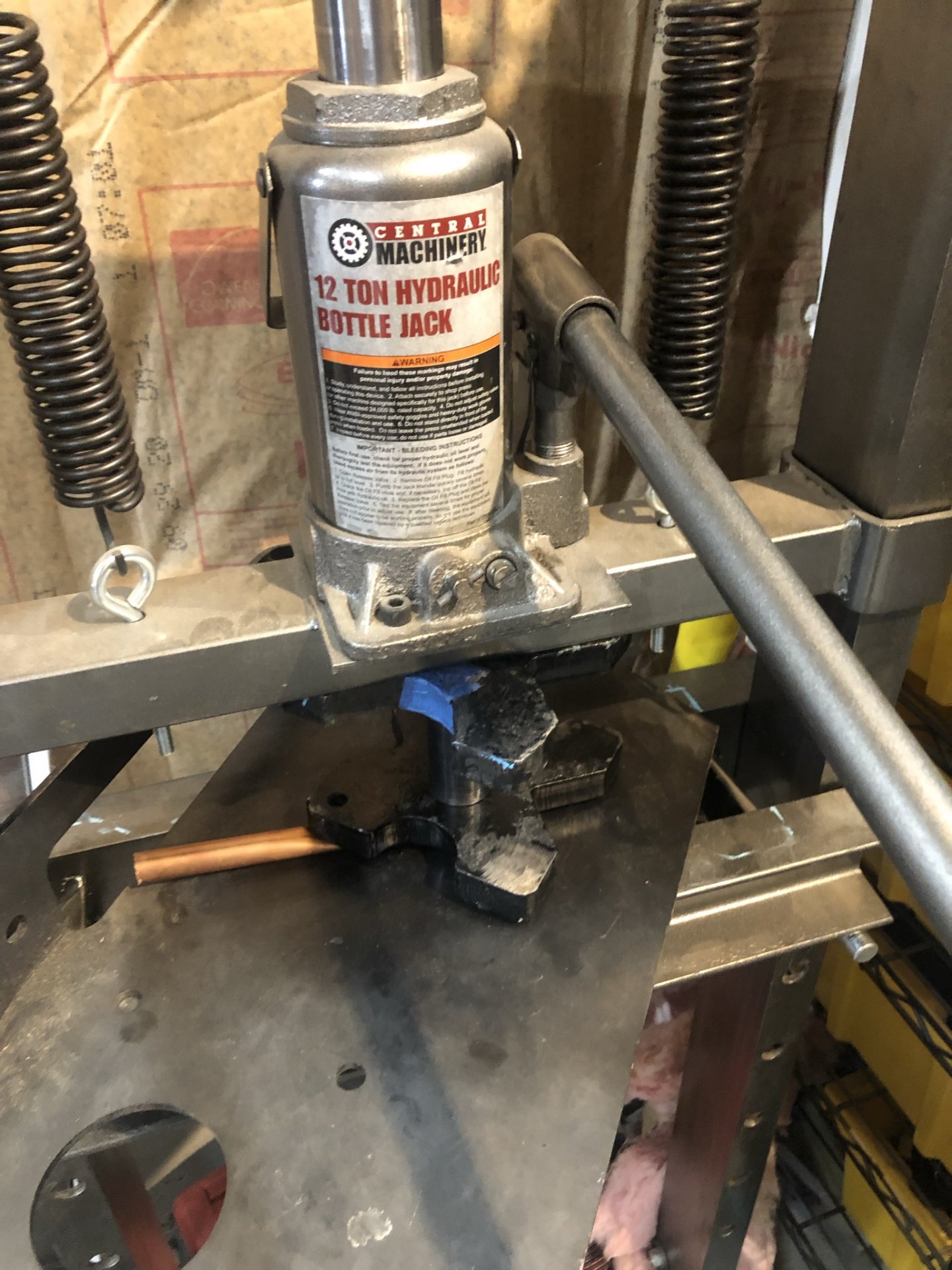

I decided to make a panhard bracket today, glad to have a good friend who's a machinist.

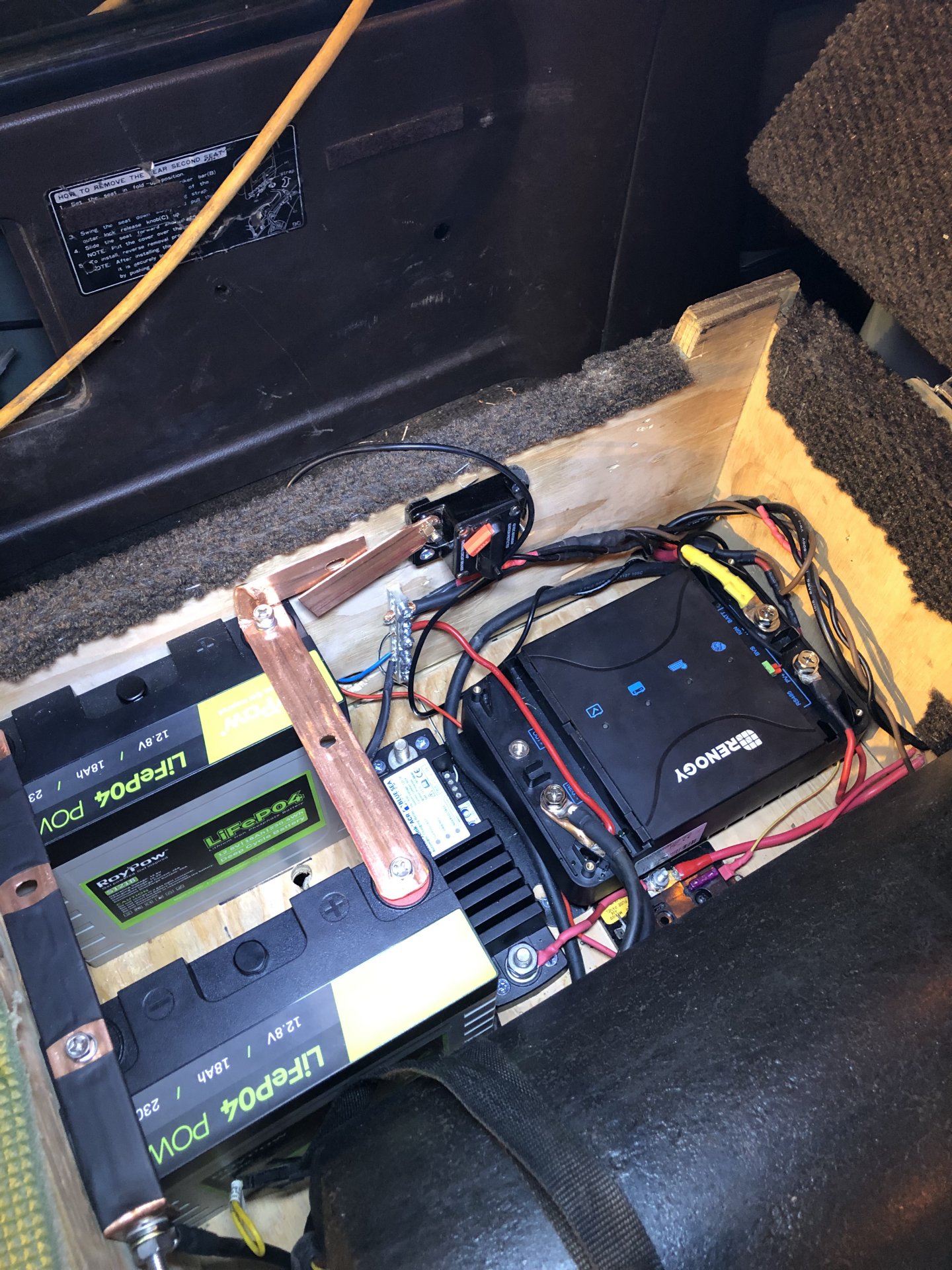

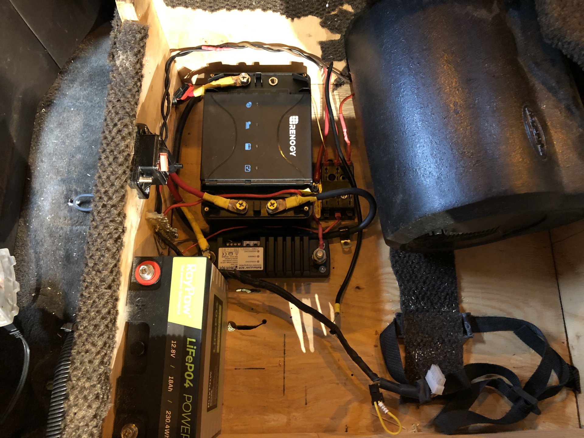

The 35ah deep cycle in the box has gotten tired so after lots of research and several expensive late nights on the Amazon, I've got a new system that I'm putting together.
(3) x RoyPow S1218 LiFePO4 batteries, each has 18 AH reserve capacity so the rear bank will have more usable capacity than my group 27 x2power dual-purpose batteries.
(1) Renogy DC-DC charge controller with MPPT solar converter (replaces my Victron Energy SmartSolar MPPT 75V 15 amp 12/24-Volt Solar Charge Controller)
Final layout / one-line diagram for the revised rear battery bank

Examining all of the info and cost lead me to choose Lithium over sealed lead-acid. I'm happy with this decision and am excited to see how it works out.
The new system ran flawlessly for the last 4 days out in Lockhart Basin, both fridges were set to and held 30° F (-1°C) throughout the 90°F (32°C) days. Even floated up the front house and starting batteries after about 3 hours of direct sunlight on the panels. I was also charging USB speakers and phones off the rear power ports, using the water pump on occasion, and running my tailgate lights in the evening.
I really need the Bluetooth module to come in for tracking since bank voltage is no longer an accurate metric for gauging the LiFePO4 banks' state of charge.

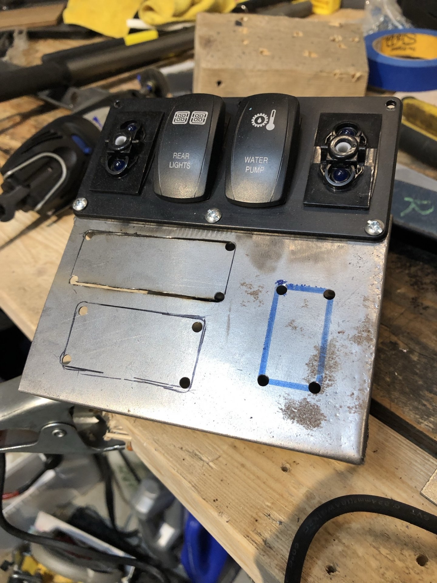

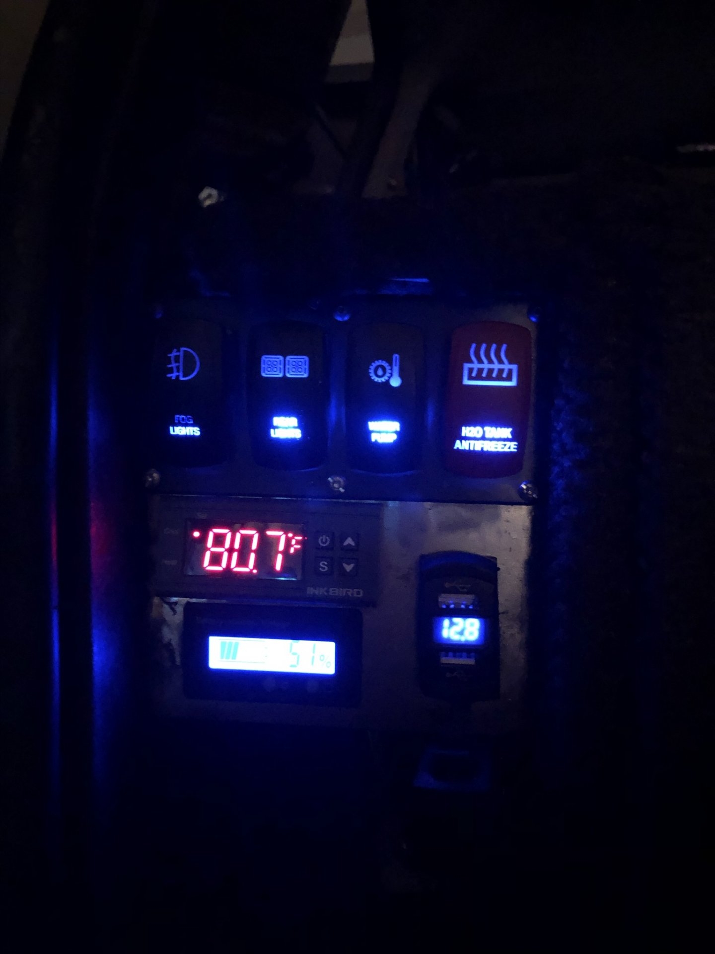

Made an extension for my rear switch panel. This panel started as a 4 slot switch plate that had a USB charge port, hatch light switch, storage bay light switch, and water pump switch. Now I've added a battery compartment heater & ventilation controller, Lithium Battery meter, & water bladder heater switch.

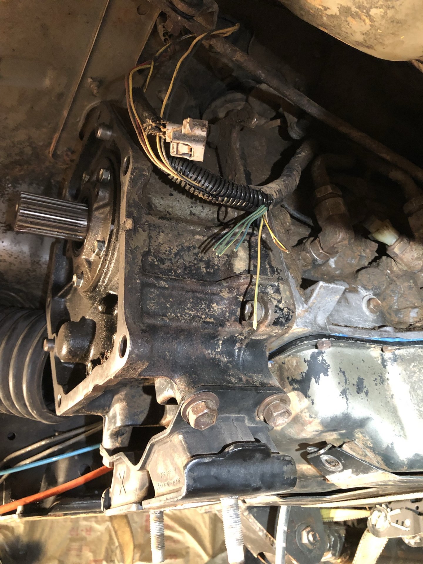

Well, I think I've located the cause of the stuck center differential...
The harness clip had broken and the loom flopped against the exhaust.

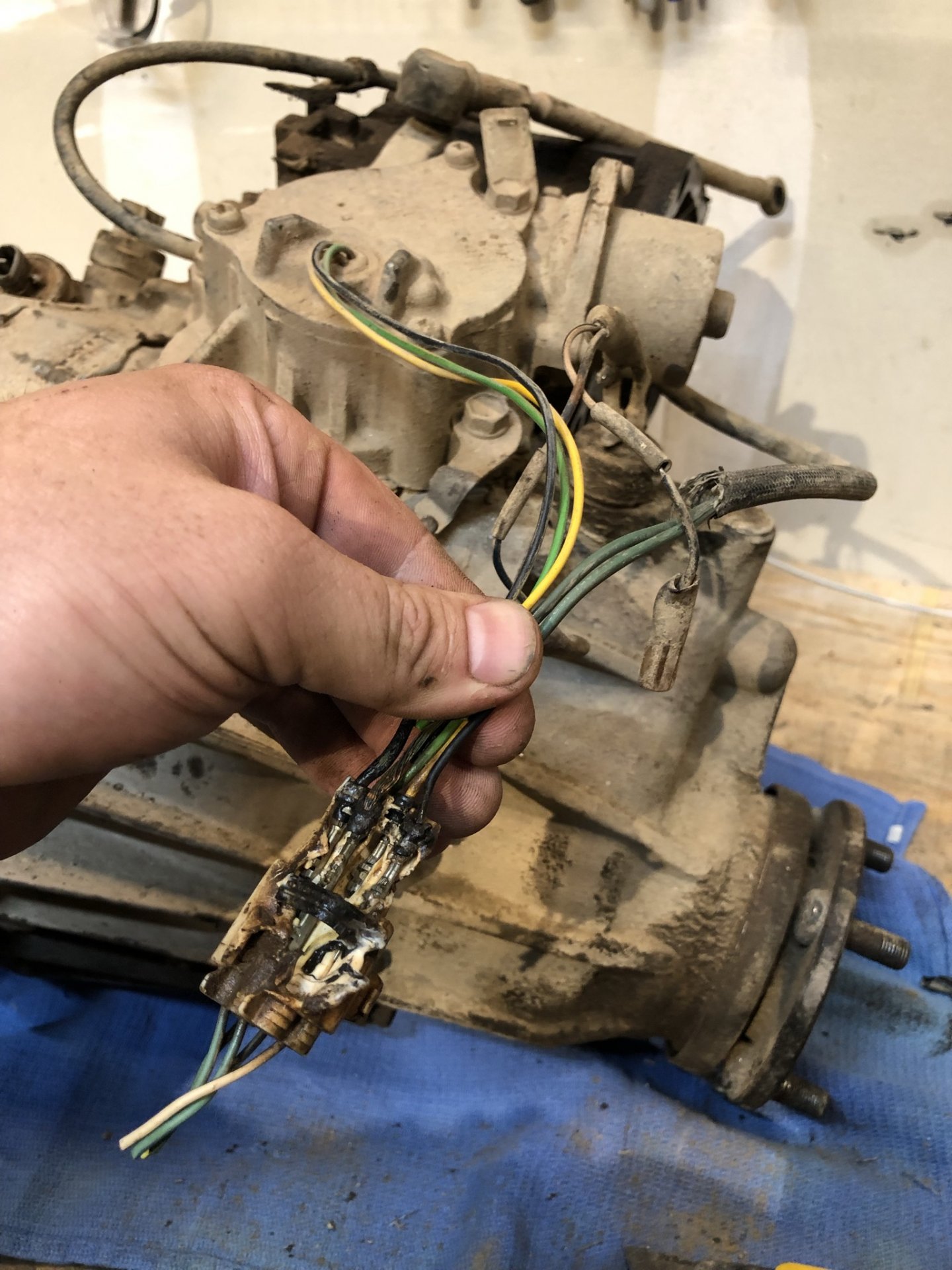

So as I stated earlier the harness had flopped against the exhaust, so it was pretty brittle and melted. I cut a bunch of it back, patched in new color-matched wires shod in high temp sleeves.

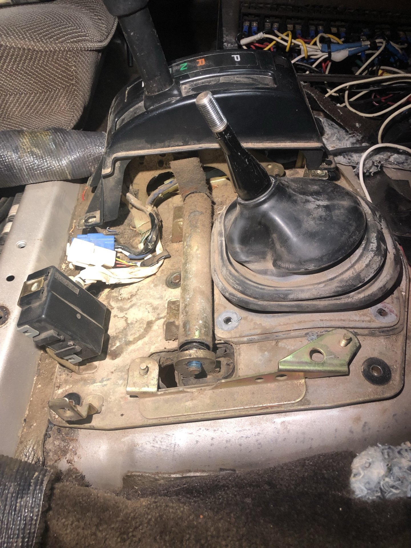

Replaced my transmission tunnel rubber shift boot since the links were disconnected already.

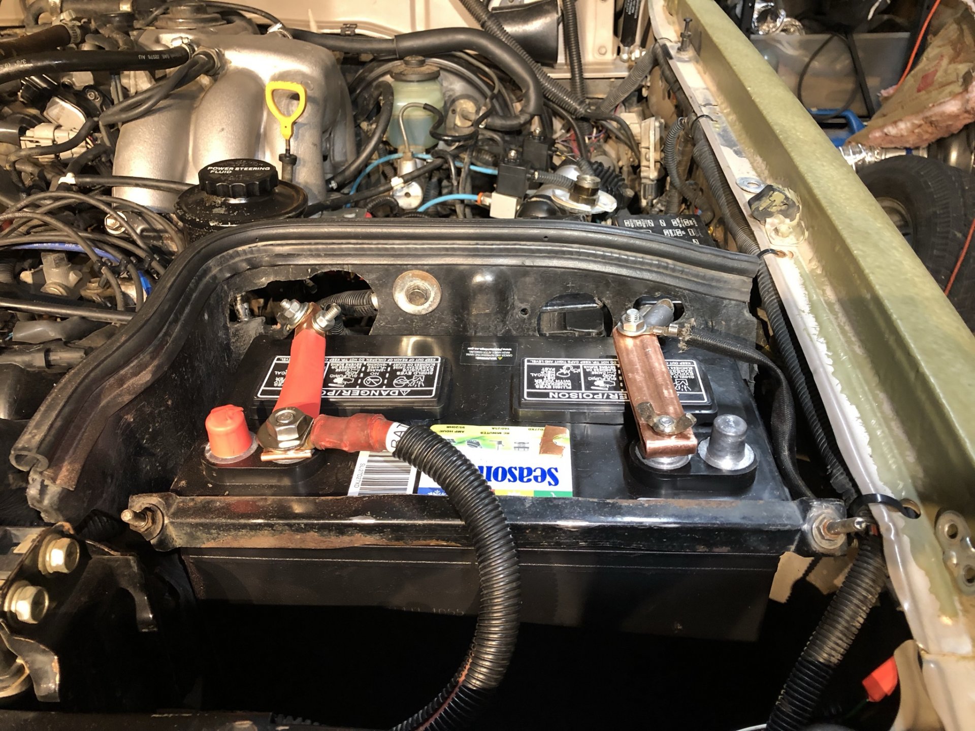

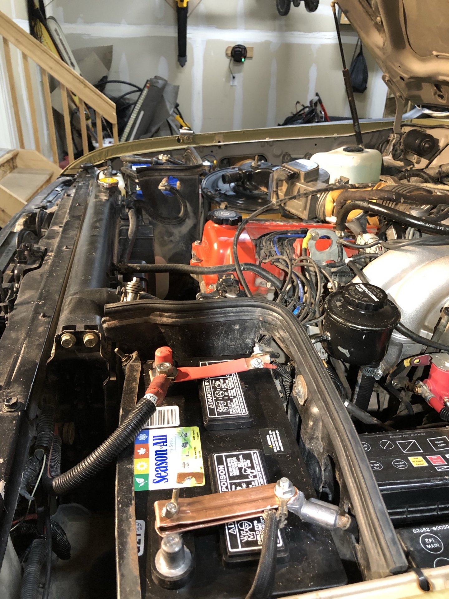

New battery is in, I made some copper bus bars to make this unit work without chopping wires.
