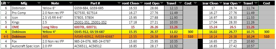

I've been toying with the idea of replacing my OME L's because they are stiff and beat up.
Last night I settled on Dobinson Yellows, then today I found the vendor thread on the IMS shocks. Really shouldn't spend that money buuuuuut it seems like a good investment. I'll also need to extend my bump stops / replace my missing one.

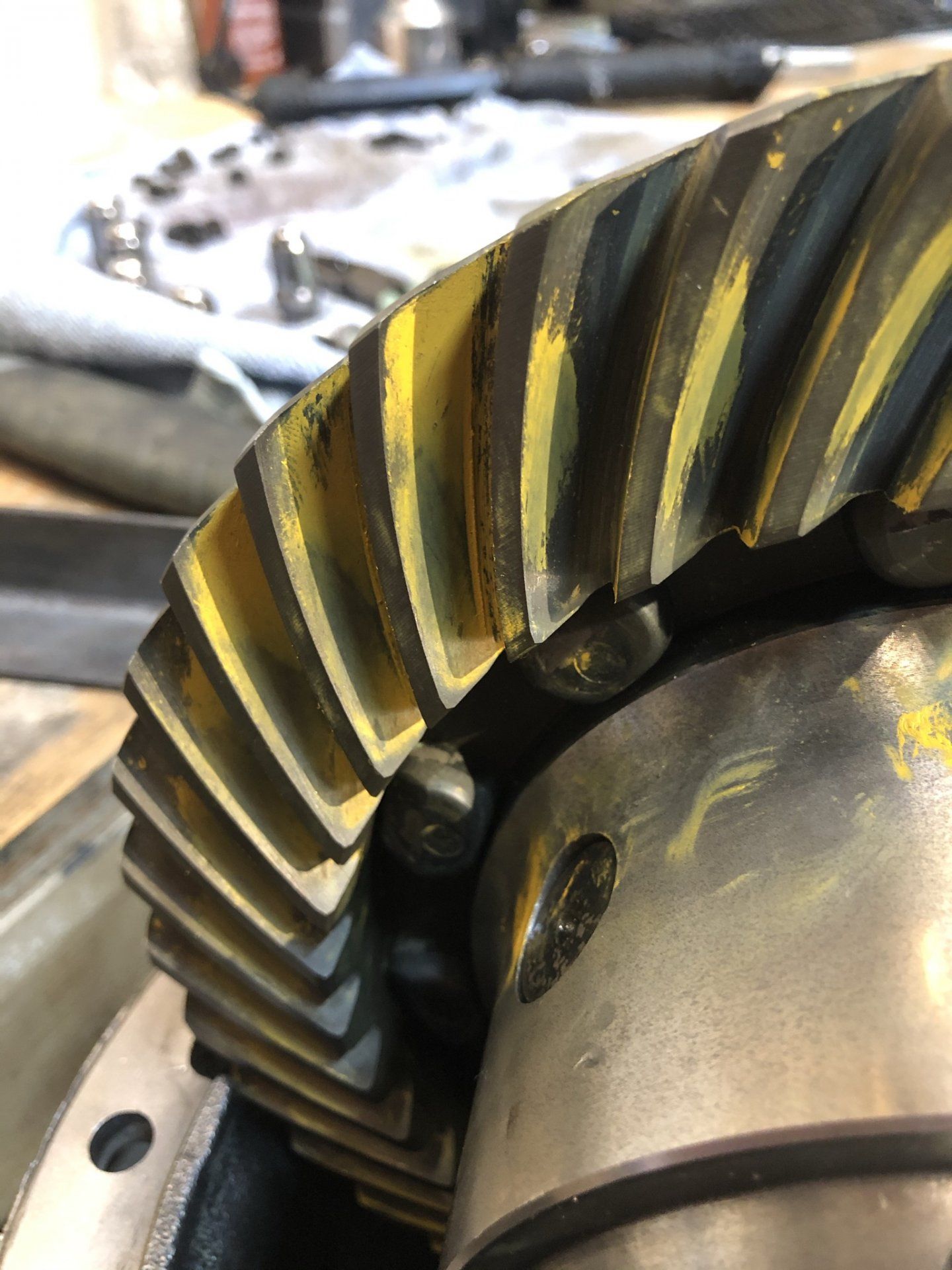

Backlash set, pattern looks good... For a used gear set....

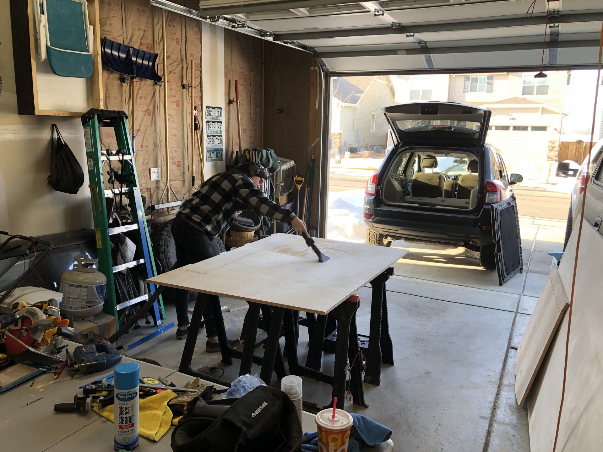

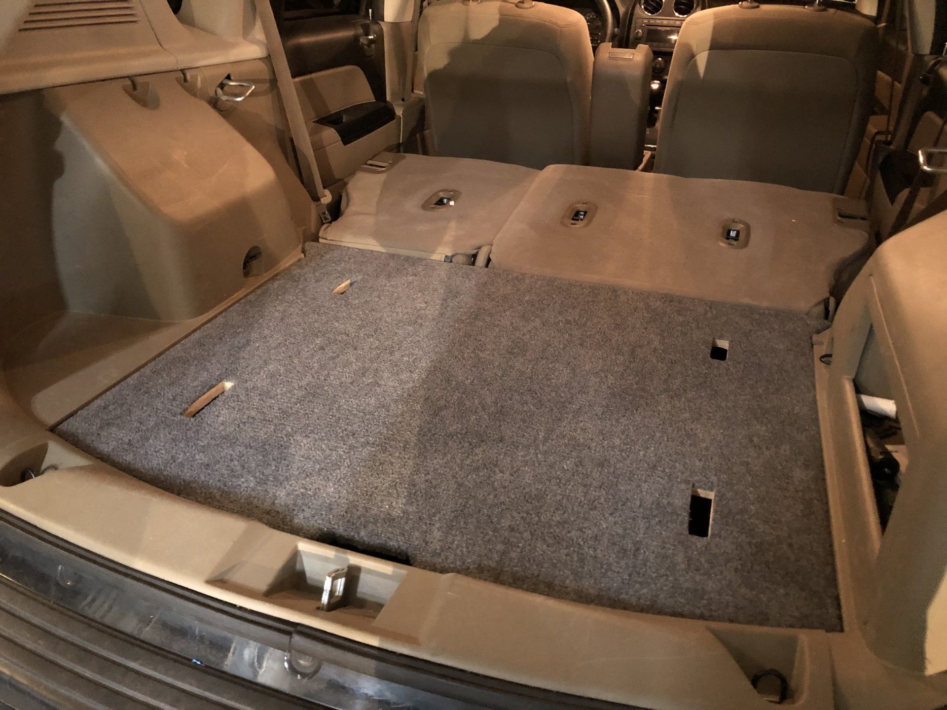

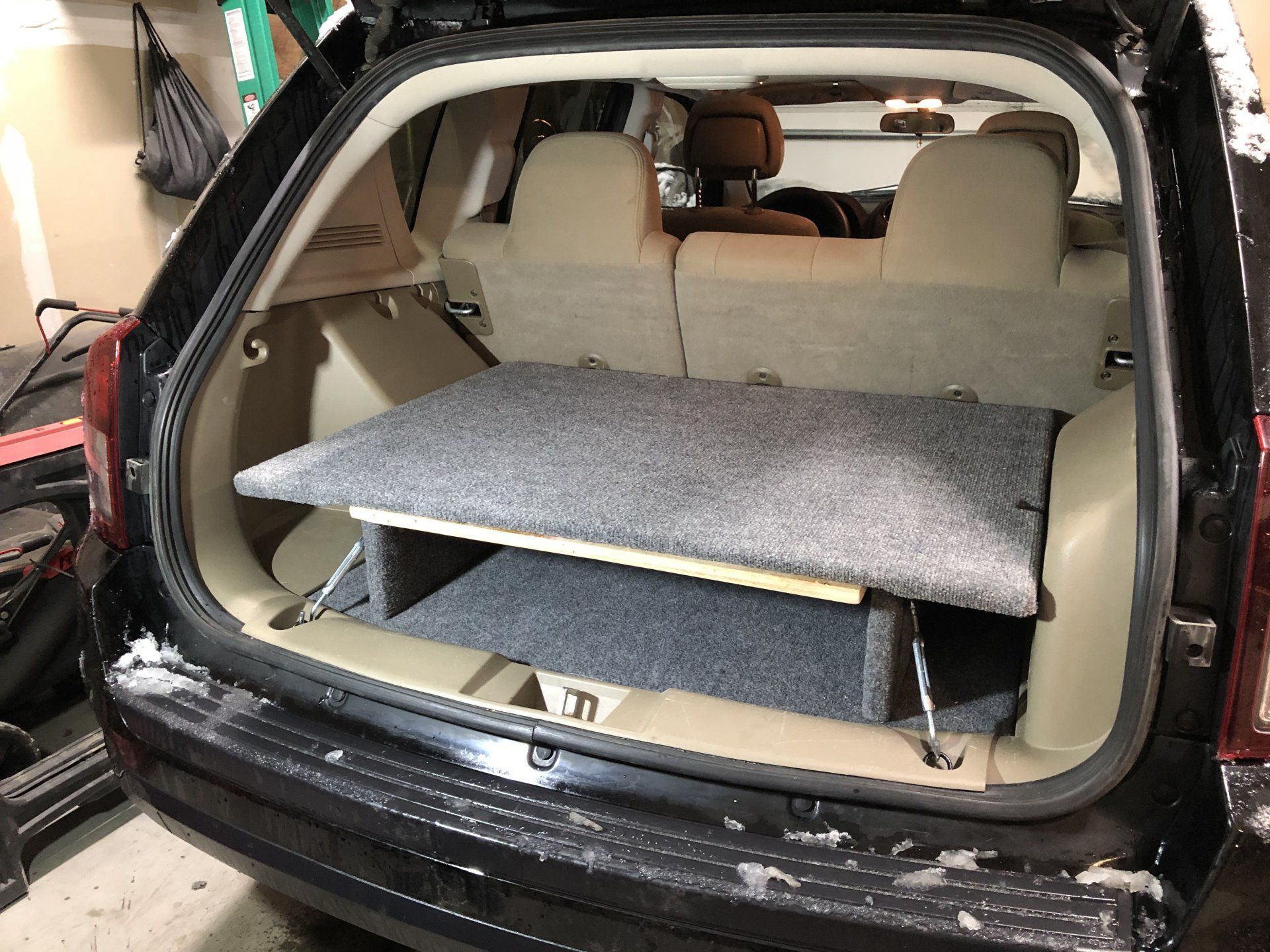

Took a break from working on my rig to build a box for my wife’s jeep. This will be a sleeping platform.

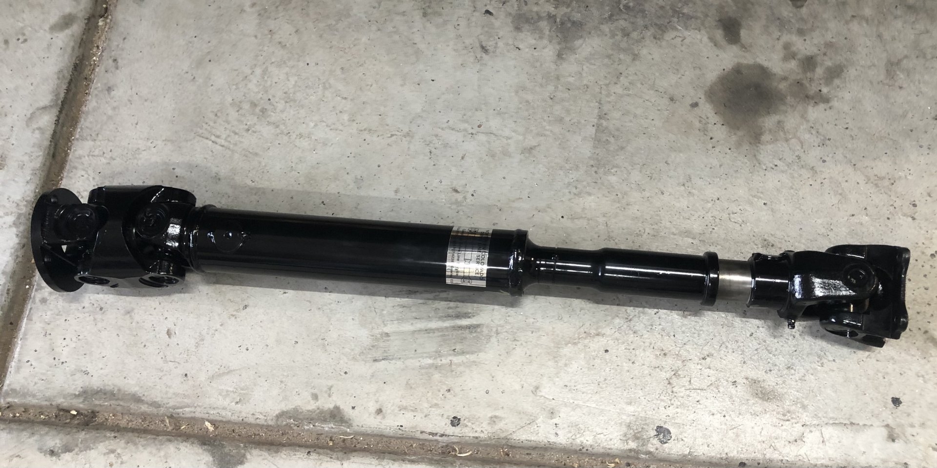

Another thing I should’ve done ages ago came in today.
No more growling on deceleration, no more crazy vibrations.
Which brand did you go with? Pros and cons?
It’s a custom fabrication by colorado drive line. They used one of my spare oem front shafts to build it. I needed it quick because my standard driveshaft was making a terrible racket and I’ve got a ~800 mile round trip coming up.
$375 and one day turn around was well worth it.
