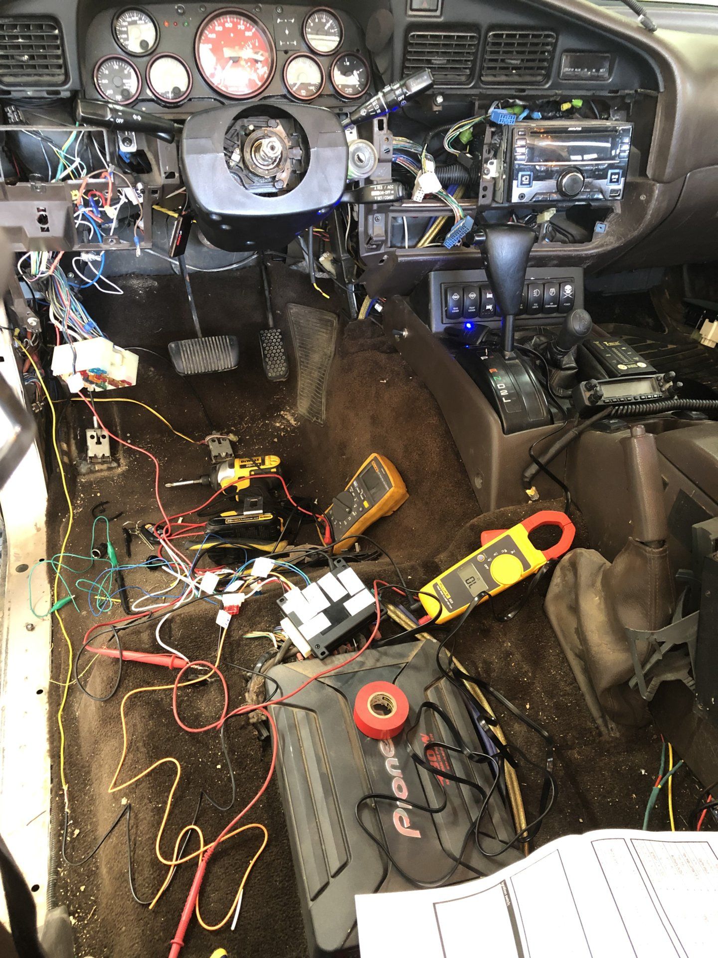

It's all done... Everything is wired correctly and without the use of the car toys wiretaps. The only issue is that occasionally the remote start is getting a week tach signal so the starter hangs on because the unit doesn't see the engine is running. I've narrowed it down to the RPM terminal on the connector to the unit not making good contact with the pin.
I'll figure it out tomorrow.

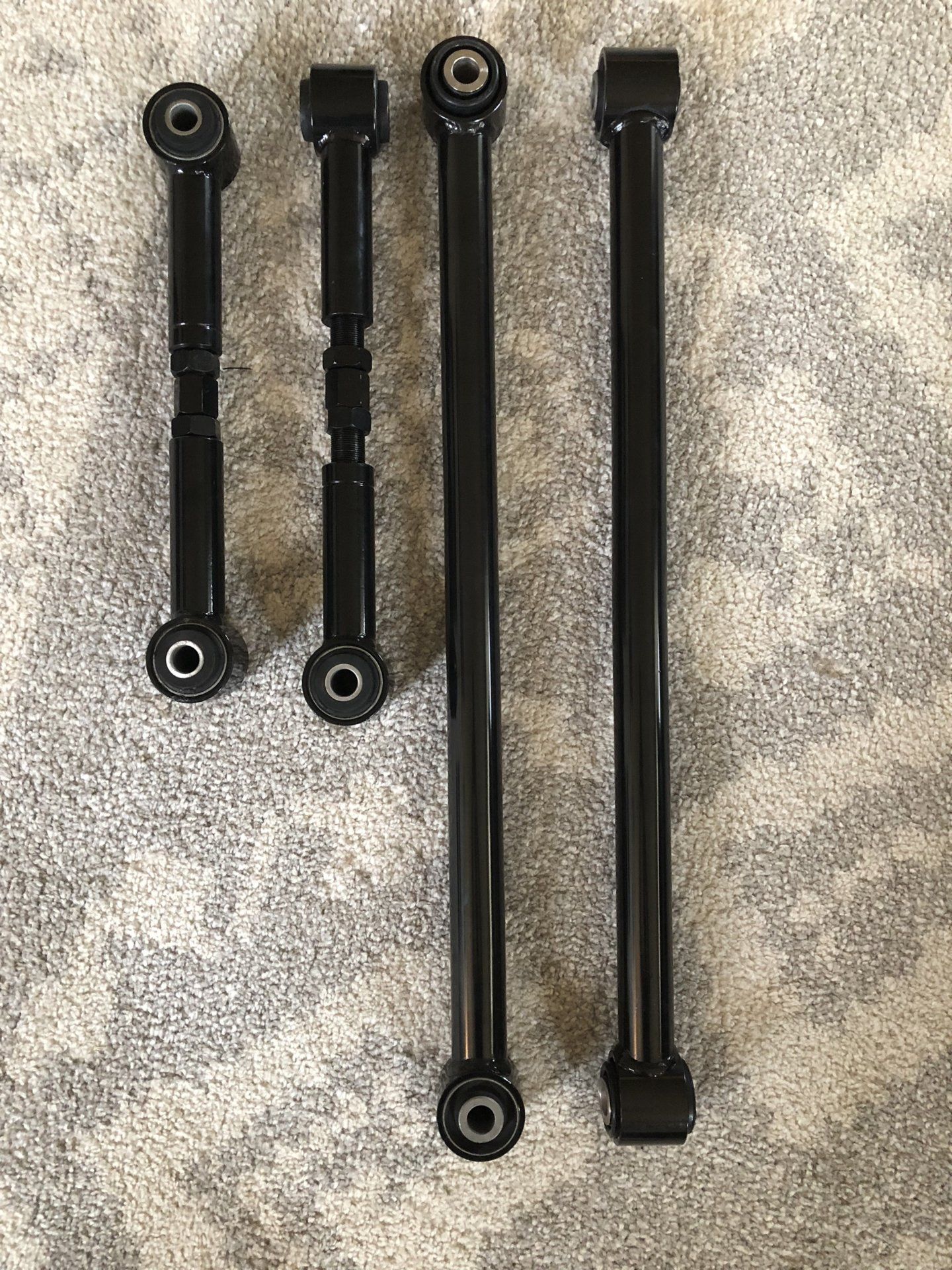

Things are starting to roll in for the rear driveline rebuild (see aforementioned rear t-case leak). I think the issues are stemming from a lack of maintenance of the rear suspension and driveshaft, I knew there were issues but I was just putting it off.
So let me explain what the plan is here:
  1. Replace T-case rear output bearing and seal
  2. Replace my spare rear driveshafts U-joints and swap with the barber poled one currently in service
  3. Replace the rear pinion seal
  4. Replace banana'd rear LCA's
    • New SPC arms are here, I am going to reinforce them with some L angle
  5. Replace worn out adjustable UCA's with new adjustable UCA's
Here are the L & UCA's

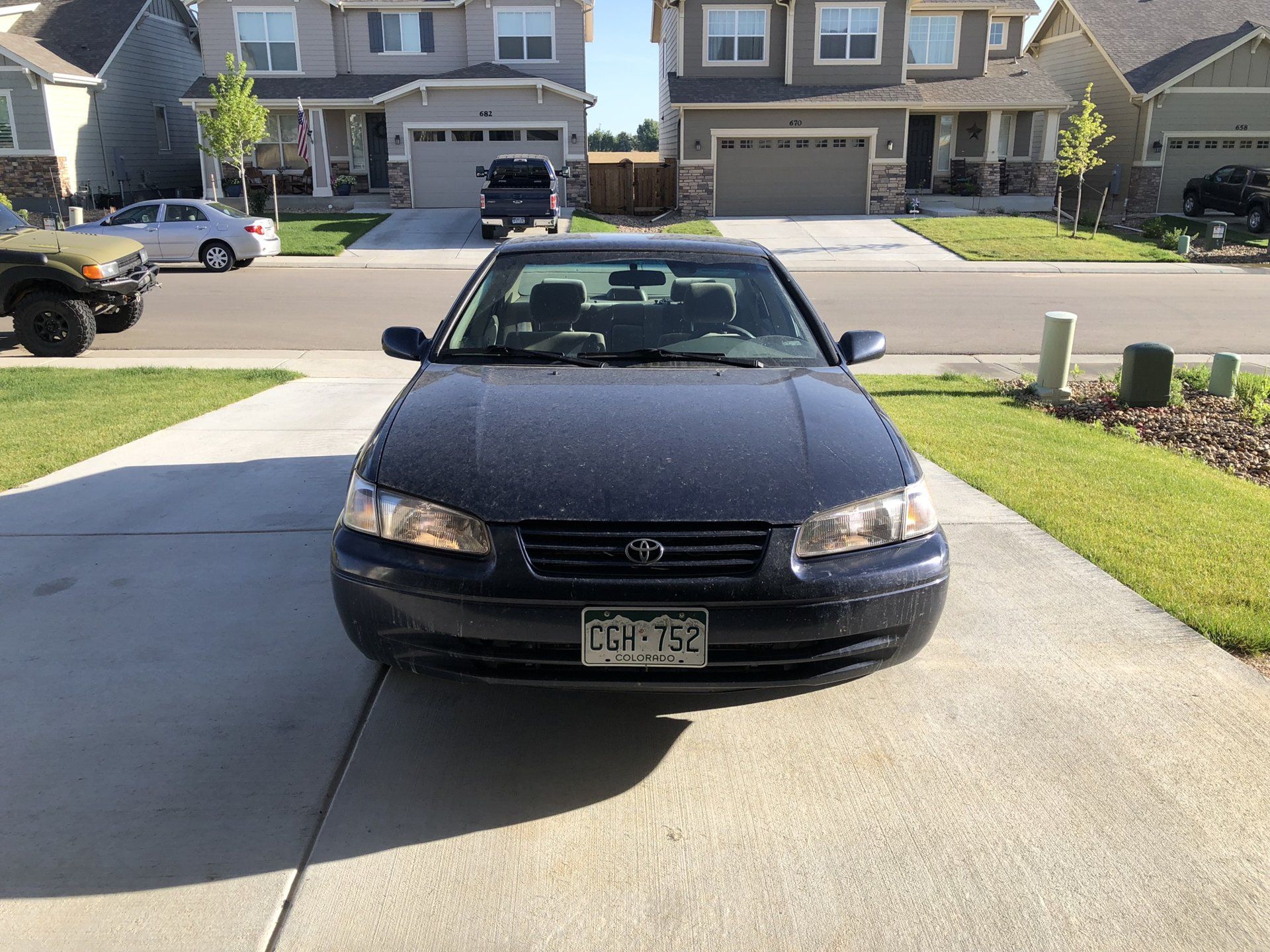

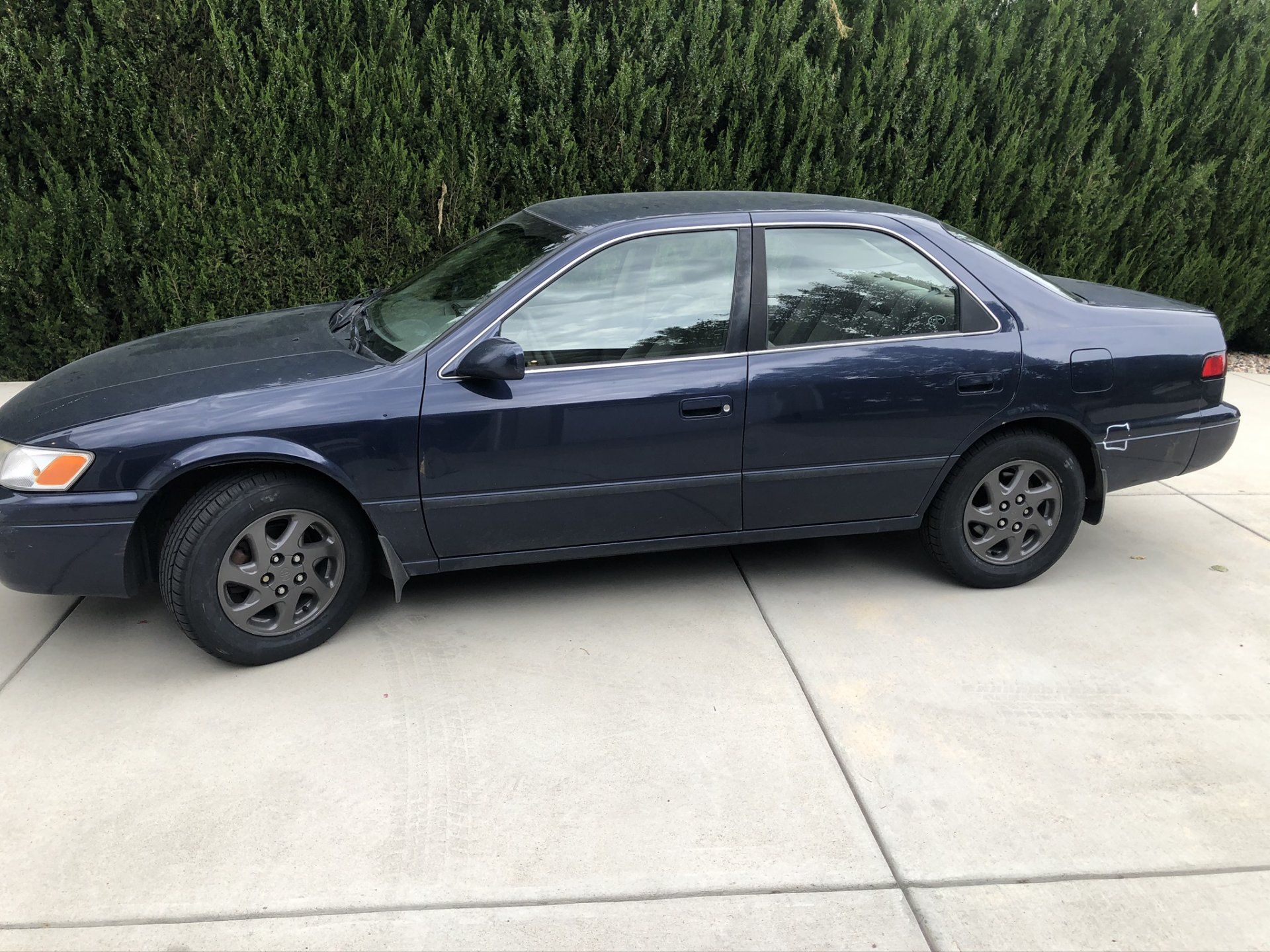

Also bought my friends old 1999 Camry V6 for $500.... Nothing is wrong with it mechanically just has hail damage and some dents, so now I've got 4 cars in the fleet!

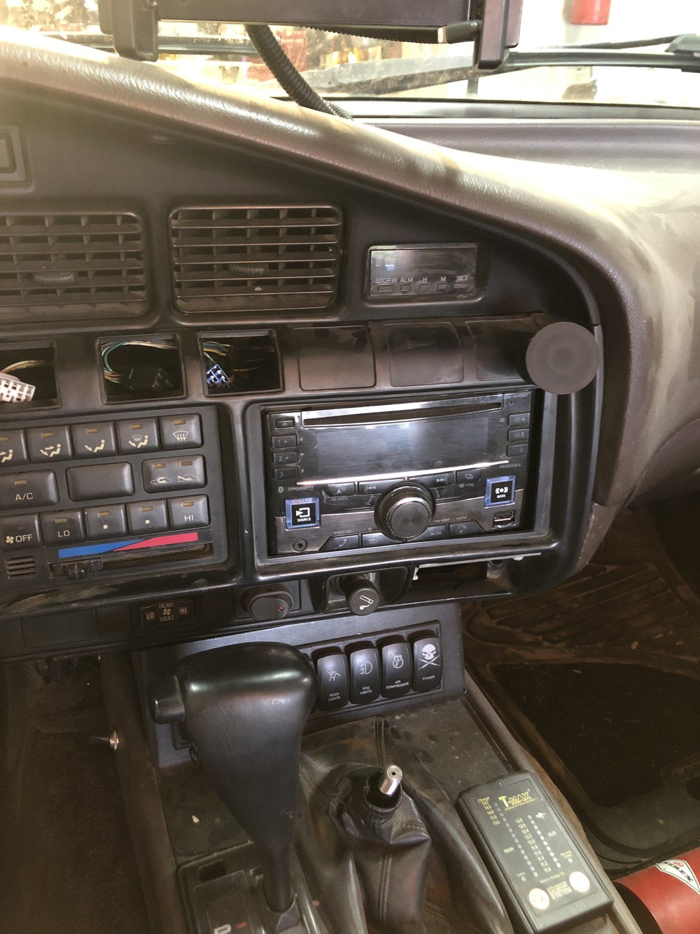

So the camry needs a blutooth stereo because I'm sick of listening to the radio... So naturally its getting the Alpine head unit hand-me-down from the land cruiser which means I have no choice but to upgrade to a kenwood 6.9" LCD head unit (DDX775BH Refurbished) with back up and forward facing high definition cameras.
Nice color scheme on your 80 and those dents are icing on the cake. :clap:

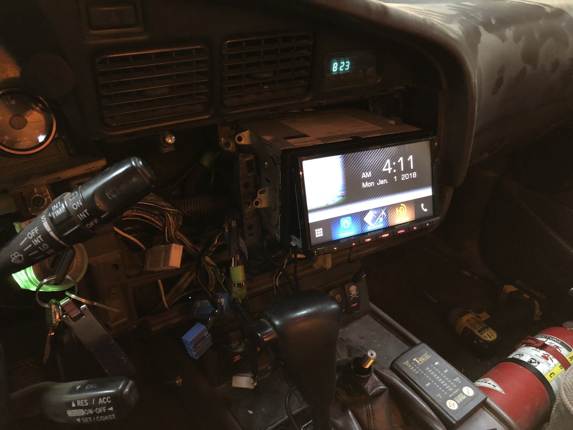

Started installing the new head unit, yea it's an older model but it was a good price and the largest screen availible.

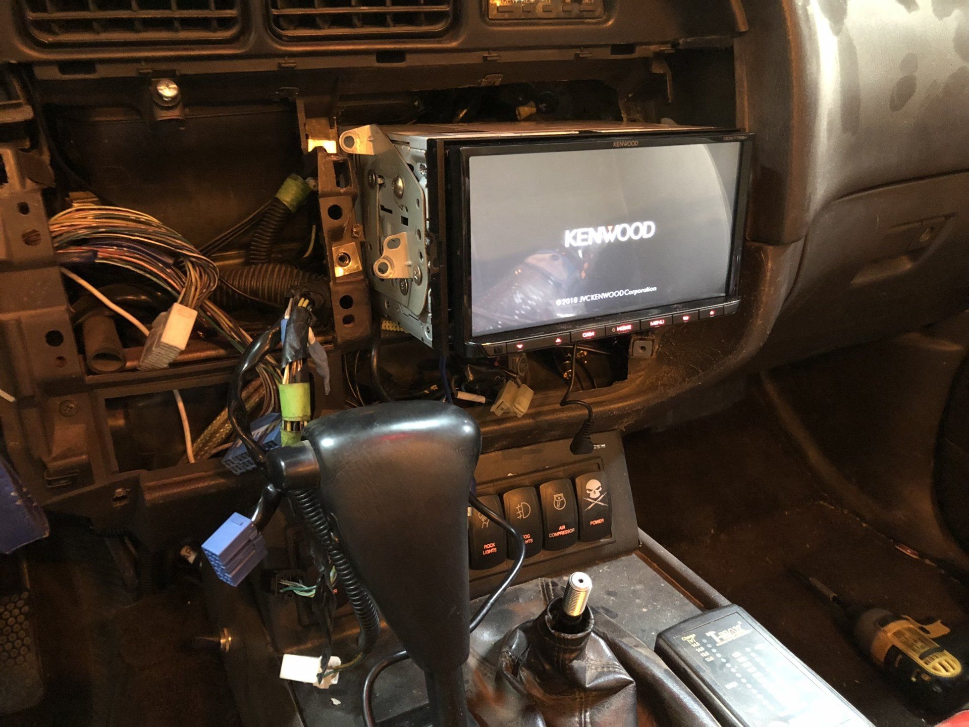

Got the cameras in too, tested them out and they are going to work well. Resolution is as expected, not HD but not lo-fi either.

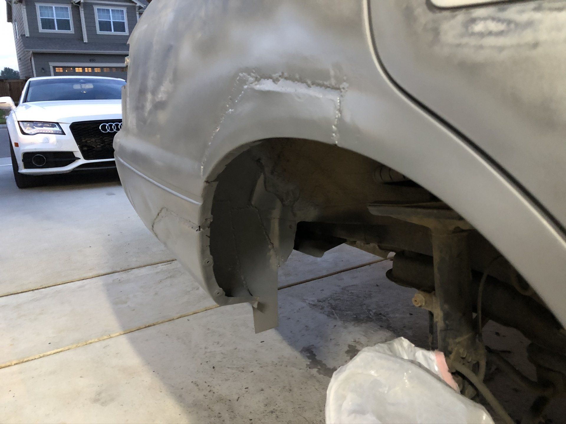

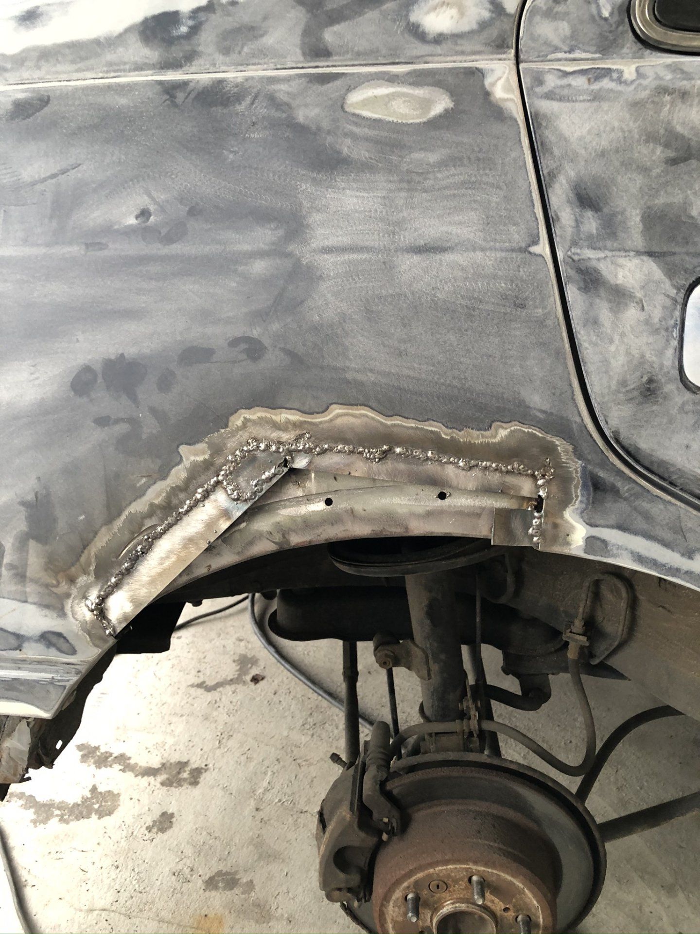

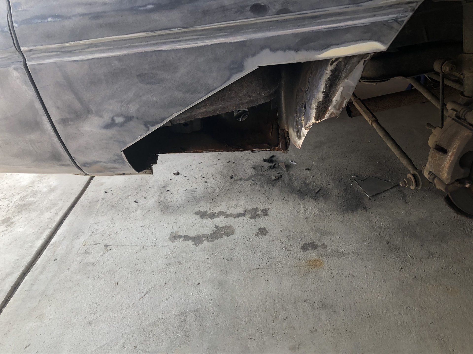

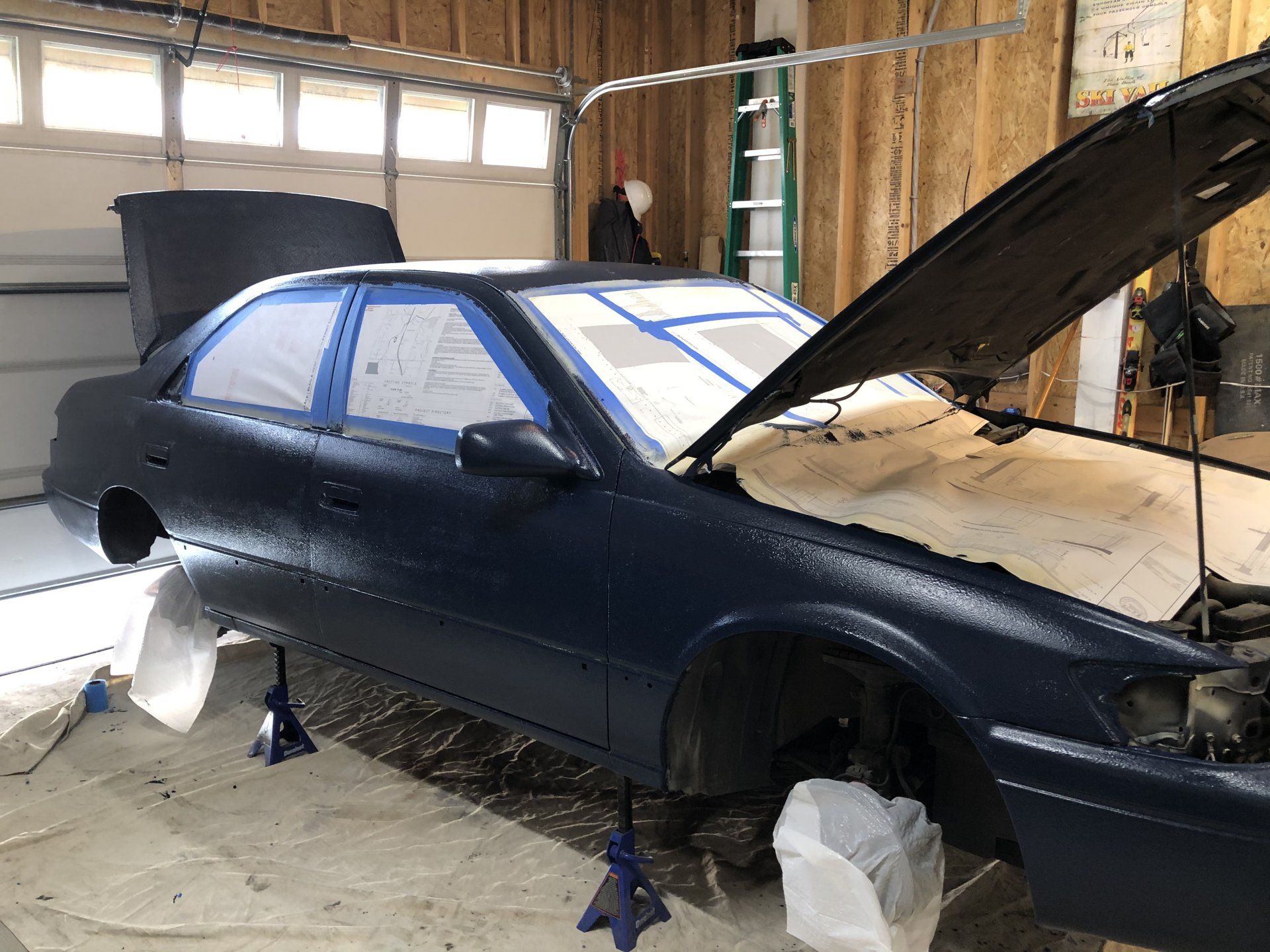

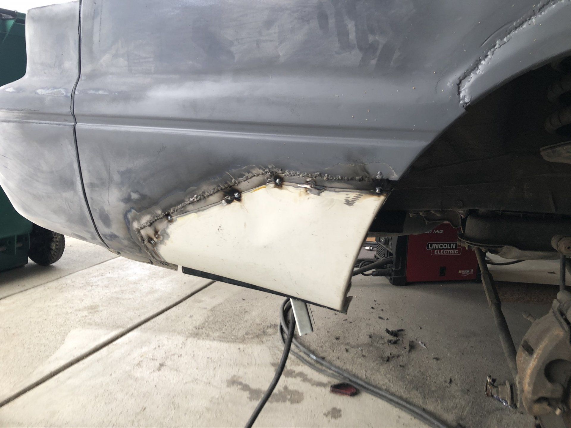

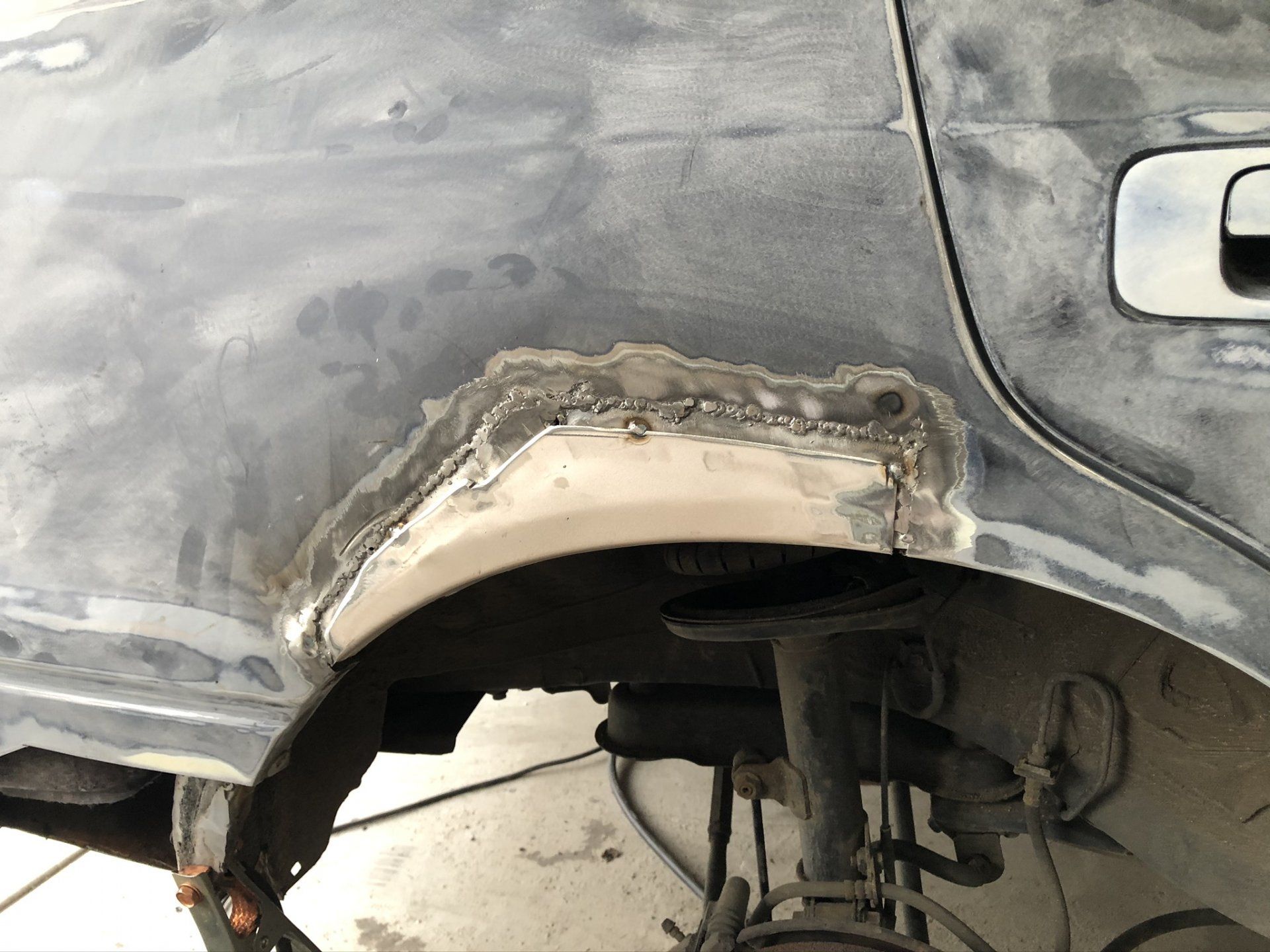

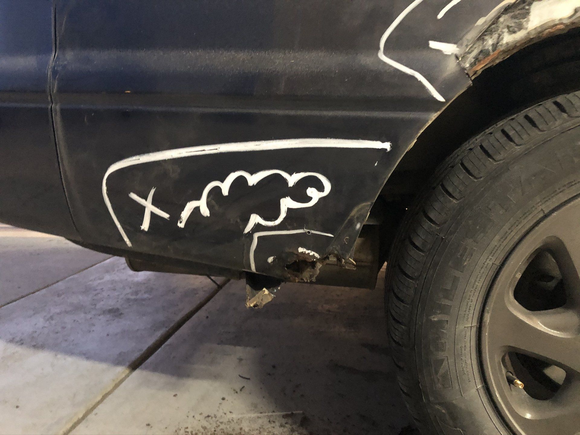

Well, I got drunk one night and went at the Camry with my grinder, cutting out all the rust I could find, when I woke up I realized there was no turning back. So I've made several trips to the junkyard to get donor body panels that I've been patching back onto Barry the Blue Cruiser. Now I'm working on the final paint prep and will be masking him up for his date with the monstaliner on Saturday. I'm going back with dark blue (midnight blue) monstaliner, then I'm going to tint the windows and that's that!
